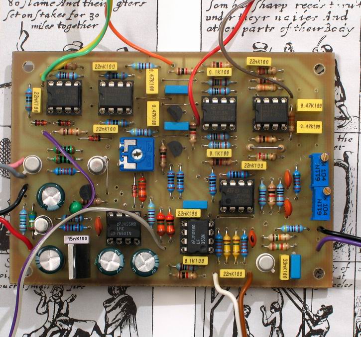

    With first PCB I had problems with parasitic oscillations, I solved problem with lots of small bypass caps but this is not an elegant solution. I do not recommend ANY of the above to be repeated. New discrimination mode also proved to be not a good idea.
    I'm working on new TSS+ board and it is almost finished. All workable mods will be optional.
    For what is it worth TSS+ is best pinpointing device I have seen, with small coil it is absolutely one of the best MDs for junk infested sites.

          No good PCB
          The 1st PCB in dxf of Leto have bugs !!
          1-The rx coil gnd
          2-The s. pin of Bf245 is connects !!!
          All metal is ok, no disc mode !!!

                Hi! I have finded mistake in 1st PCB too.
                The 4pin of LM393 c0nnect to 4pin of LF353 but not connect to "-"

                  Yes 1st PCB has several mistakes - sorry for that.
                  I had to cut some tracks and add 4 wires on copperside
                  again: I do not recommend ANY of the above to be repeated.
                  Now I'm going back to original Tesoro design - here is the remake.

                          I have used the file dxf (SS+.zip) of Leto.
                          I have corrected only small errors and it works very well. It is simple all it takes is cutting two steps (BF245-BF245 surce is conest, cut !!! and cut RX coil GND) and connect -5V LF393s and LM353 (pin4) and +5V LM393s (pin.
