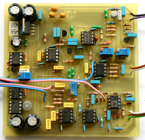

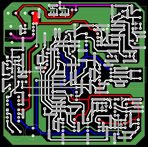

                          Silver Sabre X
                          Thanks for replies,
                          very helpfull insights...
                          About this SS project:
                          Its a Love&Hate relationship I developed with this detector...
                          I guess everyone who spended too much time with one single project knows What I'm talking about .
                          Here are the changes to the circuit and new parts:
                          • I decided to use Eldorado type oscillator..
                          • Input voltage regulator changed to L4902A (dual 5V)
                          • new are two paralleled MAX1682 voltage doublers for TX oscillator (with on/off switch)
                          • for each op-amp IC power supply two bypass capacitators were added
                          • potential divider for signal coming from Tx (stability issue..)
                          • phase reference network changed to Eldorado configuration
                          • optocoupler for/with 555 audio
                          • few other changes according to SS2 shematic & geotech..
                          Everything was tested with old PCB I made.
                          New one will be ready in folowing days..
                            what's that squeeking..??
                            Hi finally I'm back home,
                            the PCB was assembled and tested:
                            • power converter works ok, boosting detection up to 20%
                            • bypass caps (or maybe GND planes) made detector more quieter..
                            • discrimination tested with trimmers on board - working ok
                            • sound - bad - not well behaved, not good idea to use 555, at least with this circuit. Treshold pot almost uneffective
                            I'll play with this one for a while - changing values around 555, but will probably jump back to ICL7660 generated sound as in original.
                            Has someone tried 555 as sound stage in Tesoros? Any experiences?
                              I totally missed this thread so far!!???
                              Analog Tesoros became my favorites, means that i am very interested about this too. Very good work Leto!
                              Previous SS pcb you posted here is interested much!
                              I will make this ASAP.
                              Bravo! Good job! Excellent!
                              BTW thank you for posting pcb here...
