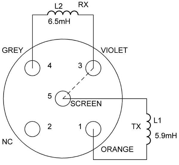

    What is the right way to wire up a tesoro coil
    I have orange grey purple green and 2bare wires the coil is a 5 pin widescan
    Here's the diagram ->
    The dotted screen connection is made inside the search head.
    Sometimes the colors are different. and I suspect your green wire is the same as the orange one below. Often there is a spare wire in the cable that is unused.

      for those who dont like pics
      white rx1
      green rx2
      bare (naked center wire)
      togehter with black tx2
      red tx1
        after i have disconnected the original plug from the coil cable i see what you mean
        the wires at the coil cable and the wires at the box plug have different wire colors
        so link it likes this
        coil wires to wires from connection at box
        grey to white
        nothing to black
        purple to green
        orange to red
        shield to shield (center bare wire)
        in the box i have connected black and shield if it makes sense or not ?- equal it works
        tested it because i removed original plug and replaced it with 5pin microphone plug/connector
        and it works

                          Hy i finished my tgsl edu black version from silverdog , i used a round concentic white original 5 pin coil
                          the proplem is, i get no deep only 5cm for 1 euro coin disc is working but not good.
                          the wires are grey,purple,blue,orange and two bare wires.
                          what is the right way to wire up this tesoro coil
                          please help
                          regards compadre
                          • #43
                            I believe this is correct, your 2 bare wires can be twisted together
                            I will be trying it myself tonight, time permitting
