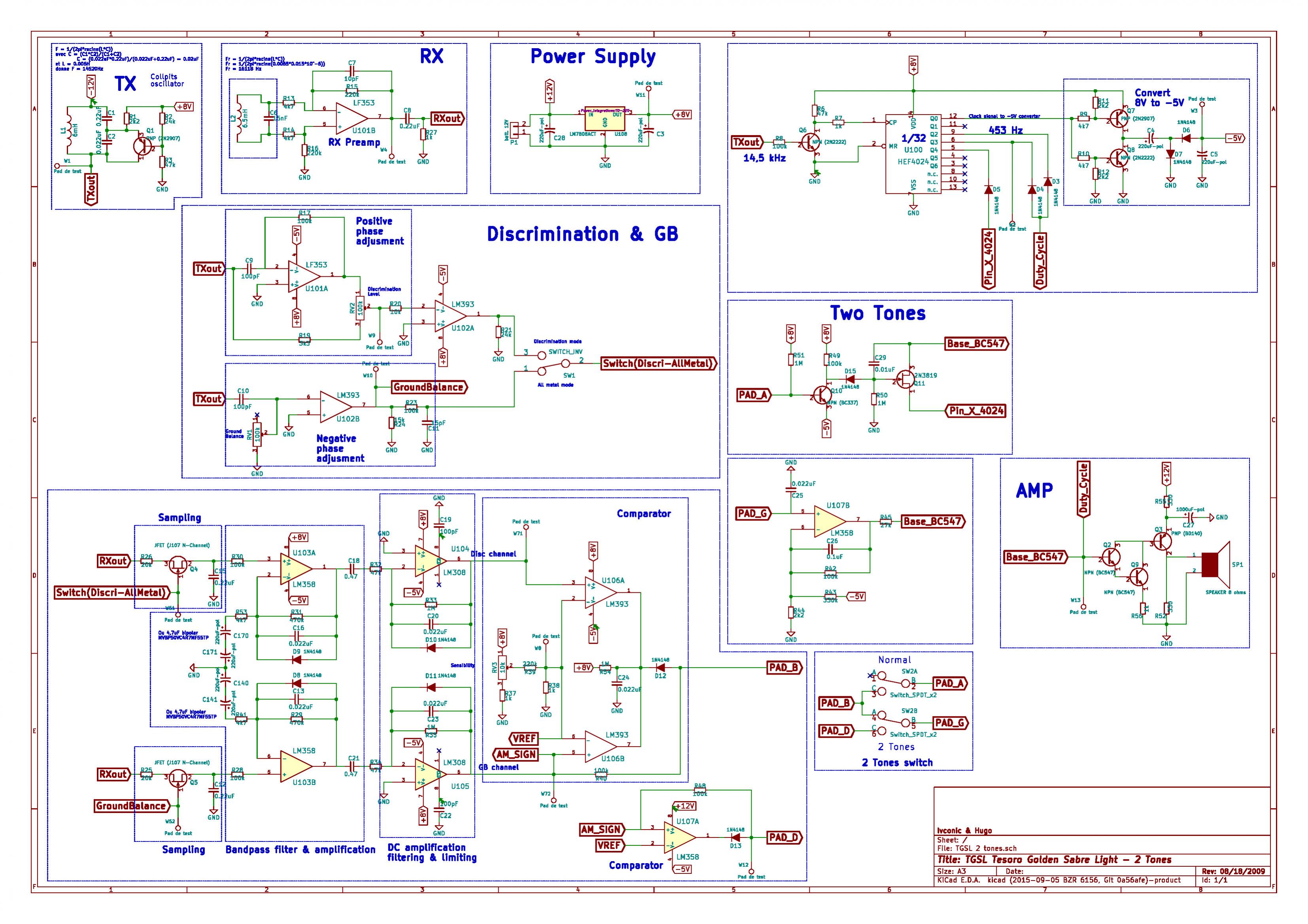

Welcome!Originally posted by Richlsdorfite View PostHi,
First of all, many thanks to Ivconic and Hugo for the schematics and all the R&D made.
As I use Kicad as my only electronic CAD sofware, I redraw all the schematics (TGSL and 2 tones mod).
So here the schematic of the TGSL including "2 tones" mod.
Would any of you be kind enough to check it ?
[ATTACH]33751[/ATTACH]

Salut,Originally posted by Richlsdorfite View PostHi,
Have you deleted on U7 pin 1: R6 (1M) and C2 (22n)?

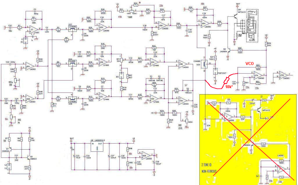

one russian did 2 tone in Classic much years ago by simple way. so I draw it for you. try to choice right value of additional resistor.Originally posted by eduardo1979 View PostHere you have a 2-tone scheme. I have tested and works perfectly. The only problem is that the hot rocks, are detected with a low tone, like iron.
Will try this oneOriginally posted by kt315 View Postone russian did 2 tone in Classic much years ago by simple way. so I draw it for you. try to choice right value of additional resistor.
[ATTACH]34331[/ATTACH]
