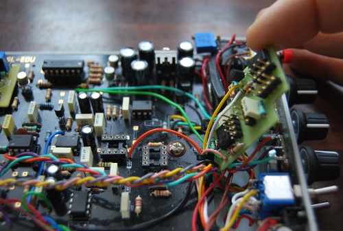

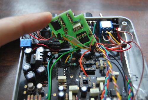

            As promised, here is two views of the add-on card.
            Hugo
            • #96
              Thanks Hugo,
              Pics does clear things up for me. I will post pics as well once mine gets wired up with the 2 tone board.

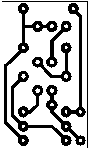

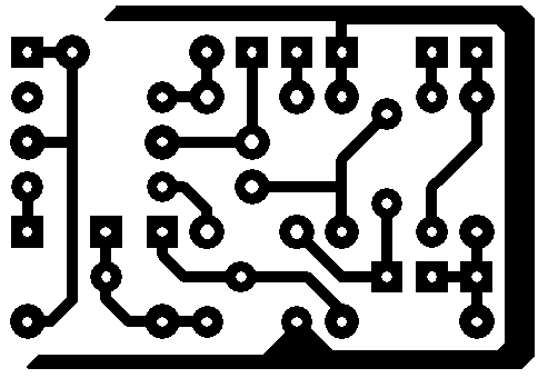

                          • @satdaveuk :
                            Please find herewith the layouts you requested.
                            Hugo
