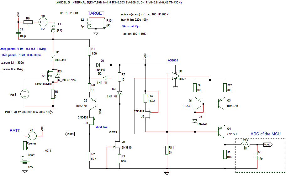

      Hi Teleno
      I like the way you set up the -5v regulator for the ATtiny84 and the ADC. I lack the knowledge to understand all of the workings of the receiver circuits. Maybe later when get your final design you could give us less talented a simplified explanation?
      Thank you,
      Chet
      Q2 is set up as a very low impedance, common-base amplifier. p-FET J4 maintains the collector of Q2 a fixed, controlled voltage relative to Vdd. Together they form a cascode configuration. Because there's no voltage swing at the collector of Q2, its output capacitance has no effect on the bandwidth. Instead, it's the output capacitance of J4 (which much lower - 2pF) and R2 what limits the speed of the response.
      n-FET J1 is a constant current sink. It fixes the base voltage of Q2 at a steady value relative to Vdd.
      Together with p-FET J4 it has the effect of attenuating any spurious variation of Vdd. With the values shown the attenuation is 52dB, or 1/400. For example, a 100mV ripple is translated into 250uV at the preamp's output.
      Temperature compensation of Q2 is provided by D3.
      The gain of the stage is a little under R2/R1, where R1 is the damping resistor.
      The collector current in Q2 should be chosen for the smallest Noise Figure usually specified for 100uA - 200uA for small signal transistors. Q2 could better be BC559 (low noise version of BC557).

              - D2 prevents the reverse Vbe voltage to go beyond -0.7 V. Higher values can degrade the transistor mddle term, values above -5V will pemanently damage it.
              - R15/D1 limit the current in Q2 during flyback to 20mA.
              - After flyback, D1 is closed and the coil current (target current) flows through Q2 and J4 into R2, causing direct amplification.

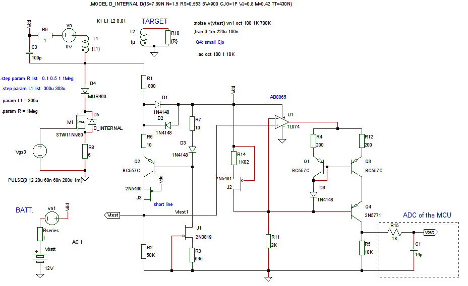

                      • I would welcome suggestions on how to interface the amplifier with the MCU's ADC.
                        For a 12V supply:
                        - The preamp's output is 6V - 7V and is passed on to the OpAmp non-inverting input.
                        - The OpAmp's output can swing between 3.8V - 8.2V = 4.4V (AD8610) and passed on to the ADC of the MCU.
                        - The MCU is powered at 5V.
                        So the problem is to adapt the 3.8V - 8.2V of to OpAmp to the 0V - 5V of the MCU.
                        One solution is to create a floating digital ground at about 7V for the MCU. But then the maximum swing at the ADC input would be 7V - 8.2V = 1.2V instead of the 5V that could be achieved.
                        Another solution is a a floating digital ground at 3V and a regulated rail at 8V. Then the OpAmp's output can cover most of the ADC input range.
                        Finally, a rail-to-rail JFET OpAmp can be used that's as least as fast as the AD8610 (List here). Then a simple LM78L05 regulator would power the MCU.
                        (P.S. AD8065 for $5 looks good- 7nV noise. AD8033 is $5 but 11nV noise. AD8067 is $6 with 6.6nV noise and 640uV/s slew rate. All in SMD packages only).
                        As a last resort the OpAmp can be scrapped and a discrete second stage be used (see my first version of the amplifier) in which case we're also served with an LM7805.

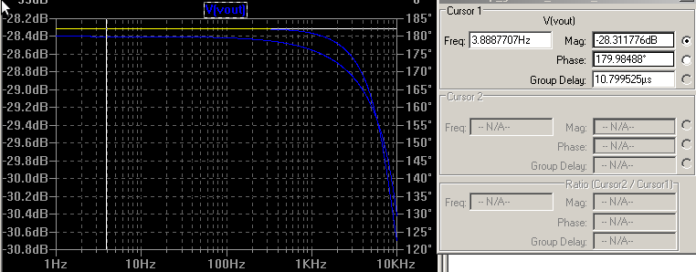

                              You're right, the digital ground and the OpAmp input are not referenced to -Vbatt while the signal at R2 is.
                              To remedy these issues the voltage divider is scrapped and I'm using a current source on R11. This the Thevenin equivalent of a steady voltage source in series with R11. It determines the baseline of the output vout.
                              The digital ground referenced to +Vbatt is also scrapped, this new version uses -Vbatt as the common ground to all circuits.
                              The role of the JFET OpAmp in the new design is no longer to provide a gain block, but buffering (gain close to 1) and voltage-to-current conversion. This lowers the speed requirements for the OpAmp since extremely high slew rates are no longer necessary. Common ICs such as TL071 or LF357 can be used with little or no speed penalty compared to AD8610.
                              Gain is achieved by a current mirror at the OpAmp output which also provides referencing to -Vbatt to isolate the output from power ripples.
                              AC analysis of a reference signal Vn1 riding on battery voltage:
                              The premp stage has a PSRR of -52 dB, but then the second stage amplifies everything it gets by the ratio R5/R11 and the PSRR at the output is just -28 dB.

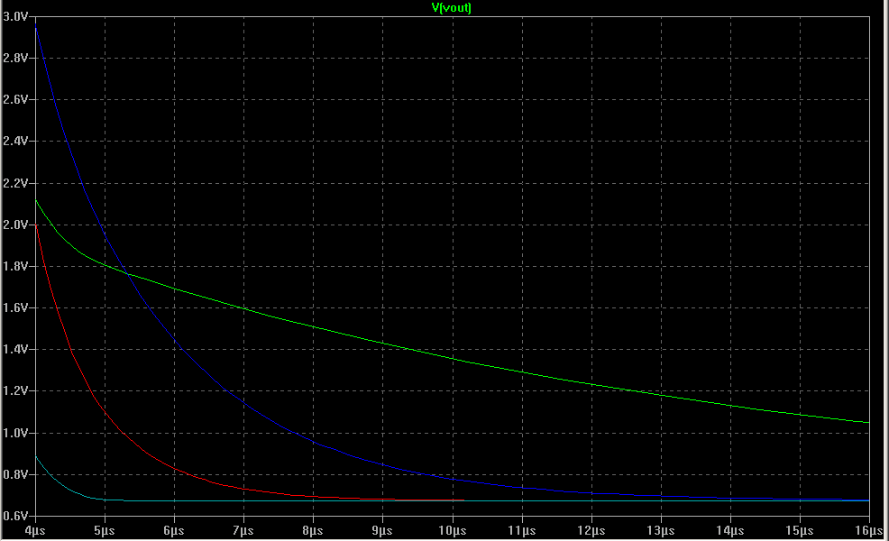

                              The next modification would be to apply Moody's variable damping circuit so that the input resistor is high during most of the transient but then drops to about 500 ohms at the end. This has the benefits of faster decay (larger S/N ration) and lower noise and the drawback of a sensitive adjustment that would have to be performed by the MCU.
                              The output seen by the ADC sampler should look like this:
                              • I think current sourced/sinks J1/R13 ahd J2/R14 should be replaced by shunt bandgap references (LM337/LM317) to achieve maximum ripple rejection. Other ideas?
