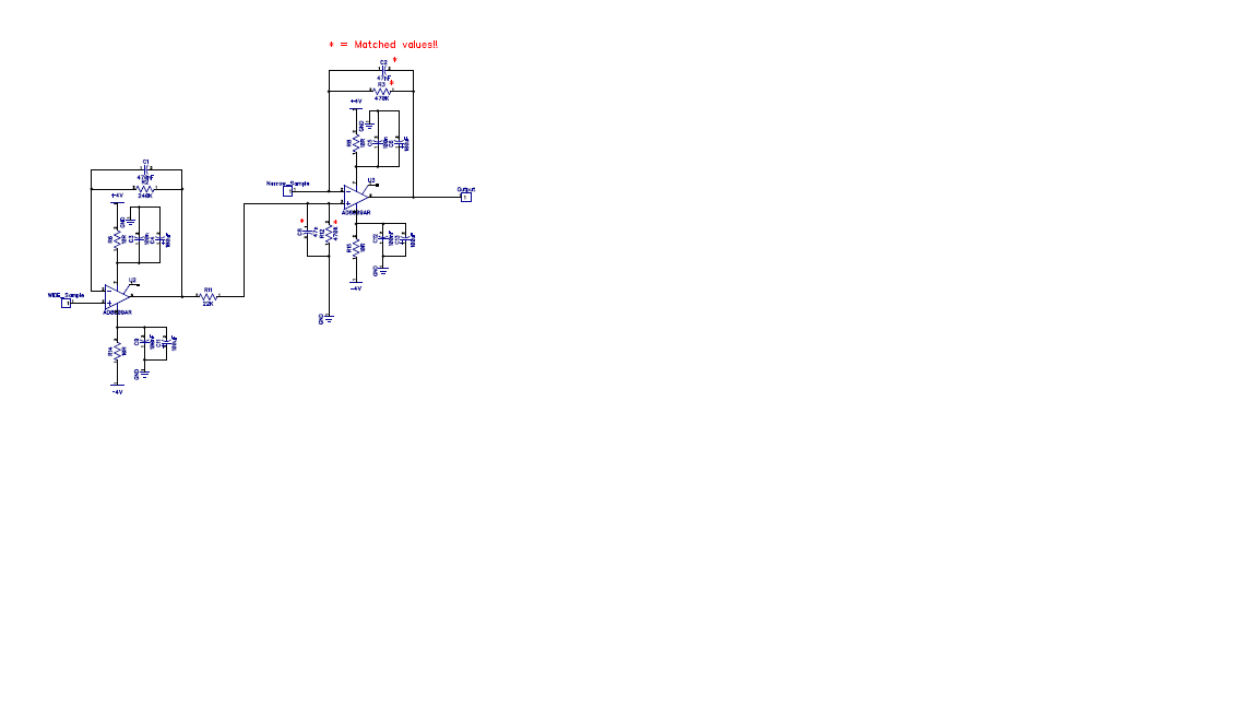

            Sean any chance you could repost a larger schematic please, when you zoom in to read values the picture pixelates

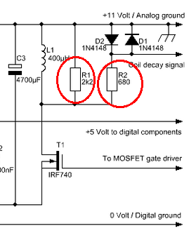

              Now back to the noise. Have we identified where it is coming from?
              Mainly fron this:
              The hgher the resistance, the higher the noise (increase follows a root square law)

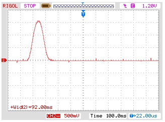

                  Monolith had some good questions about noise in reply #39. To start leave the coil stationary(no EF signal). Target signal probably less than 10 Hz. Including a scope trace of integrator out sweeping a US nickel across the coil. The bottom width varied from 100 to 200 milliseconds sweeping the coin at speeds I thought would simulate sweeping the coil. The PI post amplifier circuits I've looked at roll of at 10Hz or less. Think we need to look at post amplifier out when looking for microvolt noise at the coil. Still trying to answer some of Monolith"s questions.
                  This looks like a perfect target response. No noise visible.
                  Now, if we could compare this signal with the signal at extreme distance from the coil, we would see where the signal disappears into the noise.
                  What are the frequencies included in that noise? The frequencies will give us hints of where the noise comes from.
                  By the way, I like to hang my target on a string from the ceiling. The target swinging like a pendulum past the coil gives the near equivalent of a steady sweep speed. A target in the hand is strongly influenced by the response signal of the hand itself.
                  The "standard" sweep speed for de-mining, is 1m/second. We use this as a very approximate standard as the ideal sweep speed is also related to the coil diameter.
                  Considering a time lag of 100ms from the peak target detection to the audible signal, would be a distance of 10cm. Spelled out, this means we hear the indication of the target when the center of the coil is 10 centimeters (4") past the target. Still OK for pin-pointing with a 30cm diameter coil.
                  A large time lag makes pin-pointing very difficult.

                    I will do that this evening. Sorry about the size of the drawing, I'll have to redraw it as I didn't save the original *face-palm*. Values are largely irrelevant at this stage and will need tweaking.
                    Regarding the noise Teleno, can we activley damp the coil and will this help reduce it? I know another manufacturer cites avalanche noise from the FET as a problem which is why they use a snubber. Also those front end diodes look like a nice noise source too, can we eliminate those, maybe by actively switching out the high voltage portion of the Rx signal, and only switching through a voltage which will not either saturate the front end amp and is low enough to process directly.
                    I think the stage which can take the high voltages, like a common, base arrangement (nice low input capacitance) suggested earlier, along with active dampling and only switching the required section of the signal through to the front end amp is the way to go. Unless anyone has any better ideas, can we pursue this line of design please?

                      Having a standard test method is a great idea. If we standardized pendulum length, swing width, and targets that would help a lot. Also a standard test coil is pretty much a necessity. Any thoughts on how we could accomplish this and what the standards should be?
                      • #56
                        Suggestion, pendulum length 2 meters, swing width .45 meters(.9 p-p), US nickel, 200mm coil. Someone to check my math. Ability to adjust target height above coil. Record(scope trace)of post amplifier out at target distance,(1xcoil radius)(2xcoil radius)(3xcoil radius)(4xcoil radius). Compare target signal with noise level. Maybe a 50mmx50mm piece of aluminum can for a target(easier to get for everyone)
