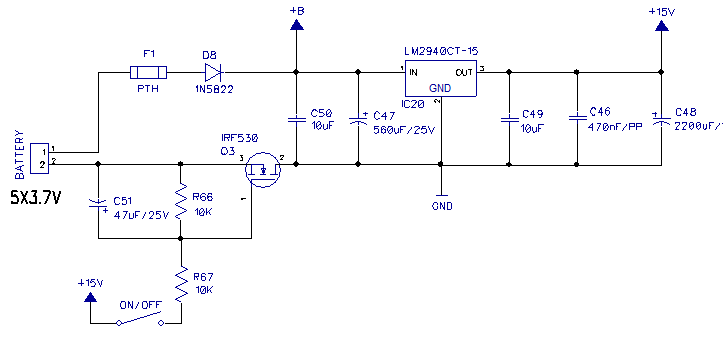

            These designs had a problem with the inrush current, because there was no inrush current limiting. Under certain conditions this could blow the mosfet gate.
              Here's what I use. It adds some delay and also doesn't produce sparks when you switch on.
              Plus overcurrent and reverse battery protection the lazy way.
                Wouldn't the ON/OFF switch need to connect to +B to turn on Q3 since +15 is zero when Q3 is off?
                  You are right. I have blown some mosfet“s...
                    It took me some time to notice the problem, as I was using mosfets with zener gate protection which were quite immune.
