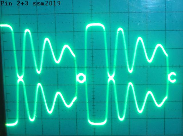

    Changed it to 100 ohms and it looks better now, not too sure.. the voltage peak is 250V now.
      It is OK to regulate the Flyback voltage with the resistor. The important thing is to avoid avalanching the Mosfet or overvoltage of the parts, capacitor and resistors. Avoid Wirewound resistors when possible.

        The mosfet is rated 650V and unrestricted went all the way up to 800V. I did not expect to see high heat build up (probably arround 50C) on the flyback control resistor (let's call it that).

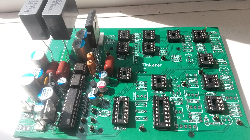

        I'm using the default timings 600PPS with 100uS TX provided by you. Some parts are kept tall as I want to be able to desolder them to be re-used as this build is more of a proof of concept test board where things will be swapped/desoldered and possibly destroyed
        I took note and added copper pour can be connected to GND with J1 so I can actually see if/what improvement it gives. Also you will notice audio connector which can be connected to 2nd board with alternative audio solution possibly AD654 based.
          I like your board. Also the test point loops.

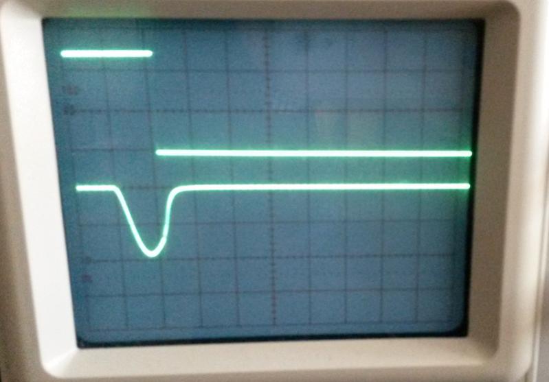

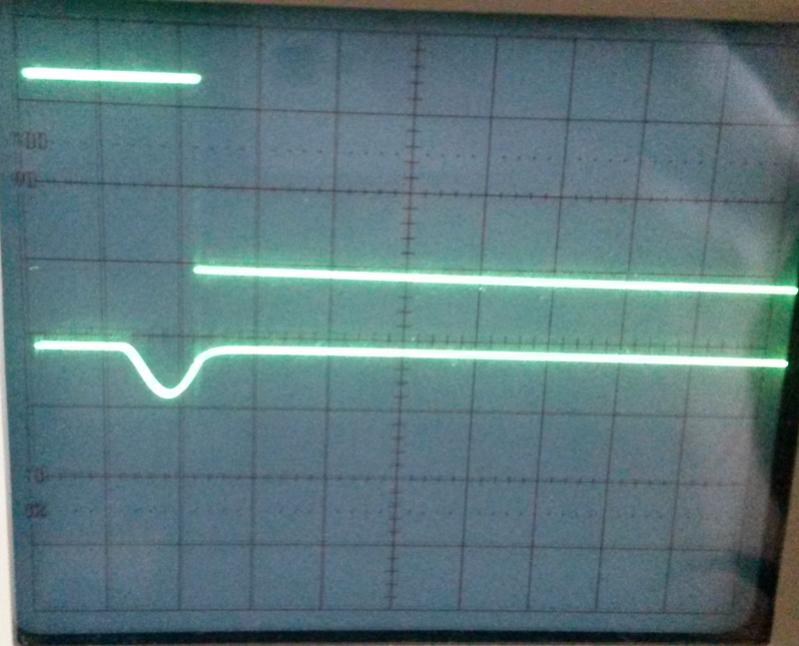

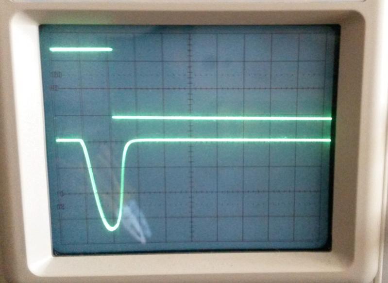

              I hooked up test DD coil and here's few shots from the preamp out and TX. Signal looks quite different from the references I've seen.
              I got no response change for before TX reaches 50uS (~50%TX ON) and goes to about 20uS-40uS after TX OFF.
              Response to small targets like gold ring and silver coin is very low.
              Scope is set to 50mV/DIV for both channels (TX is 1:100, preamp is 1:10) and 50uS/DIV.
              Default signal (no traget)
                Did you adjust the coil coupling?
                  I've done adjustments by trial-and-error with the scope and this is currently the only way I've found it actually (somewhat) works, don't know if there's a better way.
                  I don't use the bucking coil and the wire is plain 0.56 enamelled wire because I didn't want to waste the litz wire before I know little more.
                    It is OK to use any kind of wire, but you must use the bucking coil for this design, otherwise your sensitivity will be very low.
                    the output of the preamp looks different, because this is not a traditional PI design. At the time I was designing and testing hundreds of different ways of making an induction balanced pulse induction metal detector. Most of the designs were innovative in some aspect or other.

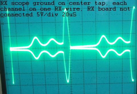

                            Hi waltr, was looking at your scope traces and was confused until I noticed the scope trace goes right to left instead of left to right.
                            • #44

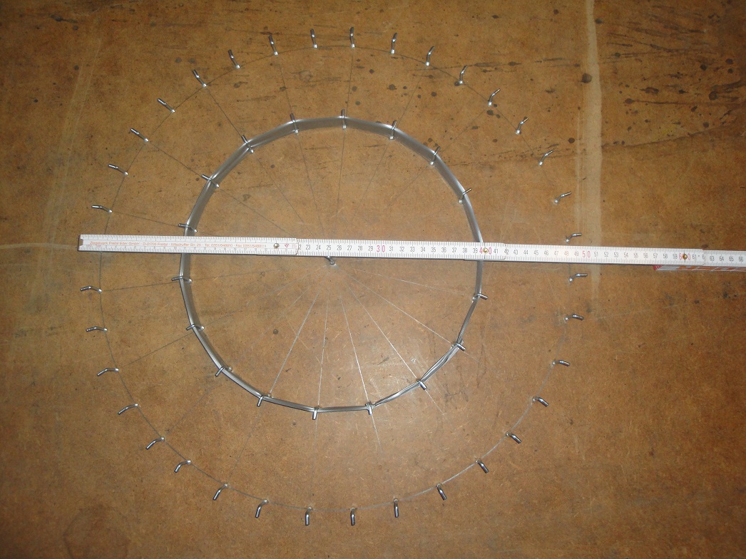

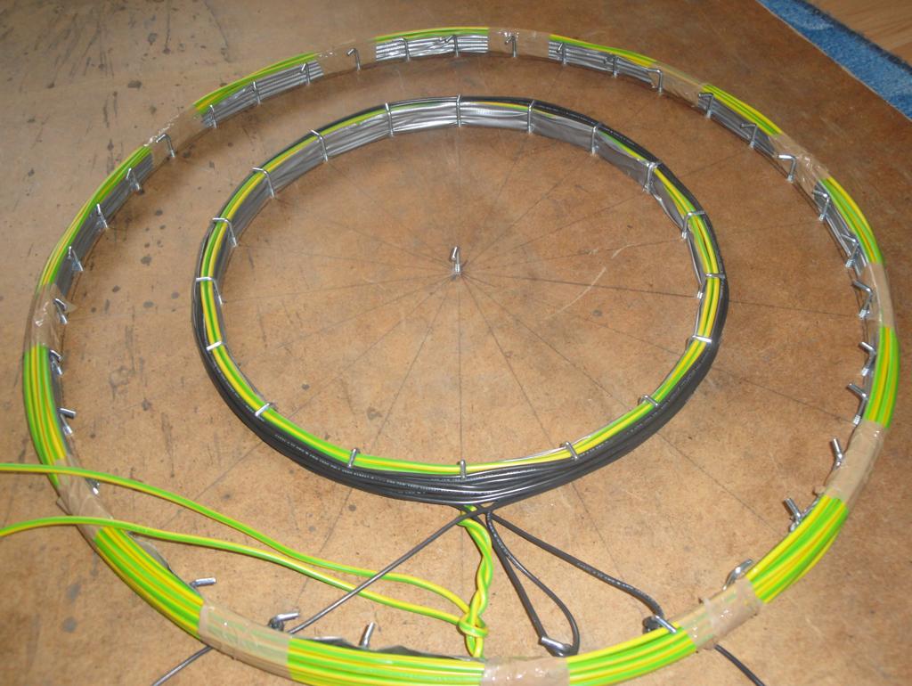

                              Here are some pictures of my experiments. But it it some time ago. These are with a big (50 cm) IB coil. Center taped RX.

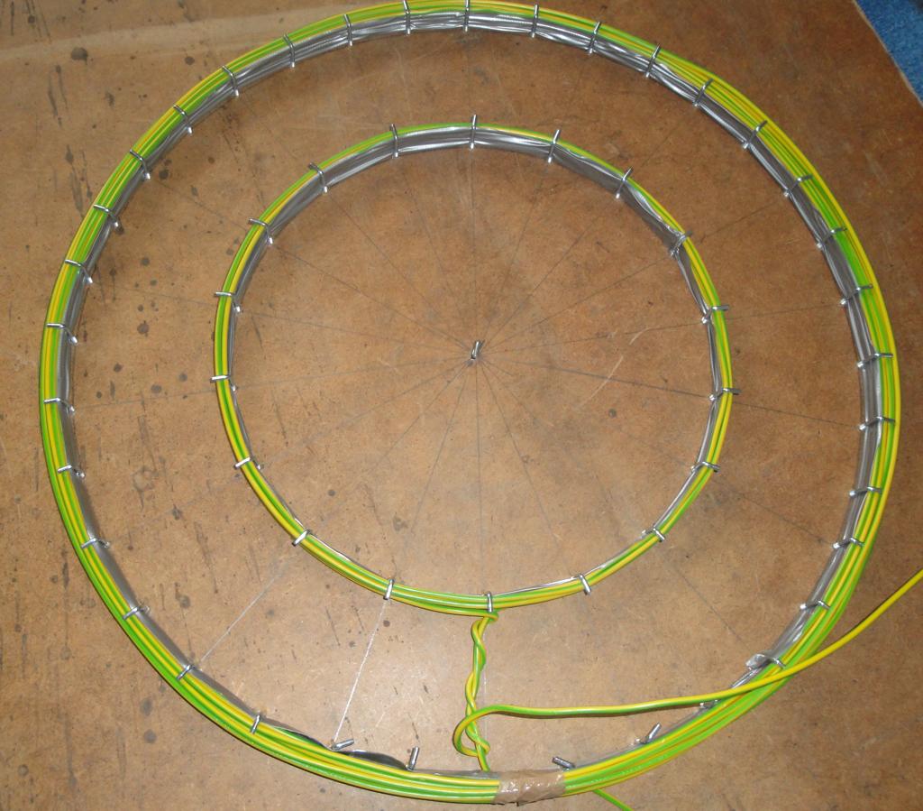

                              • #45
                                Here are some pictures of the coil...
