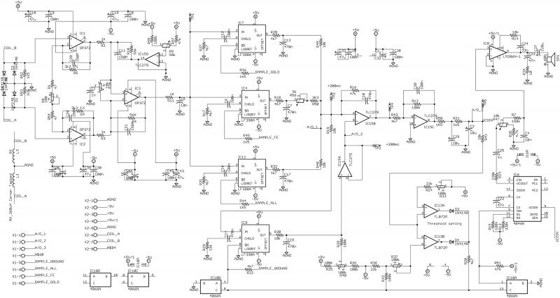

    Here is the RX and analog signal processing of the discriminating IB-PI.
    It has been tested on the breadboard and gives good sensitivity and discrimination.
    There are many things that can still be improved. I would love to hear constructive comments and suggestions.
    Remember, this is an "OPEN SOURCE PROJECT". Anybody is free to copy, build, improve or distribute it. Its final quality will depend on the input from intelligent people from all over the world.

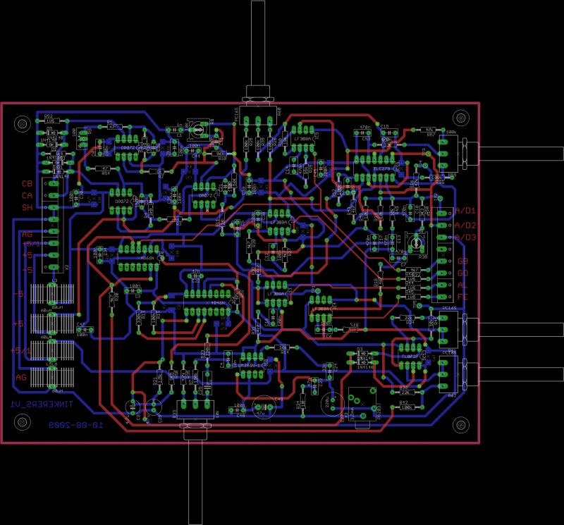

    I am working now on the PCB layout.

    Hello tinkerer,
    Please can you upload a better resolution of the schematic for experiment and contribute at the project
    Thank you very much
    Alexis.

      Hello Tinkerer,
      I wish to construct this myself to see how it performs, but the schematic diagram is of low resolution (only 53KB) and I am unable to read the component values etc. when printed.
      Is it possible for you to post another image please?
      One which will fill a full A4 page when printed will be good, although I am able to convert the image to monochrome myself, if necessary.

        Hi Alexismex
        attached are the EAGLE files in ZIP. I hope it works.

          TINKERERS_V1_SIGNAL PROCESSING PCB
          Here is the TINKERERS_V1 signal processing board.
          Tinkerer
            TINKERER_V1 DISCRIMINATING PI PCB
            Here are the EAGLE files of the TINKERERS_V1 SIGNAL PROCESSING BOARD.

                  Hi Tinkerer, I've been looking at building the signal processing section to use on my frontend, anyway I have a couple of questions because I'm not sure about the timing setup.
                  With the 3rd sample is it sampling the total receive period between TX pulses ?
                  With the ground balance sample and hold, does it have the same duration as the 3rd sample ?

                    Hi Mick,
                    it has been some time since I worked on this project, so I need to revisit and try to remember how everything functions and what the purpose of each section is.
                    What do you use for the timing?
                    How is your TX?
                    What kind of coil do you use?
                    The Tinkerers is for IB coils. Ideally the samples should be easy to move around, earlier or later, to enhance certain features or attenuate other features.
                    For example, if you are searching for specific targets, you want to enhance the response of such kind of targets.
                    Now, if your site is littered with lots of rusty fragments of sardine cans or bottle tops, you want to enhance the discrimination of these targets so that you waste less time on digging.

                        Is your UNIPI working? if it is, it would be better to use that for the timing.
                        You can start with the following sample sequence and see how it works out. It depends a lot on the coil configuration.
                        The sample gold, is about 5us after TX switch ON, about 10us sample time.
                        The sample FE is also about 10us duration, just before TX switch ON.
                        The sample ALL, is about 15us after switch OFF, the same 10us duration.
                        The sample GB is taken about 15us after switch OFF, 20us duration. This sample samples the sum of the other 3 samples.
                        On the sample FE there is a pot, to scale the sample. You can put pots on all 3 samples to give more possibility to enhance or attenuate the signal of any of the samples.

                            If you show me an oscilloscope picture with the complete cycle RX signal wave form, I can help you adjust the sample timing for best discrimination results.
