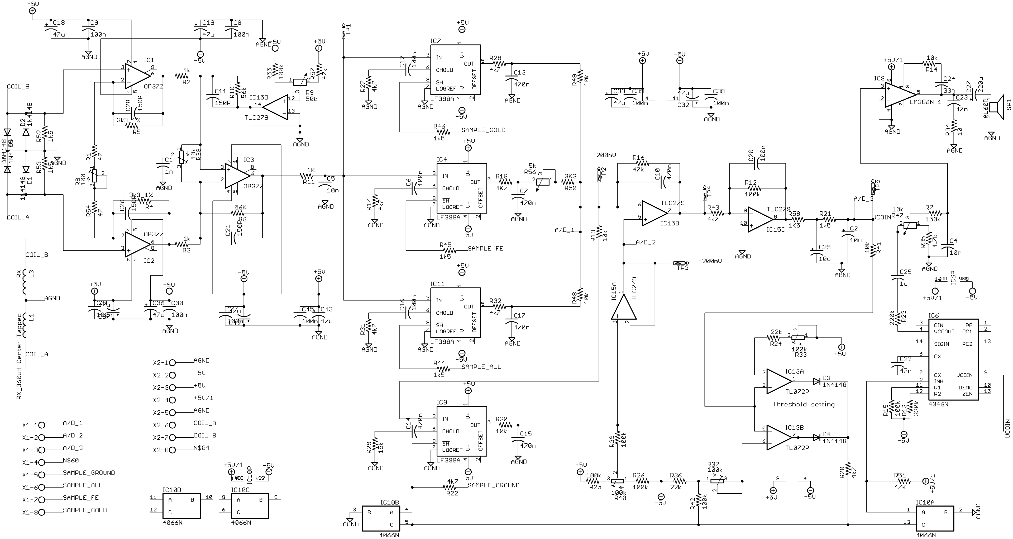

      I am looking to improve discrimination using the LF398.thank you
        I seem to remember using the NE5537 sample and hold as an integrator, comparing a long integrated and a short integrated signal.

Name:	TINKERERS_SIGNAL PROCESSING_09-26-2009.png
              Check this one. Is it better? I dont think it is the final version as I see some mistakes. I found the drive where they are on, but the Designspark EDA does not seem to open the files anymore. It looks as if I used 4 samples. An induction balanced coil, using a bucking coil. The timing was probably done with a microprocessor.
              Tell me if you want to proceed.
