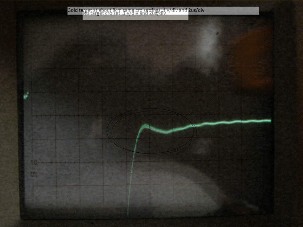

            Here's some pictures of no target and target, sorry for the poor quality again. Both shots are at .1volt/div and 2us/div. at about 8cm tried to take a photo at 10cm distance from target but the picture quality is too poor to pick up the difference but I can see it.

                Excellent.
                Now, there is some oscillation on the wave form.
                Is this an artifact of the coil winding, or does this show that the coil is slightly under damped?
                If you take a wide sample that covers several oscillations on this wave form, it will average the oscillations.
                If you are looking on a specific spot, yo need to sample only that spot, that is a narrow sample.
                Have you tried the crown cork?
                Tinkerer
                  Sorry I should have mentioned the oscillation is being caused by the powersupply I'm using, normally I run the circuit from battery but it was flat when those shots were taken. I haven't tried a crown cork yet but some more target testing will be happening shortly.
                  The main thing I was going to try and tie down first was ground response and mineralisation reduction. The area I want to test at has a high level of mineralisation, it would be good to see If I can make it's operation as quite as possible.
                  Mick
                    Mick
                    I believe that the ground response is mostly due to iron. Therefore, if you can discriminate FE (iron) then it should help with the ground response.
                      Don't be so sure
                      A little bit of scaling, some distortion correction to get all the grid perfect. Followed by some colour filtering for signal distintion and you get the following. White for no target, green for gold nugget. Actually knowing where to look you can just make it out the un-altered shots but this technique makes it really clear.

                          Originally posted by Midas View Post
                          Don't be so sure
                          Hi Midas, did you use photoshop for that ?
                          Mick
                            Mick
                            I sure did. But if you want an infinitely cheaper option then Gimp would probably be able to do similar things.

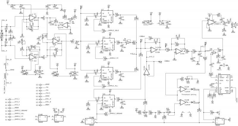

                              Here is the RX and analog signal processing of the discriminating IB-PI.
                              It has been tested on the breadboard and gives good sensitivity and discrimination.
                              There are many things that can still be improved. I would love to hear constructive comments and suggestions.
                              Remember, this is an "OPEN SOURCE PROJECT". Anybody is free to copy, build, improve or distribute it. Its final quality will depend on the input from intelligent people from all over the world.
                              I am working now on the PCB layout.
                              Then comes the field testing.
                              Tinkerer
