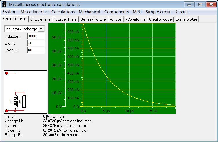

        Attached is a picture of a decay curve of a 5TC target. It is close to the numbers I used above.
        Yes, it is micro volts and nano amps we are talking about.

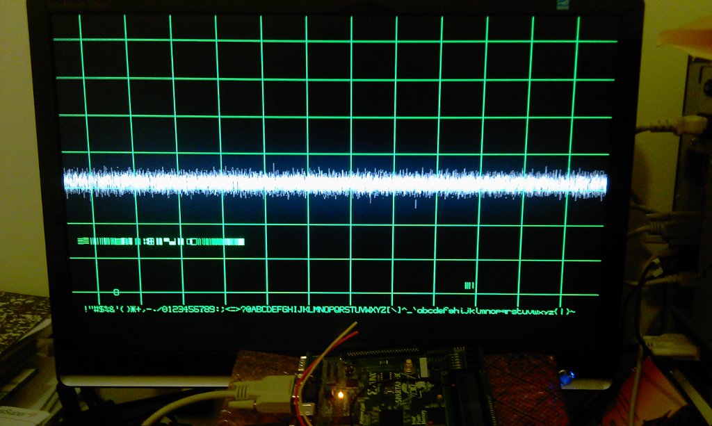

              PI backend inbuilt scope .... working
              After a few hours of coding ... the scope for the PI backend is working.
              Not bad for a couple of hundred lines of VHDL code and not a single CPU cycle used on the CPU. Currently the design is utilising 40% of the FPGA resources. ( cpu, ram, memory controller, flash controller, vga display, ADC capture, serial port )
              The display shown is VGA 800x600 with independant control of waveform, grid and text. The CPU can access both text and waveform memory.
              The waveform is stored in dual port ram so that it may be simultaneously stored / displayed independant of CPU access to waveform RAM .... very cool.
              The wave form ram can store up to 300 Megasamples / sec if required however in this case we are running at 1 msps. ( ie 1 horizontal pixel = 1 uS ) not to be confused with the horizontal VGA rate which is running at 20 nS per pixel. Thus a full unscaled waveform on the screen is 800uS of sample time.
              The waveform storage length is 2k words of RAM but can make much bigger if required. The FPGA board is at the lower front of the screen.
              The sensitivity is about 5 uV per pixel and the trace here is noise picked up by 10 cm of wire connected to channel A of the ADC.

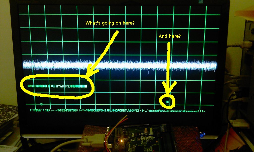

                Very interesting!
                But what are the extra symbols shown below?
                  Very interesting!

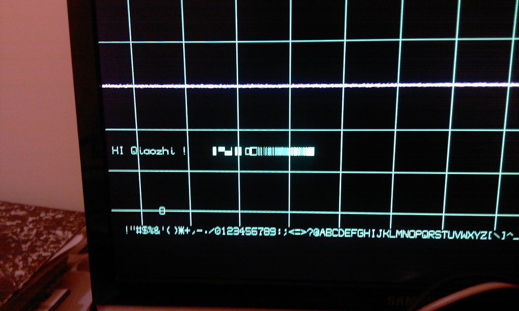

                  One of the cool things about FPGAs ( well most of them anyway ) is that you can set what is in the ram when you first fire it up ... unlike most Microprocessor ccts. Those characters are the extended 'block' graphics and are loaded into the ram image that the FGPA fires up with ... mainly because there is no room on the bottom row of chars and also to prove you can write to other lines. The purpose of the characters is to test the Video character rom and display ram is working. The CPU has access to the display ram but currently does nothing as it has only a boot loader and I have not yet written a program to control the PI backend.
                  The key to FPGA development is to get 'hardware design' ( ie VHDL ) then write application much as you would for conventional microcontroller system. I am offloading all the waveform display work to VHDL logic so CPU will not be tied up.
                  Moodz
