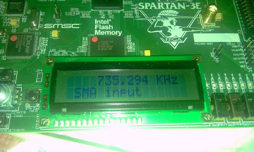

                    Just a quick update ... the ADC front end is now dual channel however only one display on the screen. The front end will be used in differential mode for robust noise immunity and increased sensitivity. I am going to stick with the 14 bit ADCs for the moment and see how they go with the Tinkerer front end and the Moodz differential ZPI.
                    The Spartan 3E board packs a digitally programmable gain amp ahead of the ADC and the code for this is working nicely after some initial problems ( data clock for gain settings too fast )
                    Here is the so called 'bit' file.[ATTACH]11606[/ATTACH] This is the image file that programs the FPGA. ( not a source code !! ) For those people with a Digilent Spartan 3E 500 Starter Kit and Impact programming software you will be able to load up the board and see the PIScope in action by plugging a VGA monitor to the VGA port and the boot loader for the PlasmaMIPs CPU on the 1st serial port .. 115.2 Kbit/sec required. Note this is a proof of concept ... still more stuff to do ... the scope really works and the bootloader too.
                    Next I will get the rotary encoder / LCD and TX waveform generator .... now where did I put those m******b pulse timings ....
                    Moodz

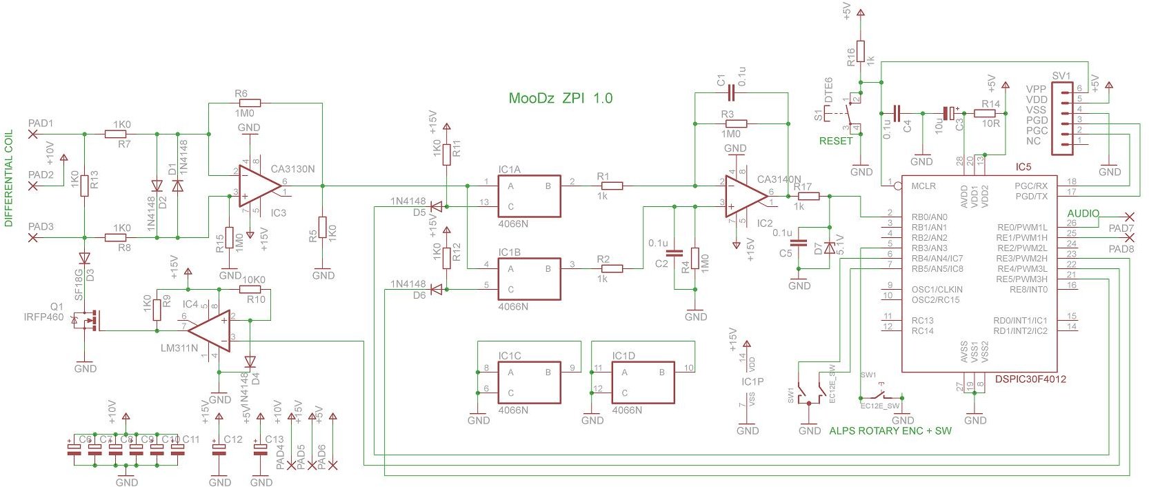

                    Moodz,
                    great job.
                    do you have a last version the Moodz differential ZPI? I would like to build it and do some tests.
                    Tinkerer
                      Moodz,
                      great job.
                      Tinkerer
                      [IMG]file:///tmp/moz-screenshot-1.png[/IMG]
                      Hi Tinkerer ... the ZPI01 is the latest version but I will be throwing everything away past the clamping diodes and replace with PISCOPE backend. The coil is the essential part of the ZPI.

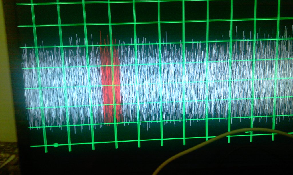

                      I have added waveform highlight functionality to the scope display. The width and position and color are settable by the CPU .....
                      and what is a scope without a frequency counter .... Added one in to achieve two things .... first the LCD is now working but not talking to main PLASMIP cpu yet ( soon ) and two .. the frequency counter is very handy for snooping all the timings inside the FPGA . The frequency counter is good to nearly 300 Mhz at 1 Hz accuracy.
                      use code like this clk <= lcd_frequency;
                      which is HDL for "connect the clock signal to the input of the frequency counter".
                      Good thing I did this as the ADC was only sampling at 735.294 Khz as shown in Photo and it should have been more like 1.8 Msps x 2 14 bit samples ( there is an SMA connector but I did not change the text ).
                      Moodz

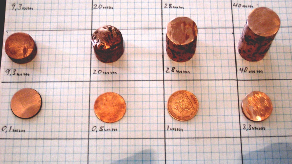

                        Manipulating the TX pulse
                        Thickness response test March 17, 2010
                        The purpose of the test is to see if a certain method of TX, can increase the response of thicker targets.
                        With traditional PI technology, the TX pulse generates mostly skin eddy currents in the target.
                        This works great with thin targets, like foil, that give maximum response for maximum surface exposed to the magnetic field of the coil.
                        Manipulating the TX pulses and multiple sampling can change the way a target responds, or the way we perceive it.
                        Parameters:
                        The coil diameter is 440mm, the coil itself is not shielded, but a disk shield nearly of the same diameter of the coil is placed below and above the coil.
                        The coil cable is 2 meters of 8 solid AWG 22 wires with a metalized polyester foil shield
                        Target distance above the coil…………………………….60mm
                        Total signal amplification……………….gain 45. This corresponds to a signal amplitude at the input of the preamp of about 44uV for the 0.1mm target and a signal amplitude of about 1mV for the largest target.
                        Pulses per second……………………………..1470
                        Samples taken………………………..3
                        Time of the samples taken at………6uS, 16uS, 42uS after TX switch OFF
                        Duration of the samples…………..8uS
                        The targets are approached to the center of the coil, on the end of a wooden stick, 60cm long.
                        The targets consist of copper disks with a diameter of about 20mm and of thickness varying from 0.1mm, 0.5mm, 1mm, 3.3mm, 9.2mm, 20mm, 28mm, 40mm.
                        The target with about 0.1mm thickness is only barely detected with 2mV signal. It is cut out of a single side PCB board.
                        Target signal response:
                        0.1mm ) = 2mV
                        0.5mm ) =20mV
                          Parameters:
                          Q. is the shield highly conductive and very thin ?
                          COMMENT : that is quite high.
                          COMMENT : your coil is very fast ? ... you first sample at 6uS.
                          0.1mm ) = 2mV
                          0.5mm ) =20mV
                          1mm ) =10mV
                          3.3mm ) =14mV
                          9.3mm )=20mV
                          20mm )=25mV
                          28mm )=35mV
                          40mm)=45mV
                          All targets together, with distance between the targets as shown in photo, placed over the center of the coil 150mV.
                          The last test response, with all the samples together, is the biggest surprise.
                          It would be interesting to see comparative tests made with different detectors.
                          Tinkerer

                                progress report
                                After some time off for the easter holidays here ... more code bashing on the TMPI ( tinkerer / moodz PI ) is getting somewhere.
                                The differential ADC capture is now fully functional with a 3.5 pF input capacitance.
                                The GPX4500 has 5 input channels .... the TMPI has 512 channels. The gain of each channel can be varied digitally from 1 to 100 or blanked. The output "flatness" at max gain of 100 across all channels is 4.7 uVolts. Each channel is the digital equivalent of the conventional sample and hold / demod / integrator found in conventional PI circuitry.
                                Input is dual differential ( ie two ADCs ) and the TX drive can also drive differential switching. The interface will work with Mono, IB, Differential Coils.
                                All channels are simultaneously available for processing thanks to Xilinx dual port RAM blocks in the FPGA. ( ie you can read AND write the ram at the same address at the same time )
                                The noise output of each channel at max gain / input grounded is better than 3 uV
                                The default TX / RX window is 512 uS.
                                The TX pulse is stored in a small RAM block in the FPGA and is locked to the RX waveform sampler. This means that any duty cycle / pulse repetition waveform can be generated by loading the RAM with a TX 'Pattern' . The input channels sample across the TX flyback and RX windows. The default clock for the TX / RX sync is 100Mhz ... 10 ns resolution. Each ADC channel aquisition time is a minimum of 67 nS.
                                Things to do ... build the tinkerer front end. Code the menu etc ...
