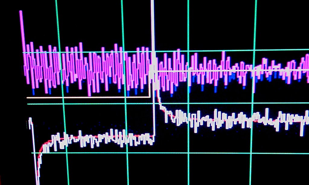

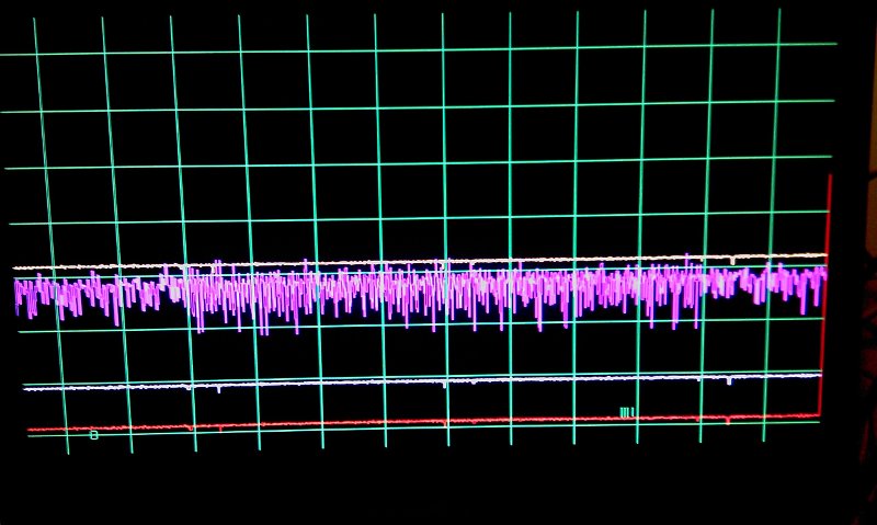

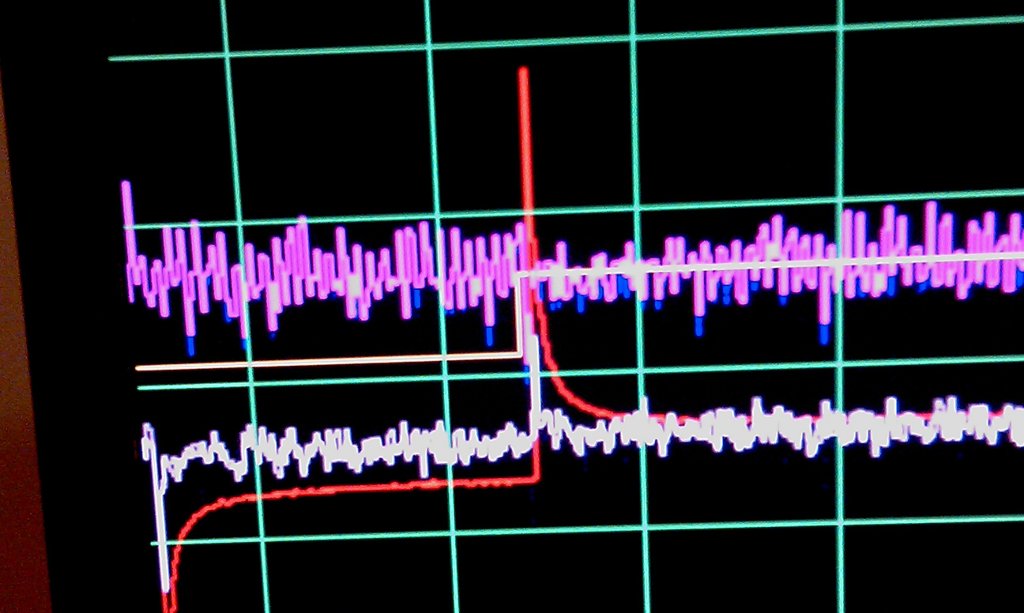

          .. progress report
          ... adding the first filter bank for ground balance .... below are traces from the built in scope funtion showing the TX pulse ( yellow ) the input signal ( purple ) the target signal ( white ) and the reference ( red ) I have demonstrated a target showing how the target signal white moves away from the red reference. Note how the digital filters have extracted the clean reference ( red ) from a very noisy input .... cant even see it on the input signal ( purple )... that is one smokin filter even if I say so myself.
          The input signal is depends to some degree on the TX pulse, the target signal is derived from the input signal and so on.
          The red reference is the equivalent of sampling with a 28 bit ADC ... moodz filter function .. and to think I hated maths at school.
          This milestone shows a number of things ....
          1. all four channels are working correctly on the built in scope function
          2. sync lock is rock solid
          3. the filters work better than I expected.
          ... also posted in my New differential thread ... he he ....
          The significance of this step is that the first balance channel has been created ... there will probably be more than one ...
          Ground balance channel.

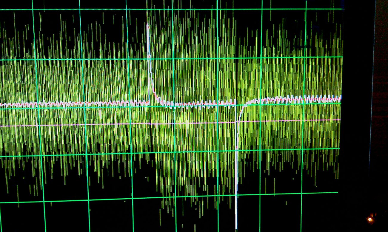

              FPGA progress EMI reduction
              ... EMI ingress is a problem with some coil types depending on build quality and efficiency of shielding .... Had bit of a problem with the front end ADC missing a bit on one of the channels due to a subtle logic errror ... however all fixed now
              Below is a screen shot of the output of the FPGA engine showing rather extreme EMI ingress on a single ended sheilded 22 cm monocoil.
              The yellow trace is the unfiltered input.
              The white trace is the output of the first filter stage
              and the red trace just visible under the white trace is the output of filter stage 2.
              The pink horizontal line is the other input for differential coils ( not used on mono coils of course. )
              The Tx pulse is bipolar and the scale is approx 0.3 mV / division.
              Because the ADC is so sensitive no external frontend amplification is used ( only active flyback protection ) The resolution is approximately 4.7 uVolt / pixel on screen.
              Homework questions ...
              What is the maximum amplification that can be applied to the frontend ? What is the procedure for finding this maximum gain ?
              Moodz.
                How much amplification? As your scope shot shows, there is a lot of noise entering through the coil. The more we amplify this noise together with the signal, the more noise we will have to filter out later.
                One way to better the S/N, is to produce a signal of greater amplitude. This depends a lot on the TX. The way the target is excited. This is why I have started a new thread here,
                NEW TX METHODS.. http://www.geotech1.com/forums/showthread.php?t=16580
                But, how much amplification?
                The preamp has it's limitations. When it saturates, the amplification is too much. If the signal saturates at one spot in time, it will take a considerable time to come out of saturation and the signal is distorted. Distortion in the target signal obliterates some of the information contained in the signal.
                Different opamps behave differently in this respect.
                How to define the limits for he maximum preamp gain?
                This is where the dynamic range comes into play. The preamp should not saturate under the usual working conditions. This includes ground response and large targets. The maximum size of targets is the designers decision.
                At the same time, the amplification needs to be enough so that the smallest target that the MD is designed for, can be detected. On the small end, the S/N plays a heavy role. Of course, the filtering capability defines the minimum S/N relationship.
                Tinkerer
                  working out the maximum gain for a digital system.
                  1. terminate the input amplifier in with its characteristic input impedance.
                  2. note NOB level for ADC ... minimum noise input that will cause the ADC to output the next binary level eg if ADC output is 000000000 then the next term is 000000001 ...or ....
                  3. Crank gain on input amp till NOB level goes up one.
                  Of course the hardest thing is setting the input impedance correctly .... most assume it is purely resistive which for very sensitive inputs may not be.
                  moodz.
