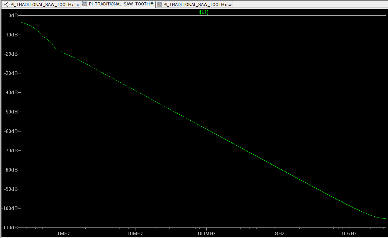

Here is the PI_TRADITIONAL switch OFF transient FFT
DEEPER PI DETECTION DEPTH

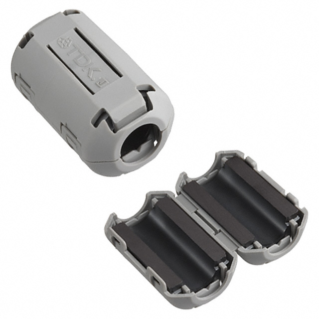

Instead of real toroid you may break it in half and use as a "snap-on" ferrite for cables RFI. Of course, it will be prudent to check if snap-ons are any good by themselves because they are dirt cheap and come with a handy enclosure too. At the very moment I'm laboratory-challenged, so I can't test it myselfOriginally posted by WM6 View PostIf you do not like toroid, you can use ferrite pot too.
Davor, thanks for idea. I will try.Originally posted by Davor View PostInstead of real toroid you may break it in half and use as a "snap-on" ferrite for cables RFI. Of course, it will be prudent to check if snap-ons are any good by themselves because they are dirt cheap and come with a handy enclosure too. At the very moment I'm laboratory-challenged, so I can't test it myself
The way I see it, it is if little use to stimulate the targets with higher than 300KHz. A traditional PI is not capable of detecting targets with a TC if 1us.Originally posted by Davor View PostPlease note that many more interesting things happen in frequencies up to 1MHz (micro-seconds).
With the TEM method I can sample any time so there is maybe an advantage with higher frequency stimulation.
The FFT shows 2 stimulation frequency bands.
Low frequency with +2.5dB at 5KHz and -20dB at 66KHz.
High frequency stimulation at a different time, +5.75dB at 70Khz and -20dB at 1Mhz.
Probably -20 dB is way beyond any usefulness, maybe we should put the limit of interest a lot higher.
Ideas and comments?
There are two points to emphasize here. First is magnitude, and the other is phase.
When you see magnitude falling uniformly by 20dB per decade you know it is a first order filter. (no surprise)
Second, you know from the bode plot of any first order low pass filter that all the fun with phase happens one decade lower than with magnitude. Any magnitude ripple will tell you that something also happens with phase, and in this case it is the on-ramp to worry about. Or not. That would depend on how long you wish your PI to be deaf for anything but its Tx coil.
IMHO it would be beneficial to be able to sample as soon as possible.

Then vary the things you can control, such as the TX pulse shape and the RX receive circuit (response characteristics) and see what makes your life easier for detection and discrimination.
As Davor indicated, the TX pulse seems to look like a pure delta function passed through a low pass filter, so someone could probably do a fairly good paper and pencil analysis that would be equivalent to simulations. But sims are by far the easiest way to tinker.

Hi guys,
I am happy now, that you all are dealing with and talking about the frequency domain to understand, what is happening there.
Regarding the TX coil current and the 20 dB roll-off of it:
The higher the (stimulation) frequency, the lower the TX coil currents gets due to the impedance (reactance XL) of the TX coil. But this doesn't matter as the dI/dt increases proportional with the frequency and the induction law compensates this in the RX coil. This is the reason, why the RX response tends to go to the same flat level (see the AC response I'm still talking about). High TC targets go in the low frequency region to this level and low TC targets go in the high frequency region.
Interesting to know, that in the high frequency region, all targets respond with the same level of response. Whereas in the low frequency region, low TC targets will be missed due to low response.
So if you want to detect the low TC targets, you need some higher bandwidth (covering the high frequency region). Higher bandwidth is achieved with fast amplifiers and fast coils (see bbsailor's article).
