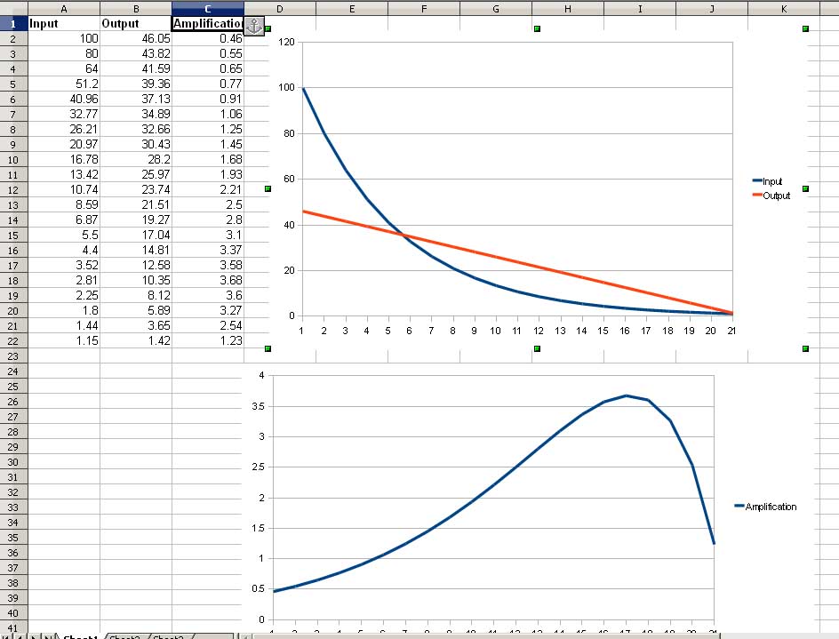

                  Hmm OK well it would seem that I don't understand at all. Applied to a mono it sought of made sense to me in that it linearized the exponential input potentially allowing earlier sampling. But an IB coil where your RX input isn't exponential and you can sample anywhere you like anyway.. I don't get it.
                  Anyway I hope I haven't upset you with my lack of tact, you are of course welcome to post anywhere you like, it doesn't have to make sense to me.
                  For all the analogue electronics noobs out there such as myself, here's my attempt at an incredibly over simplified I'm sure demonstration of what the ideal log amp does given a perfect exponentially decaying input.
                  Midas

                      Thanks for your valuable contribution and the interesting graph.
                      At the time I used the Log amp, I found that the immediate advantage was for detecting short TC targets. For example, a 5us target signal, has lost about 85% of it's amplitude at 10us after switch OFF.
                      This is where the Log amp brings the advantage, towards the end of the decay curve. I found that I could still detect a 5us target after a delay of 20us, when using the soft clipping combined with the Log function of my simple circuit from post #455.
