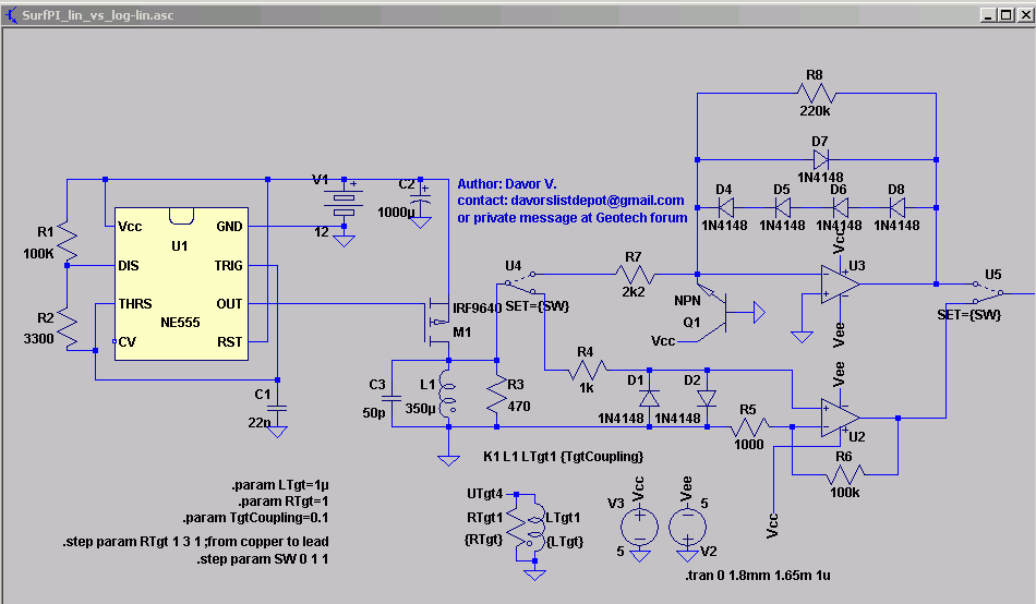

              • Hi all,
                ok, limitting the feedback loop impedance via resistor limits the gain and noise of the amplifier. But the high input impedance is still too much and is generating a lot of noise.
                The biggest issue is the temperature drift. That's the reason, why professional log-amps do cost more as they are temperature compensated.
                I suggest to test the simple log-amp and let's see, what is obviously predictable.
                Aziz

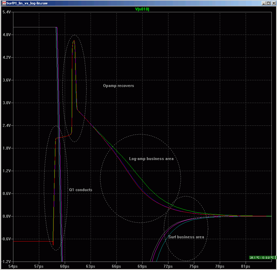

                • True, but early sampling means high signal and no problem with noise.
                  Temperature drift is a slow one, and it would matter if you need to read signal strength in decibels without calibration. Otherwise it is a non-issue.
                  I'm in a process of obtaining an oscilloscope at the long last, and my lab will then start to look up. I'd be very glad to do my own tests. You can't imagine how it is like to be lab-less. Like a thirsty person in a desert without a drop of water in my case.
                  There is a lot of response energy in the early decay time. But the reactive response (ground signals) are huge at this stage too, which makes ground balance difficult.
                  If you observe the curve obtained by the log part of the plot, you'll see quality curve splitting starting at ~4us (~2V @ coil in this particular case). If I start sampling at ~5us (~350mV @ coil) and onwards I'm out of the woods, and supposedly it will work great for detection of small nuggets. It is not that high up at all, and simultaneously it is far away from noise as well.

                      Yep, I know what you're meaning with to be lab-less (oscilloscope and other instruments).
                      We can reduce the input impedance and the feedback resistance further to minimize noise. But we need more current drive of the op-amp. An additionally installed emitter follower transistor booster stage could deliver more current in this case.
                      And we can allow the sampling at much higher coil flyback voltage levels (that's the benefit of the inverting amplifier configuration).
                      I'm sure, the temperature drift would be the biggest drawback. I should mod one of my inverting pre-amps to test this.
                      Aziz
                      • You don't need to do any of these things to lower the input impedance, just do it! Try 10k instead of 22k, and you'll notice why D3 is there
                        I've put everything as is simply to gain insight to what is possible, and to distinguish critical points.
                        Perhaps the most interesting values are 2k2 instead of 22k, and 220k in feedback instead of 2M2. Please observe how nicely the curve splits, and see why I thought of using comparators instead of bilateral switches, and level reference instead of time reference.
                        Furthermore, D3 can be replaced with unbiased NPN transistor, thus leaving the 0V reference near opamp pulse-free. See attached...

                              • Davor is C3 50pf a real component ?
