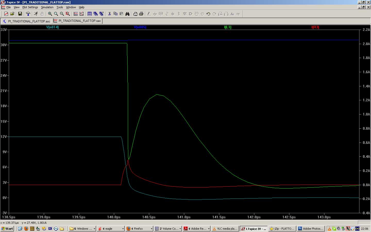

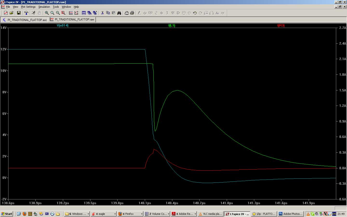

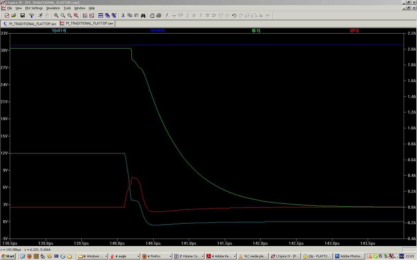

      OK here's whats happening here, changing the parasitic capacitance of the coil is altering dV/dt which is effecting how much charge is transferred across to the gate of the mosfet, holding it open. Although 20pf of parasitic capacitance seems to make the effect dissapear in actual fact it makes it kick in so fast you don't even notice it. The 500pf actually reduces the amount of charge transferred which slows the time it takes to kick in giving a more obvious dip.
      I decided to get a bit more familiar with this Ltspice thing to demonstrate what I'm talking about a bit better. I've got 3 shots in order, the 200pf original, 20pf followed by 500pf.
      Trace colours:
      Cyan = mosfet gate voltage
      Red = gate current
      Green=coil current
      Notice how the gate voltage hangs around the 4v (gate threshold voltage) to a greater or lesser extent.

              Actually, the real problem seems to be in the inductor model. The 200pF capacitance is in parallel with the inductor and its DC resistance, but it's an ideal capacitance model. i.e. no series resistance. This causes a huge current spike to appear across the inductor model when the mosfet (or switch) turns on.
              I removed all parameters from the inductor, except the inductance of course; and inserted a resistor (3 ohm) in series with the coil with a capacitor (200pF) across it. In all cases - with or without mosfet - the glitch has disappeared.
              However, as Carl discovered, there are some glitches there in practice, which implies that we need a more complex model, to make sure simulation matches reality. There most likely needs to be at least a capacitor for inter-winding capacitance and for the connecting cable, etc. ... but don't forget all the other parameters on the capacitor (such as equivalent series resistance and inductance; and equivalent parallel resistance and capacitance).
              Obviously there are some issues with charge across the gate of the mosfet, but that's not the whole story. Have a look at the attached simulation, and you'll see the glitches are not there. The bottom line is that there's no way to add an equivalent series resistance to the parallel capaitance in the inductor properties. The best way to solve this would be to create a subcircuit for the coil, and not rely on the LTSpice model alone.
