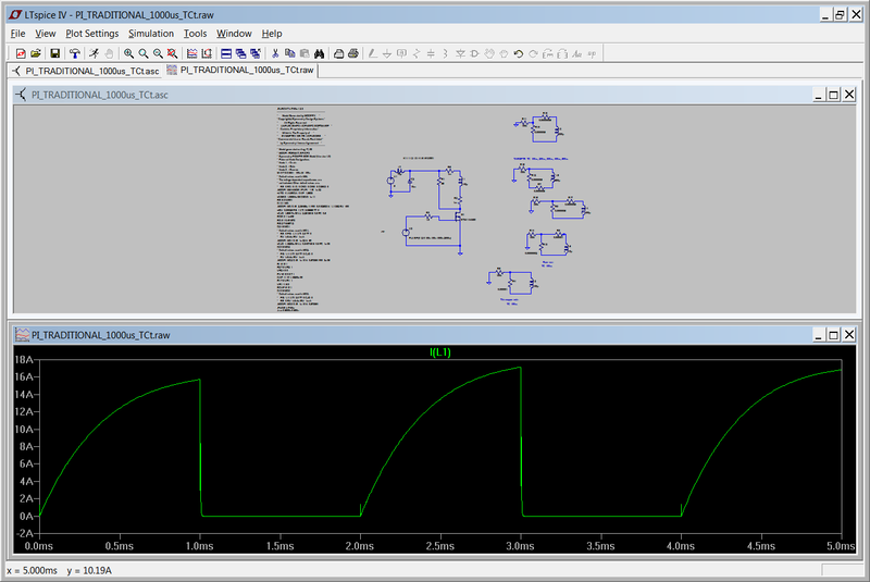

                                When we look at the schematics, they look deceptively similar. However, the resulting TX pulses are radically different.
                                I will add some current wave form pictures of 4 different methods. The TEM method is by far the most efficient. Note: I show the current wave form, not the voltage wave form, because it is the current that generates the magnetic field.
                                The first picture attached is the traditional PI current wave form.
                                later we can look at the target response that this current pulse achieves.
