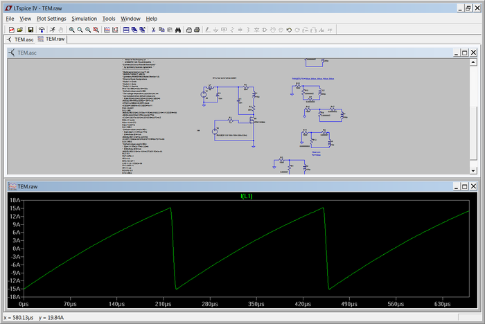

DEEPER PI DETECTION DEPTH
    Below is the TEM current wave form.
    What is different?
    About the same coil current and Flyback voltage.
    A higher TX voltage and a much higher pulse repetition rate.
    How does the target response compare? We will see the pictures later.
    How does the power consumption compare? Big surprise, The TEM method uses a fraction of the power, because it recycles the power instead of burning it off in the damping resistor.

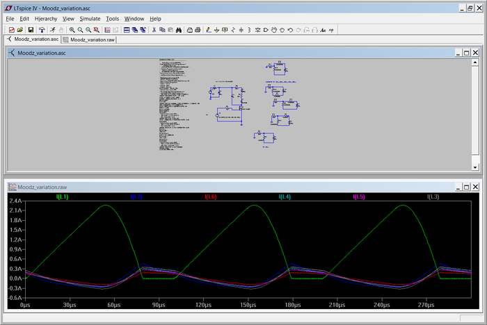

                    Below is the Moodz variation.
                    The coil current is the yellow trace. Take note of the peak amperes.
                    Not much difference in the circuit, but different output. The pulses are positive only.
                    The power consumption is only very slightly more.
                    We get more PPS, that is good.
                    I added the target response of the 5 targets of different size. Take note of the signal amplitude.
                    The peak target amplitude is 472mA
                    Tinkerer

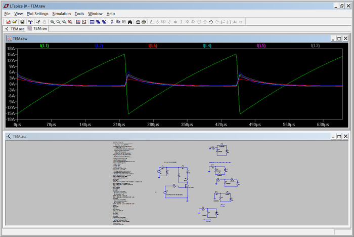

                            Actually I got the TEM target response sim ready, so I post it here.
                            Below is the TEM method again.
                            Same power consumption, take note of the peak amperes of the yellow trace.
                            The pulses are bi-polar, this makes a big difference.
                            We get less PPS only about 4300 PPS. Still enough to do some integration to get a good S/N and keep the response fast.
                            Take note of the target signal amplitude. Same targets as the Moodz variation. These are 5 resistive targets like gold nuggets of different size.
                            You can see the peak target amplitude is over 6A
                            Tinkerer
                              Tinkerer
                              Tinkerer,
                              that isn't the moodz's version (variation ok, why not). Connect the tuning capacitor to the anode of the diode (not cathode). You should get a sine like wave form at the resonance frequency.
                              Aziz
                              • #45
                                Tinkerer,
                                Aziz
                                Aziz is right mine did have a diode and the wave form is sinewave ... it is part of my new project D-IGSL ( Digital IGSL ) it rocks
