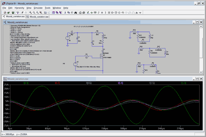

      Aziz is right mine did have a diode and the wave form is sinewave ... it is part of my new project D-IGSL ( Digital IGSL ) it rocks
      Ups, sorry for the mistake.
      Here is the corrected sim.
      Again, the yellow trace is the coil current.
      The other 5 traces are the responses of resistive targets as could represent gold nuggets of different size.
      As it is, this Moodz version uses about 10% less power than the TEM sim as shown above.
      Tinkerer
      • #48
        Tinkerer,
        this is now looking right.
        The more efficiency is owed to the fact, that a lot of the energy is held in the resonant LC tank rather than moved in the whole TX circuit. Only losses will be injected into the LC tank.
        Let's heat up the gold nuggets -> hot gold nuggets (induction heater principle).
        Aziz

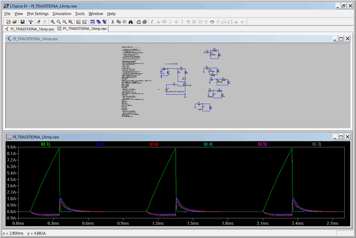

            Below, again the traditional PI method, so that we can compare the amplitude of the target response.
            About the same power consumption. (1A)
            The yellow trace is again the coil current.
            The PPS are very much less, about 1000PPS
            The peak target response is 2.24A
            About the amplitude of the target response: To be able to show the TX current and the target response on the same screen, so that one can see the relation, the scales had to be manipulated. Obviously the real target response is not 2.24 Amps, more like 224uA.
            But the target response in itself is fairly accurate. This whole series of sims, use the same proportions so that they can be compared with each other.

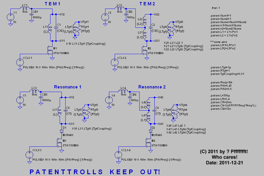

              More power to the people - ups - I mean targets!
              Now split the coil L into two halves: upper and lower coil part with either equal or different winding turns (auto-transformer) and feed it at the center junction of the coils (capacitor over both coil parts). See below for more details.
              This gives the target the freakin kicking at the expense of more battery power consumption of course. And you can crank up the freakin flyback voltage (kilo Volts region if you like), which gives more room the to limitted break down voltage of the mosfet and diode. The lower coil part (near the diode/mosfet) should have either equal winding turns or lesser.
              You can find the correct inductance splitting formula in the spice model.
              When Num1=1 and Num2=1, it's a center tapped coil.
              When Num1=1 and Num2=2, the upper coil part has two times turns count of the lower coil part. Take care of splitting the resistance of the coils correct (LR1(lower) and LR2(upper)).
              Beam me up Scotty!
              Bzzzzzzzzzd.
              Aziz
              PS: I have added the zipped spice file for your convenience.
              Cheers
              PPS: Change the buffer caps on the right side to the same value (CB2 and CB4 = 10000µ).
