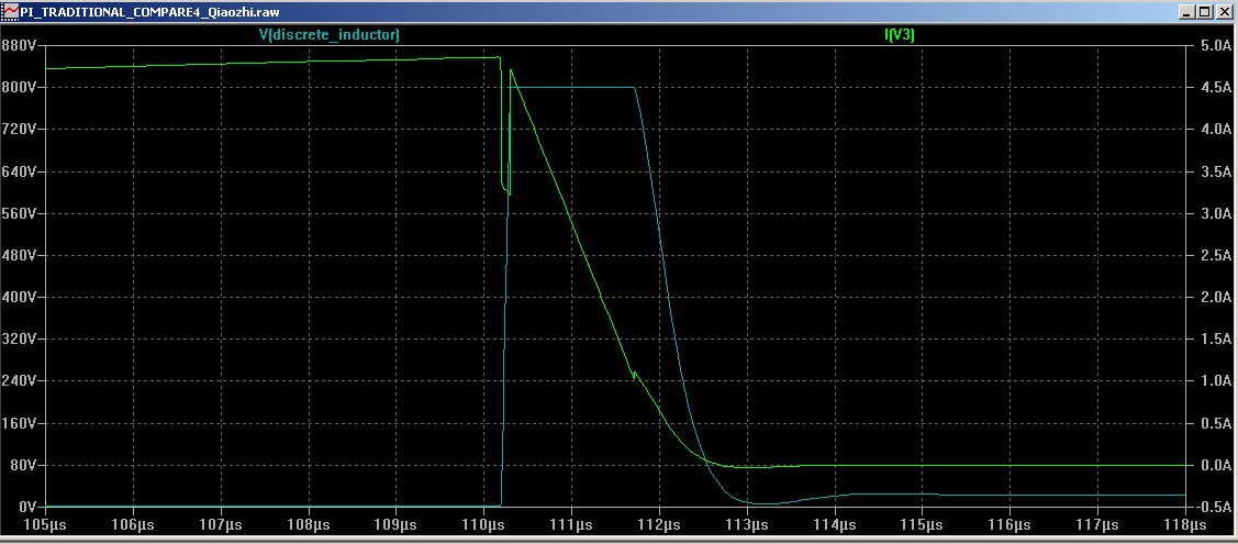

    OK - I understand what you were doing now. Yes, now I can see they're the same.
    By the way, if you rotate the resistor by 180 degrees and replace it, the current plots can be overlaid with the correct polarity. Actually, the correct way to do this in SPICE is to use a zero-volt voltage source. Make sure you place it with the positive terminal on the left.
    It certainly looks like we've found the real source of the problem. Good job!
    I just plot -I(R6) to overlay them. But I like rotating the resistor better!
    I wondered what the best way was! I'll try to remember zero-volt voltage source next time. Thanks!
    -SB
      I cascoded the NMOS and the glitch remained, so I'm doubtful that it is CDG feedthrough. Interesting.
      If I lower the gate resistor from 100 to 10 ohms in the simulation, I get a similar result to your scope picture.

                This in fact compares well with reality, except that the use of an ideal capacitor in series with the coil makes the glitches seem worse than they are in practice. In some simulations I ran, it was possible for the glitches to reach peaks of current as high as 60A.
                In conclusion, we just need to be careful when using the LTSpice inductor model, and to be aware that any current measurement you add to the plot pane [labelled I(L1), for example] does not represent the current flowing in a single component, but rather the overall equivalent network.
                Good work Qiaozhi. You've nailed down the main issue, zero ESR parasitic capacitance in the inductance model. Pretty sloppy work on LT's part.

                          How do you come to that conclusion? The parasitic cap parameters are there to be specified by you if you want to. It's your choice.
                          You just have to know when your are comparing apples to oranges. If one coil has the parasitic parameters specified, and the other coil does not and you instead include them externally, you can no longer just compare the "coil" currents and expect them to be equal, because one coil includes the parasitic components, and the other doesn't, right?
                          If instead you compare the two "network" currents, they match up nicely, showing LTSpice is working as expected.
                          Is there any mystery? Isn't that the way LTSpice should work?
                          -SB
