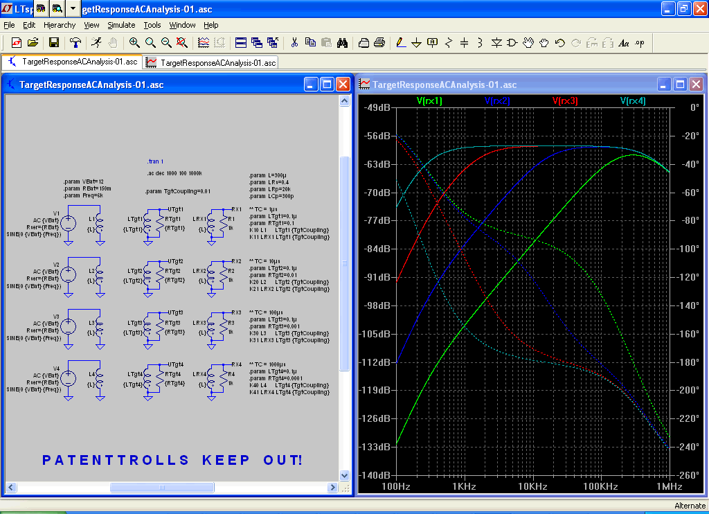

The Dark Pulse Theory
Hi guys,
the Dark Pulse Theoryâ„¢ (
nice name - isn't it?
) states, that there is no free lunch for you! I'm so sorry for this bad news. But it is very overdue now.
The EM pulse has a spectral energy, which is "seen" by the inductively coupled target and is responding to this pulse accordingly. The TX -> Target -> RX system has a frequency response as well (well, we can see it as a multi-stage filter response).
The nature offers you the maximum possible available information by physics law. All you can do is making either worse or loosing/throwing away that amount of available information.
You can easily see the proof of this statement by making a simple AC analysis (frequency response analysis) for different time constant (TC) targets. I have made this for four different TC targets for you. For your convenience, I'll put the spice file and you can play with it.
Now looking forward to the interesting discussion.
Cheers,
The Dark Aziz

Don't forget Aziz, the information in the TX pulse is not what we are trying to recover. We're really trying to estimate the system parameters defining a target. The reponse has that information even though the bandwidth is radically different from the TX pulse.Originally posted by Aziz View PostHi guys,

We are ringing a bell and trying to figure out what kind of bell it is. We don't expect the sound of the bell to be anything like the hammer blow we hit it with. But it will hopefully tell us all about the bell.

Hi SB,Originally posted by simonbaker View PostDon't forget Aziz, the information in the TX pulse is not what we are trying to recover. We're really trying to estimate the system parameters defining a target. The reponse has that information even though the bandwidth is radically different from the TX pulse.
Cheers,
-SB
the simple but fundamental AC analysis tells a lot. You should think about it.
BTW, you all should do more AC analysis rather than transient analysis.
Cheers,
Aziz
Yeah, I probably missed your point. Maybe you are saying: do an FFT on the response signal and look at that for patterns? How do we sample enough points to do that, isn't it tough to get even a few, or not? What are you proposing?Originally posted by Aziz View PostHi SB,
