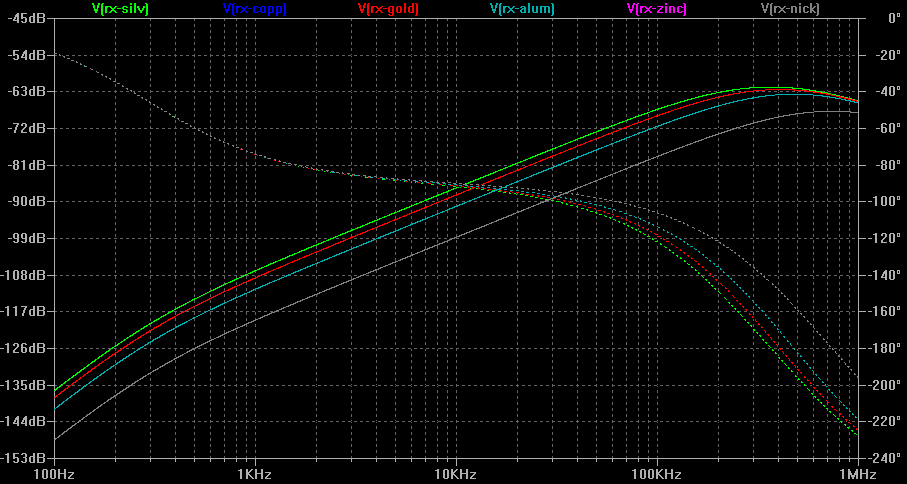

                Ok, I'll bite...
                I guess my first impression is that the spectral shape is very sensitive to target time constant but not too sensitive to RX/TX coil inductance, so you can use that information to differentiate targets.
                However, you have pretty radical differences in target resistance. Is that realistic?
                For fun, I tried substituting actual metal conductivity resistances for the target resistor values. I have no idea if that is valid. So let me know if that is meaningless or not.
                Below is a comparison of the RX response for those targets.
                Does it mean anything, or just BS?
                -SB
                P.S. Gee, the phases look nice and differentiated above 100 kHz -- maybe some sort of phase detector would be useful... what does that remind me of...

                      Ok, I'll bite...
                      -SB
                      Simon - In AZIZ's simulation he use targets with time constants of 1us, 10us, 100us and 1ms. These all seem very reasonable values to use, except perhaps the 1ms target.
                      However, in your version you have the following:
                      silver = 625ns
                      copper = 588ns
                      gold = 435ns
                      aluminium = 370ns
                      zinc = 167ns
                      These all seem to be far too short.
                      Remember that TC = L/R.

                          Yes, I just took a wild stab, I modified one of Aziz's target resistors slightly and made the others proportional.
                          Why would metals with a conductivity range of 1:7 have orders of magnitude different time constants?
                          I need education on target modeling. How do you come up with those TCs?
                          -SB

                              To find the time constant, simply divide L by R.
                              I can see what you were trying to do in your example, but you cannot replace R by the resistivity of the material. For one thing, resistivity is measured in ohm-meters, and for copper (for example) the resistivity is 1.68 x 10E-8, not 0.17. Also, the time constant of a target depends very much on its size, shape and orientation, and not just its resistivity.
                              All you can really do is use a set of targets with various time constants, as Aziz did in his simulation. Trying to define a target for a particular material is not possible, otherwise you could use this method to provide a PI with target discrimination, which you cannot.
                                Ok. I wasn't trying to calculate the actual resistance, just make relative targets (1.68 x 10E-8 is ohms per something).
                                But if there is data that shows that range of "time constants" is representative, that's what we have to deal with.
                                However, how do we relate the time constant of a target to its shape and metal? We need some kind of relationship for Aziz's graphs to be useful.
                                -SB
