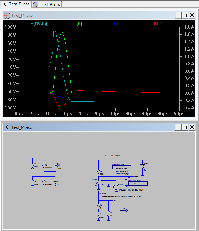

    Using the usual resistive 200us and 15us TC targets.
    • Originally posted by Tinkerer View Post
      Nice - can we compare this with a traditional pulse on the same graph?
      -SB

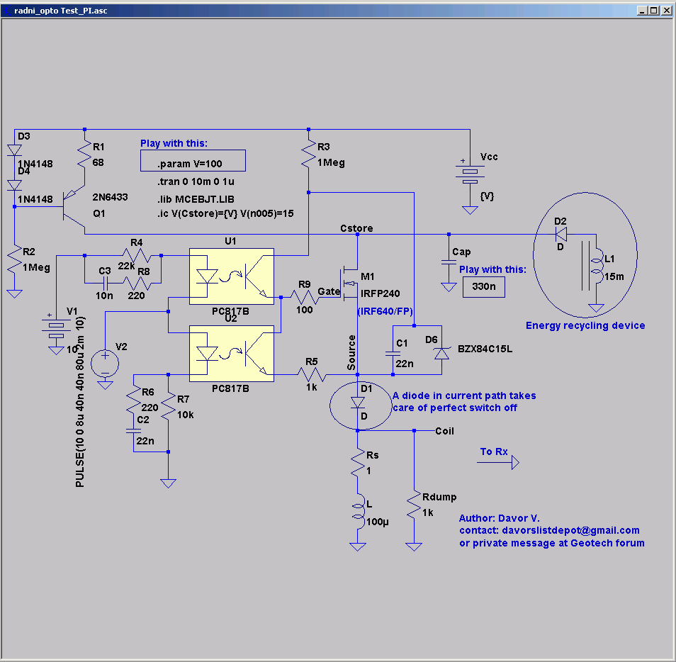

          Hey Tinkerer, can you post the LTSpice file?
          -SB
            -SB

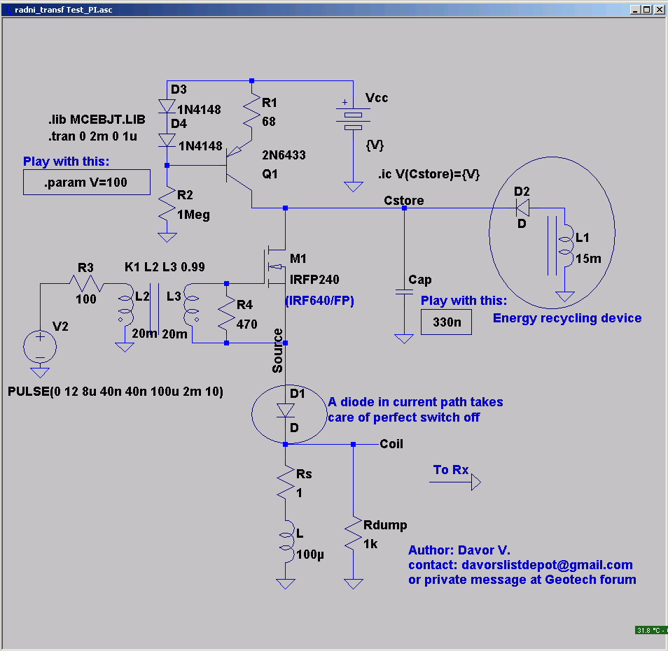

            Here is the zip with the traditional PI and the test_PI. I think that to put the result on the same graph, you need to re-draw one of the asc files onto the other one.
              What is a "slower target" mate?
              Again: only dI/dt matters!
              I'm afraid he just might be right. Responses to cosine edges (dI/dt) do tend to cancel each other for taus much longer than the stimulus duration, much like a gradient microphone does. So this idea could use some more thinking over. I think there is a potential in it, heck, gradient mikes are not bad at all. Maybe it will be perfect for gold - who knows?
              I am still much more in favour of voltage step, but somehow got carried away with this. I've even put some flash around the bones, and not just one but two versions. Instead of a H-bridge which could prove better but much more complicated, I put just another coil to do the same thing in opposite direction with another diode. Again no stress to any of the components, and only plain vanilla parts. Simple. As MOSFET gate floats with voltage change, it required some exotic approach, and I assembled both opto coupler, and gate transformer. Since good transformation is obtained with somewhat too large inductivity to be found in normal stores, I made a simple solution with optos. Works as the concept or better, but I'll have to convince myself that there is any merit to it. Single coil is a tempting possibility though.

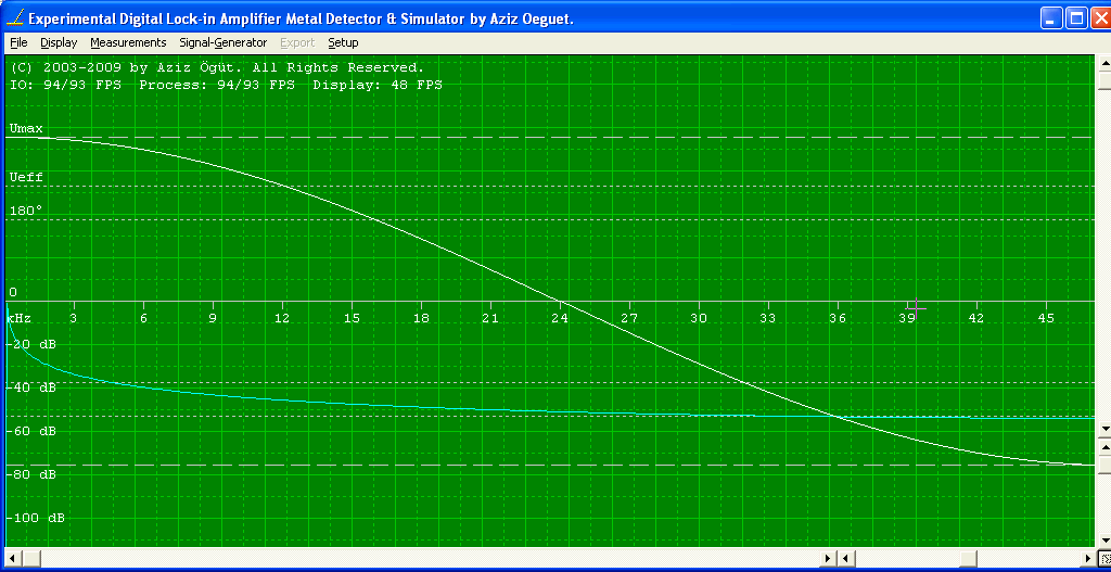

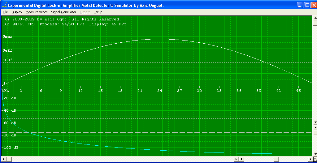

              • Half Sine/Cosine Pulse FFT
                Hi all,
                so what's the difference between a half sine and half cosine current pulse?
                See below in the order half sine and half cosine:
                Color cyan represents the FFT magnitude response.
                Cheers,
                Aziz
                • There is a distinct phase traversal at the middle which will have some saying in choice of a pulse duration in case you are into discrimination.
                  I guess we'll have to stick to a single convention here as to what we observe and why. I assumed a voltage as a more relevant (dI/dt and constant ampere-turns), but for all practical purposes - it is the same. I missed to include a library of a high voltage pnp in the schematics, so here it goes...
                    The half-cosine has discontinuities which results in higher broadband FD response. Interestingly, a half-cosine current has a half-sine voltage response, and vice-versa, so when you look at the FFT are you looking at the voltage or current? Does it matter?
                    In the far more interesting time domain, half-cosine has the advantage of a PI-like discontinuity; half-sine has the advantage of a di/dt=0 that is useful for GB. Personally, I would combine them.
                    - Carl
                      - Carl
                      Hi Carl,
                      it doesn't matter, what you apply: current or voltage. The FFT isn't complaining at all. The current pulse is meant of course.
                      Well, the half-cosine pulse is DC free and has +6 dB more FD response due to +Max .. -Max range compared to the half-sine response (in the example +Max .. 0). If I would make a half-sine pulse over +Max .. -Max range, the whole half-sine FD response is shifted by +6 dB only.
                      But I like the wide discontinues of the half-cosine current pulse (wide band characteristics better than a half-sine pulse).
                      "half-sine has the advantage of a di/dt=0 that is useful for GB"
                      This requires an induction balance (IB) coil configuration (obviously). Unfortunately, the mono coil can't sample this in the half-sine pulse variant.
                      Cheers,
                      Aziz

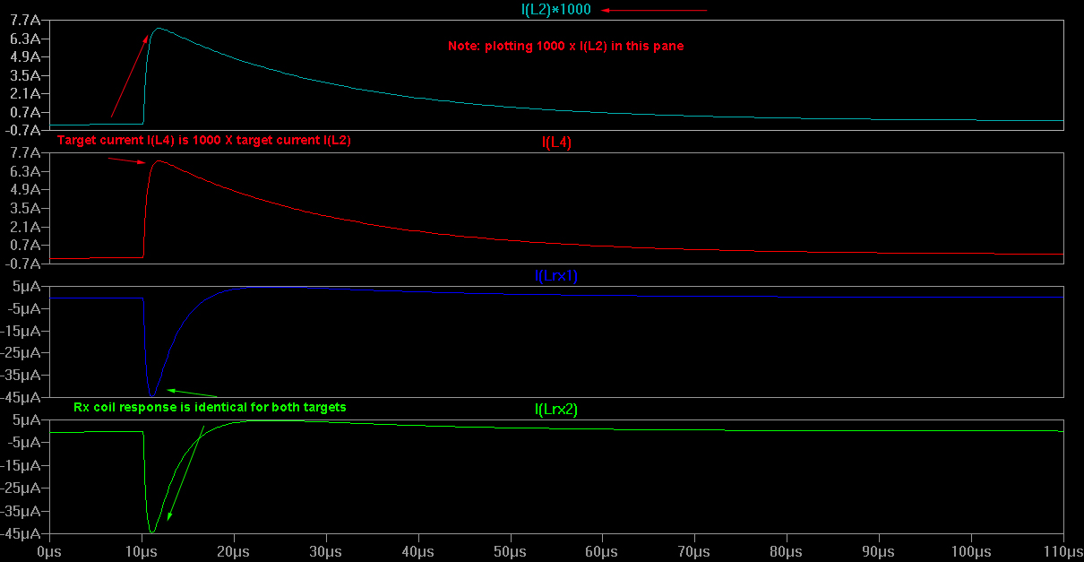

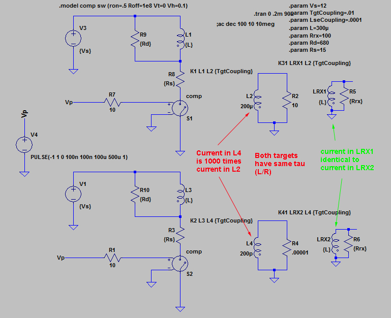

                            • puzzle
                              Here is a not-so-hard puzzle, because I know some people here like riddles...
                              I think it also illustrates some pitfalls to modeling physical reality with spice circuits, and maybe reopens some discussion concerning targets and previous simulations.
                              The attached LTSpice circuit is an idealized PI pulse hitting two targets. Both targets happen to have the same "tau" (L/R). However, the current waveform in one target is 1000 times bigger than in the other, otherwise the same shape.
                              Also we have a two identical simulated Rx coils, one for each target. But... the responses in the Rx coils are identical even though one target has 1000 times the amplitude response than the other.
                              Holy cow... what gives?
                              The answer should make us go back and question some recent simulations for realism, or at least discuss them again.
                              Cheers!
                              -SB
                              • That is the whole idea of discrimination - should work the same for objects of identical tau.
                                BTW, it is irrelevant how much inductivity your targets are, because it is always a short circuit. There is a circular current flow wether you separate it into many short-circuited wires or a single ring - what matters is ampere turns and tau. Tau is a related to L/R and additionally complicated by skin effect, but that's it. With L/R=const. you may scale L however you want. The targets you depicted in a puzzle are basically the same. The amount of ampere turns in spice is related only to coupling.
                                I personally prefer "normal" R values - makes things less awkward
