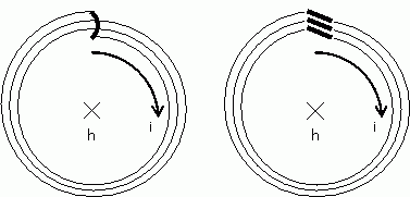

    Davor, target inductivity is mostly controlled by skin effect. Target R is largely determined by metal conductivity. Target size & shape affect both. However, it is true that, for modeling purposes, you only need to get the tau right.
    - Carl
    • Got it, eddies take care of it. Skin effect is due to current flow within a target. Thanks.
      Anyway, I made a small conceptual drawing of a high L -> high R and low L -> low R with a constant L/R.
      BTW, same goes for search coils as well.

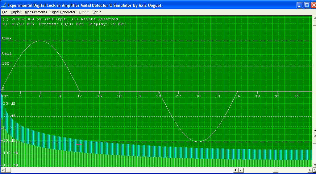

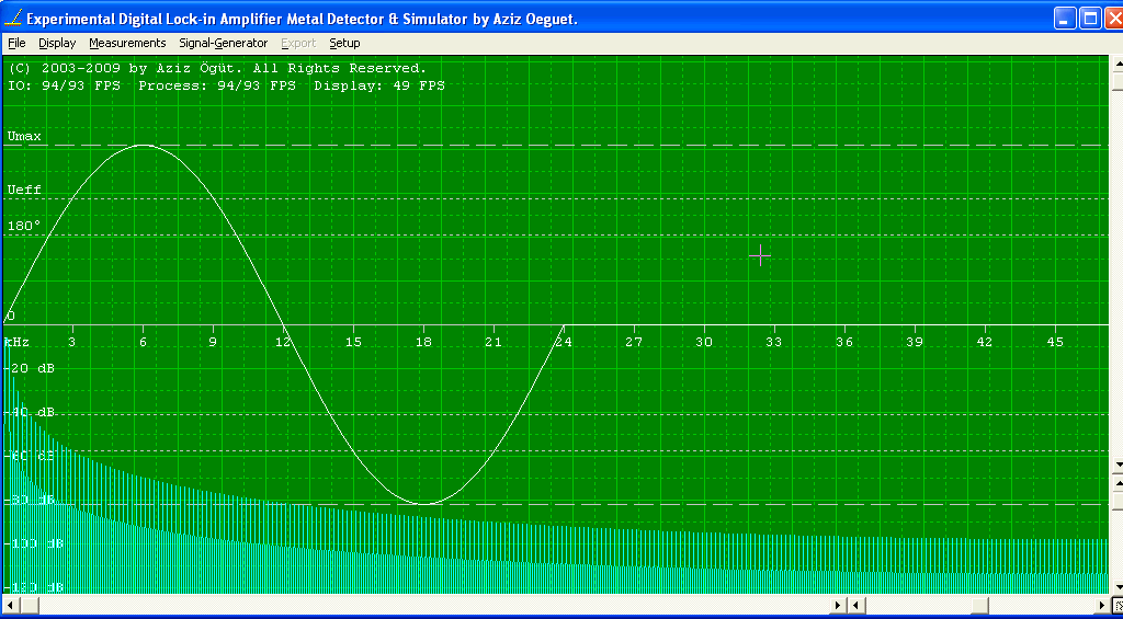

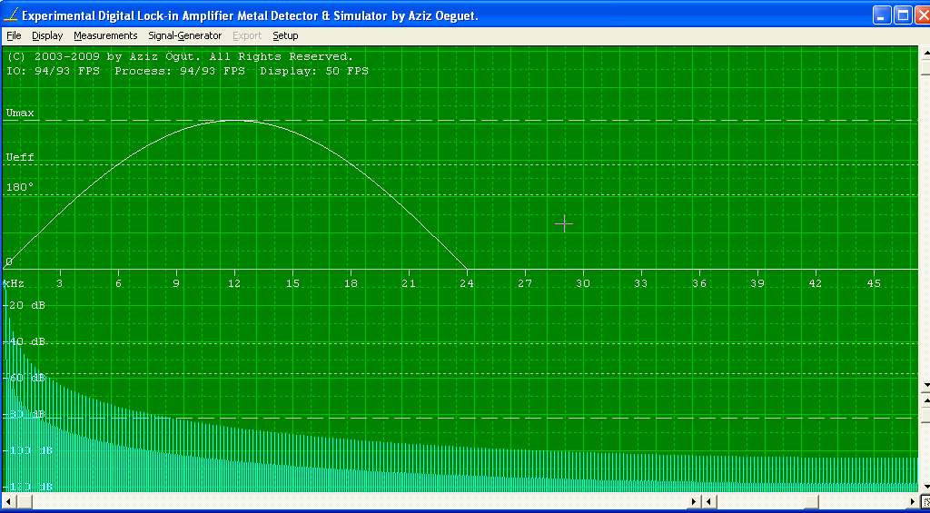

          Hi all,
          here is an another brain food for you tinkerers.
          Continuous single frequency mode (VLF) vs. interrupted (paused) single frequency mode.
          The first mode do not need a FFT display. All the spectral energy is focused in the fundamental frequency.
          But what happens, when I interrupt the resonant mode? I.e. first half-sine current pulse, pause, next but negative half-sine current pulse and pause again?
          Look at the bottom picture. One wouldn't probably guess, that the FD response is a wide band response. (odd harmonics 1,3,5,7,9,...)
          The wide band characteristics disappear, when I set:
          half-sine, negative half-sine, pause, pause =
          full wave sine, pause, pause
          So what's next?
          -> interrupt the continuous single frequency resonant mode.
          Aziz

              Those discontinuities look wide-band to me... like part square wave, which is broadband.
              Can you show the last one you described that is supposedly narrow band?
                          -SB
                          Ok,
                          I admit, I was wrong. (Good mistake, which keeps learning.)
                          The full wave sine and pause pulse has a wide band spectrum as the sine wave abruptly discontinues in the time-domain. So the spectral energy isn't totally focused to the fundamental frequency.
                          See below.
                          Cheers,
                          Aziz
