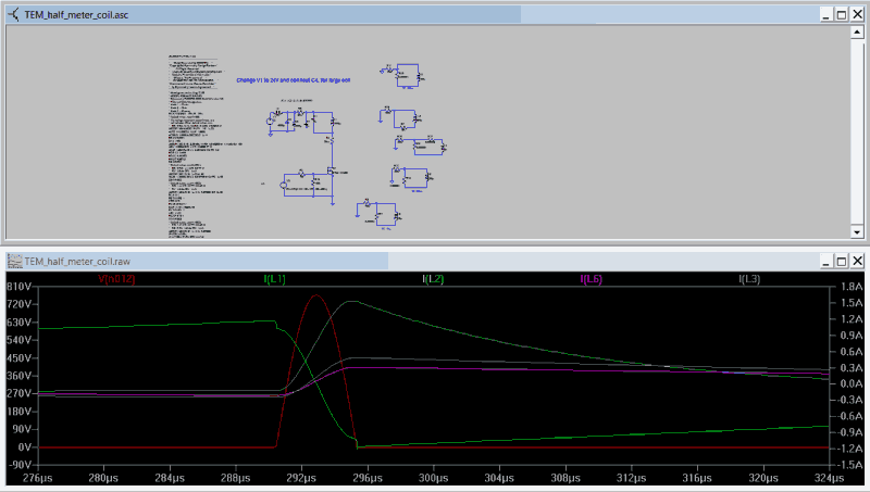

            • Concrete TX proposal
              Here is a concrete proposal for TX parameters, that can be switched for a large coil of 1 meter diameter and a smaller coil of 0.5m diameter. It is the best I can come up with.
              If you find something better, I would like to try it.
              I would also appreciate suggestions for improvement.
              I attach a screen shot and the LTSpice file.

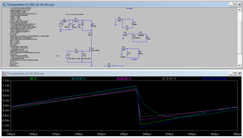

              • Target response with FE DISCIMINATION
                Attached is a screen shot, with the target responses. The blue trace represents an FE target.
                Note that the target response of the FE target is 180 degrees phase shifted.
                Also attached is the LTSice file, zipped.
                This would be the approximate response as seen by the RX coil in an IB configuration.

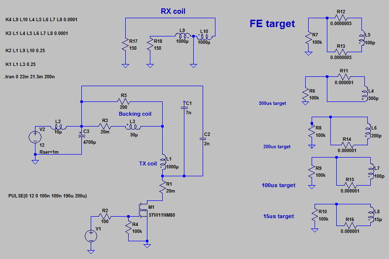

                    • TX-RX- BU-TARGET COUPLING
                      Could somebody help me getting the K Spice directive right?
                      The circuit is for the IB coil configuration. K1 L1 L3 0.25 is about right. But I can not get all the other couplings to work at the same time. K2, K3, K4,
                      Tinkerer

                            Hi Tinkerer:
                            I would specify your mutual inductances just two at a time, because specifying more at once causes every combination of two to be specified, and some don't really apply.
                            You don't really need coupling from target to target, for example, although it's so small probably won't hurt.
                            Also, you don't want to specify .0001 between your two RX coils -- I think your two Rx coils representing a center-tapped coil probably need to be coupled with a coefficient close to 1 (or -1), in which case you should end up with an inductance approx equal to 1000u combined (is that what you want?).
                            Specifying the separate coupling between the Tx and Rx coils -- oooh, don't make my brain hurt. The phasing may require a negative coupling for one of them.
                            I'm not sure about the bucking coil -- seems you need to couple that to the RX coils also, although I'm not sure what physical configuration you are modeling -- concentric coils??? Maybe you should just assume the bucking coil works perfectly and omit all the couplings between the TX coils and the RX coils?
                            But I think specifying only pair at a time is the way to go.
                            -SB

                                Thanks SB,
                                This is for a concentric coaxial IB coil. The coil works great, but I would like to be able to simulate it, because it is easier to simulate many variations than building many coils.
                                The RX coils are center tapped, but I just realize that the phase dots are wrong on the circuit drawing. The coils are of the same phase or just one coil, center tapped. The RX coils are wound on the BU coil. Coupling near 1 between the 3 coils.
                                The BU coil is counter phase of the TX coil, but the coupling is about 0.25.
                                The RX signal is received by the RX, BU and TX coils. Due to the coupling and precise balancing, the R signal and the X signal are of opposite phase at the output of the RX coil.
                                Easy FE discrimination.
                                Tinkerer
