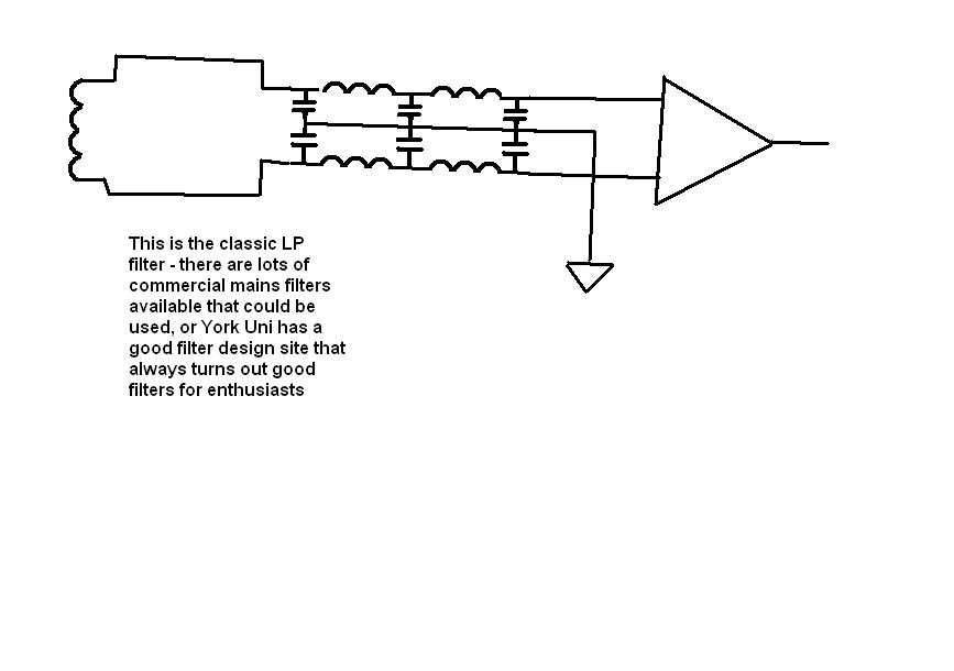

          The signal of a small target has a TC of less than 5us. To capture such signals, the bandwidth of the coil and preamp should be above 100kHz.
          When people used the NE5534 preamp with a gain of 1000, this automatically reduced the bandwidth. However, using better opamps with more bandwidth, a low pass filter before the preamp if the configuration allows, and /or bandwidth limiting the preamp reduces the noise significantly.
          I like to use a differential input preamp. Now how does a lowpass filter in front of the preamp influence the common mode rejection?
          Tinkerer
          • The filter would be duplicated, one per input. The common center terminal of the filter containing the filtered signals goes to gnd.
            If the filter has symmetry there would be no penalty to the common mode rejection.
            steve

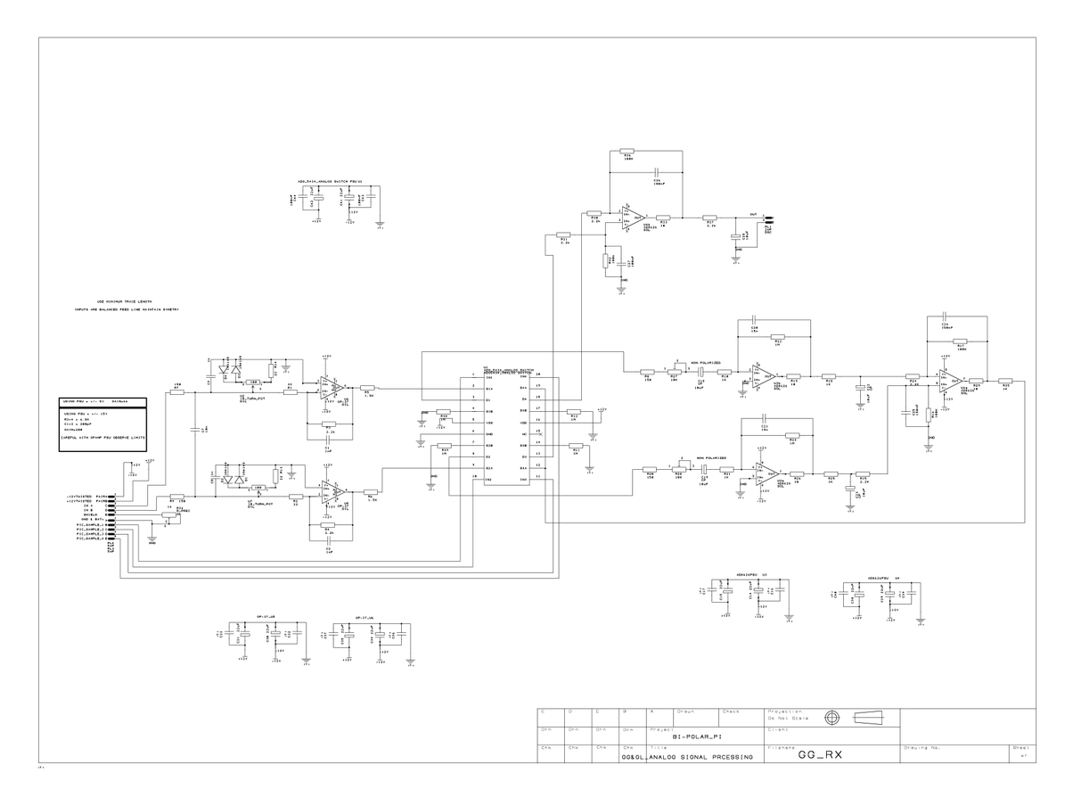

              Hi Steve,
              would you like to help me improve this RX schematic of mine?
              It works, but I am sure it could be improved a lot.
              I would much appreciate.
              Tinkerer

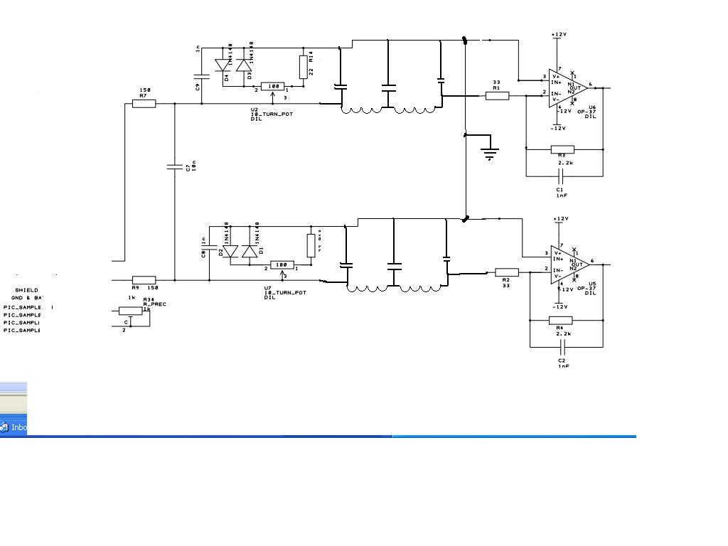

              • HI, with the cct you posted - If LP filters were what U required I would fit them here.
                Having them close to the amp gives the best chance of catching noise.
                If U wanted this topology I could get U some values for a roll-off corner of your choice.
                Steve

                  Thanks for the feedback.
                  I would like to try 2 different frequencies. About 100kHz and about 150kHz to see what the influence on the small and very small target response is.
                  The RX coil is center tapped, about 300uH, but I still want to try different inductance.
                  Thanks for the help
                  Tinkerer

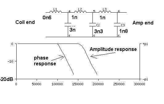

                  • I would remove the RC filter R7,9 C8 - The RC filters loose signal power in the resistive elements - the LC ones dont to speak of.
                    The order of this filter is a little more than I sketched, The input impedance I chose 500R and the output z to op amp came out as 560R
                    S

                      Thank you for the filter.
                      What are the specs for the inductors?
                      A question about the impedance:
                      I have a variable voltage divider between R9, U7, R13. I use this to adjust both legs of the RX coil to the same signal amplitude.
                      The diodes should not conduct, they are there as a precaution only for when there is a problem with the induction balance.
                      R34, is to adjust the offset caused by the shield of some types of cables.
                      Increasing the impedance, reduces the amplitude of the signal, which allows for more amplification in the preamp, at the cost of more noise.
                      Eliminating more noise with the filters, before the input of the preamp is going to help.
                      I feel there is a sweet spot, where the S/N is best.
                      How do I determine that spot?
                      Tinkerer
                        No constraints really, if the value is good, The R value will only be an ohm or so.
                        Layout in more important, dont have th coils close together as they will couple signal rather than conduct signal.

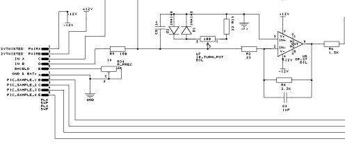

                        • Many thanks Steve,
                          yes, I have about 1000 questions left but I guess I must not overdo it. On the other side, there are probably many other members of the forum who dare not ask themselves but are glad to learn from your answers.
                          So please, just one more...
                          hmm
                          I don't know why this happens. The pot solves the problem, but I would prefer to avoid the problem all together. The cables are also very sensitive to touching with the hand and moving /vibration.
                          What can be the cause for that?

                          • I would be speculating if I thrust an answer at you..
                            1)Having a Star ground point can have advantages. ie a single elected gnd/
                            It should be Low R and low L and then sheilds, bonds, battery -ve, pcb gnds all go to it.
                            2) If you are running a fair Tx signal the wrapped metalised polyester film cable shield may not be low enough L or R and will have signals resident on it.
                            Often if U have signals on braid it can be a sign that things are mismatched. I suspect this is partly the case. The characteristic impedance of the cable wont be the same as the impedance of the loop antenna system.
                            If U have a small amount of signal on Ur braid - which I guess U have - You burn these away in your pot. If U can live with it its quite an elegant solution.
                            U could try to work out the impedance of your loop to The Tx signals then either do a match cct so all of ur signal goes in, or pick a cable with a characteristic Z closer to you Tx loop at Tx frequencies.
                            Or fit a sleeve balun at the head end to trap braid currents
                            Or Use a ferrite clip on at the head end to absorb braid currents (ironically) due to eddy current losses in the ferrite.
