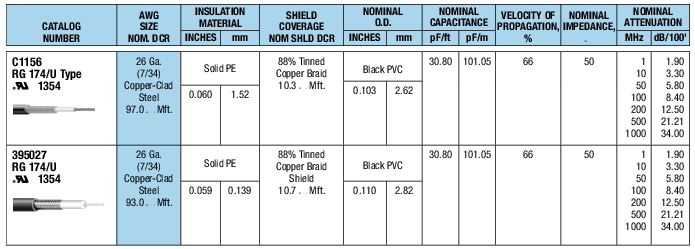

    So right now, I have 2 RG174/U cables from the center tapped RX coil to the RX board. The braid is the center tap and the 2 inners the 2 leads of the coil.
    It takes 390 Ohms from the joined (at the board) braids to ground to get rid of the offset.
    According to the attached specsheet of the cable, it would seem that the cable is OK for my signal frequency. I also see that it is a 50 Ohm cable. Hmm, 50 Ohms, should I do something with that?
    Next thing to look at: The impedance of the RX coil x the impedance of the cable?

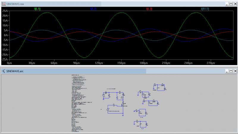

                  • -SB,
                    here is one for you. This is a sine wave simulation.
                    The green trace is the coil current.
                    The 3 other traces are the response signals of 3 different targets.
                    Tinkerer

                        Midas, thanks for the feedback.
                        I am not sure what you mean with "reverse eddy currents".
                        Maybe the SINEWAVE simulation gives you an idea of what the response looks like for a continuously changing current wave form.
                        I have posted many, many screen shots of real target response. Now I am trying to make simulations that fit the real target responses. One of the simulation problems I have, is to make different coupling factors (k) for different inductors within the same sim.
                        Would somebody be so kind and give me a tip of how to do that?
                        Triangular pulses and non linear triangular pulses. Or what about a series of triangular pulses that at every point of inflection the ramp rate gets proggressively steeper and steeper?

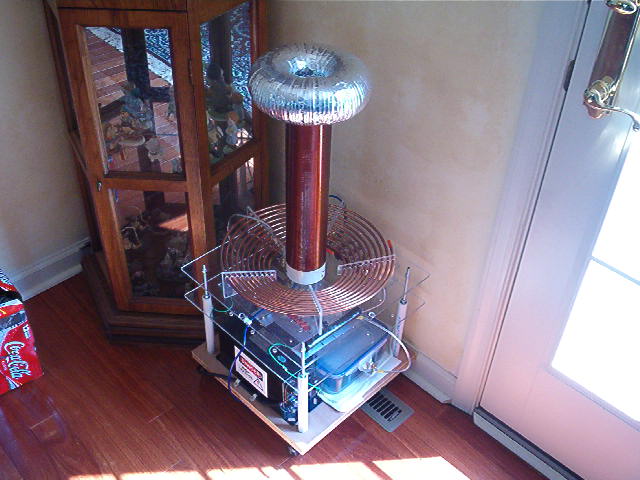

                              Ha! Interesting idea. Personally, I have not had good luck with mixing Tesla coils with modern devices. I was playing with mine inside the house, and I lost all the Ge diodes in my crystal sets and it somehow blew out the eletronics module in my water heater. Pictures are difficult to take with a digital camera because it keeps crashing the camera and TV sets go out to lunch and have to be power cycled to get them to come back. Not sure that it's good for your nuts either..
                              This one consumes about 450 Watts. Not sure how much of that energy makes it into the air but makes nice 15" steamers.
