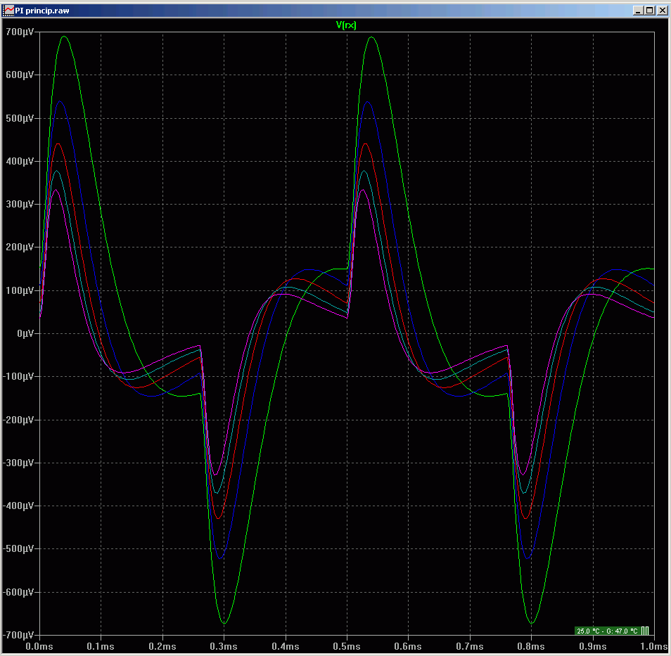

                • Yeah, it is a bit frustrating not to see it as an animated powerpoint presentation .
                  Aziz put a nice LTSpice model with a quoted post, where all the components had regular values. By first glance you'll see nothing much going on, but there is. You may easily play with values and see how the whole shebang gets affected. Everything is in AC (mag/phase) domain.
                  Now, with receiver signal having a 0 DC, it is obvious that whatever happens in time domain right after a PI pulse, must go through zero, and a whole signal integrated from pulse to pulse is zero. If target's tau is not affected by Tx coil's resistance (you may observe it as a transformer), you'll get a Rx signal that passes through zero with the same delay from PI pulse, regardless of depth/size, hence discrimination.
                  Attached is a LTSpice simulation of a White's oscillator working as a PI exciter, and a step voltage excitation I was meditating upon. There are ".step param" options to play with, but these should work as they are. Please note how clean the signal gets with stepped exciter.
                  It is just a thought ...

                    • Aziz, I like what you do, and it is in many ways fundamental. But if you really wish to drive attention, and also keep people on the same track, you could provide some hints as well
                      Thank you
                        Thank you
                        -You all are driving me mad! -
                        Where is the mental doctor for me?
                        You shouldn't try to guess, what I'm thinking. The question is plain straight forward.
                        What can you extract basic fundamentals on the mentioned AC response?
                        Aziz
                        • Duh ...
                          It says to me that with the same coupling, amplitude (target size and/or distance) remains the same ... within reasonable frequency range. In case I'm terribly wrong, could you please provide some hints?
