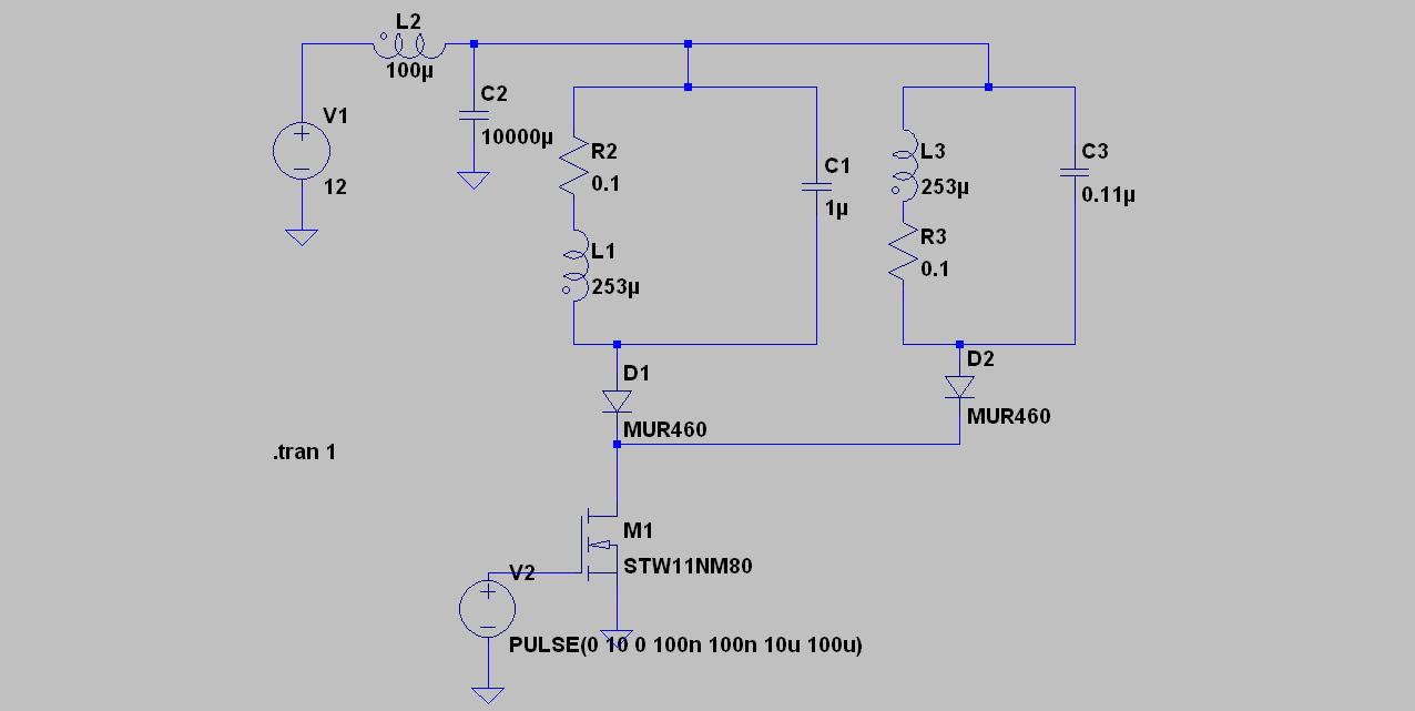

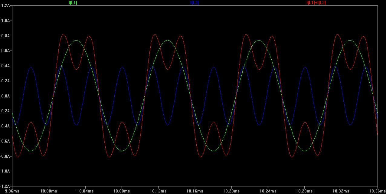

        ... hehe ... but thats not all as they say on TV.
        Below is a TX circuit for a "wideband" VLF ..... we just use two frequencies
        Arrange the two transmit coils for minimum coupling then a third receive coil with minimum coupling to two transmit coils and you have the tri coil wideband VLF....... the mag field from the two TX coils provides a "square wave" *****at the target**** through simple magnitude summation. The summation is shown in the red trace ... note the transition of the red trace appears faster than either of the individual frequencies ....LOL This two tone method gives target info at a low and high frequency. Because the TX is fed from a single pulse generator everything stays in lock. A PLL modification prevents detuning due to ground ( not shown here ) TX circuit is very simple and current draw is very low
        moodz

        • Hi Moodz,
          really excellent idea and exciting possibilities. I must say, I like the transmitter much more now.
          Comeon guys, share your ideas and we can optimize it further. Let's do a team work.
          Aziz
