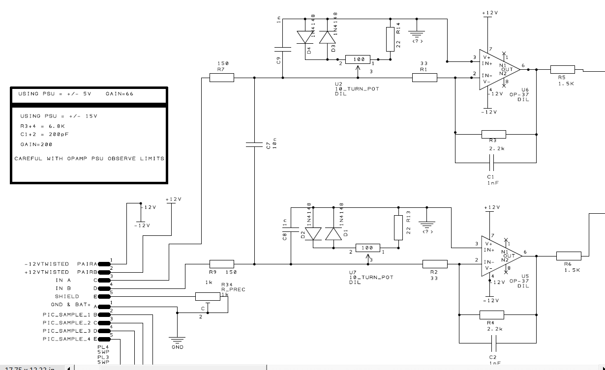

                          Aziz, Davor, Midas, Moodz and many other voices point out the possibility that the preamp stage could be improved a lot. It is time to do it.
                          We do NOT WANT: Clipping
                          Saturation
                          Overloading of the pre-amp.
                          We want to use an opamp that is fast enough, but not too fast.
                          We want to use the maximum amplification, while staying within these parameters.
                          Would using a +/- 12V supply instead of +/-5V, help? More amplification, without clipping and saturation.
                          Limiting the bandwidth to the actual needed one, would help.
                          What is the needed bandwidth anyway?
                          If we want to resolve a 1us target, we should aim for 1MHz. But, can we build a coil with a self resonating frequency of 1MHz? If the coil can only resolve 250kHz, we can also reduce the pre-amp bandwidth to the same frequency.
                          Reducing the bandwidth, increases the dynamic range.
                          What else can we do???
                          Attached is a proposal for a differential input pre-amp, to go with the TEM TX shown above.
                          Can it be improved? For sure it can, a lot.
                          Suggestions?????????????
                          Tinkerer

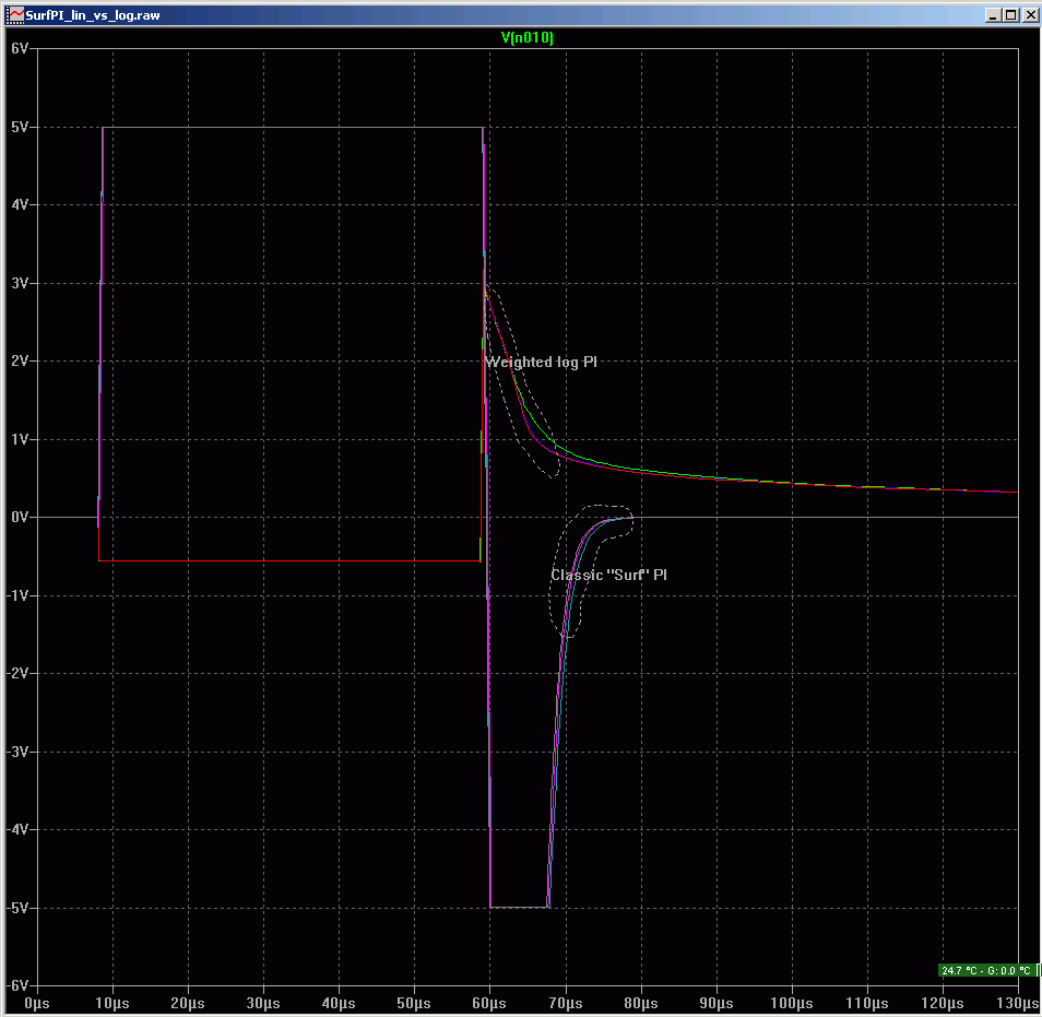

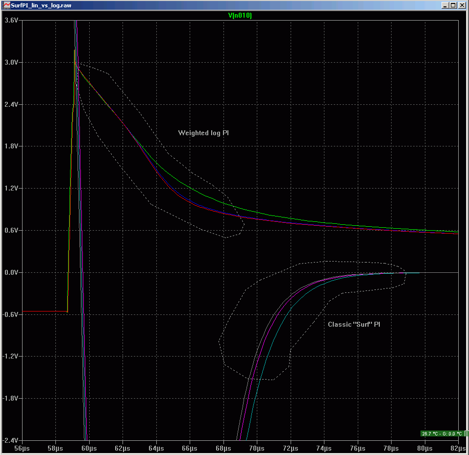

                          • Originally posted by Tinkerer View Post
                            Saturation
                            The biggest point is that you actually don't have a 1us target response, only a concept that forces you to think into that direction. By my standards you already have far too much amplification in any "classical" PI design. Noise level is at, say uV levels, and signal is near mV levels, hence by applying extra gain you just decrease your dynamic range.
                            What actually is bothering you much more than everything else is a floating ground, and that is your main enemy with opamp in frontend.
                            There is a simple solution to many problems, and much more, if you decide to drop the high gain opamp. It is a chopper. Ready-to-wear chopper stabilised opamps are slow and expensive, but it is not a big deal to make your own implementation using analog switches. You don't have to be extremely accurate, so your design may be fast enough to properly sample a PI signal. So instead of one or two windows as for discrimination purposes, you could have, say 10 windows, each supplied to an alternating opamp input, or keep them in SAH-style analog buffer for bucket-brigading into something slow and accurate.
                            If you are only into high amplification, then just chopper-sample into an alternating signal, amplify, and anti-chopper into a perfectly windowed and perfectly amplified PI Rx windowed signal. Or something in between. Say, two perfectly amplified PI Rx windows for discrimination purposes. You can even apply some weighting function to samples to make them even more interesting.
                            That would be related to your integration window. Incredibly fast pulses (chopper) can be successfully integrated by incredibly slow integrators. In case you apply some averaging scheme using samples from several PI pulses, then it goes longer and loooonger. You ca'nt make it too long because metal detecting is a somewhat physically active thing, but I'd say that ~20 Hz could become practical. Same as with VLF IB.
                            • Maybe I was not too straightforward in my explanation, so I suggest exploring a Tayloe mixer as a perfect example what a chopper can do.
                              A Tayloe mixer uses successive sampling of typically 4 pulses in a row at 90° intervals of a RF signal. 0 and 180° are used for I and 90° 270° are used for Q. It is also possible to use any number of samples, as long as they are used with respective phases.
                              In PI signal decomposition you don't have phases but time deltas, and your sampling will run a finite number of samples after each PI pulse, thus in effect running cyclically.
                              Your design already has a balanced input and a ground reference (centre tap), hence your choppers do not need to alternate between signal and ground, so it is a perfect candidate for Tayloe style sampler. Tayloe is usually realised with bifilar coiled transformer with centre tap (double balanced). With Tayloe, samples are stored in capacitors that - in a succession of many samples - act as a LPF. I'm thinking of ~20Hz range. Any garden variety opamp can deal with that. They can also be anti-Tayloed at a pace of your need, say ADC clock, and you can do even more magic with them in DSP. Or just do some plain old boring math and spit out indications for size and a kind of metal.
                              I think you could as well do with only one sampling window, but why not more?! In case of the above piece of schematic, just replace R7 and R9 with analog switches gated at PI window sample, and a C between them replace with two signal ground referenced capacitors dimensioned for ~20Hz LPF.
                              PI signal is very orthogonal against the Tx pulse by virtue of non-concurrency. Even with monocoil. It can be fixed to do much more and better than IB VLF. I just know that.

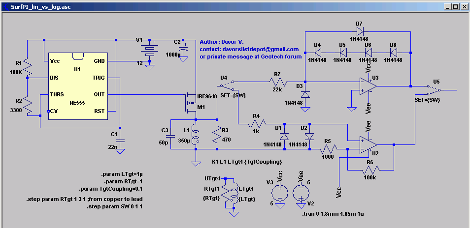

                              • It seem only appropriate to continue here where we left some time ago. Now this is big. I present you a LTspice simulation of a logarithmic weighted PI Rx with dead time of less than 2 microseconds. Furthermore, its output is logarithmically compressed so there will be much fewer bits required for ADC, where required.
                                There are some additional repercussions of this approach that enable some very interesting solutions to discrimination (say, you may play with C3 and observe consequences), but finally it is THE weighted solution I was mumbling incoherently for the past few months. Also, it is an inverting solution and thus the signal decays opposite to the "Surf" solution.
                                On the schematic you'll find two switches that are used to divert signal to a common node, and prevent two Rx-es to interfere with each other, and to draw output in nice colours. The opamp with a bunch of diodes is a log detector: nothing fancy, but works as a horse. I'm aware this is going to perform a bit differently with a real world opamp, but here you go - a place to start experimenting. This can sample very early.
                                Patent trolls - keep off!!!
