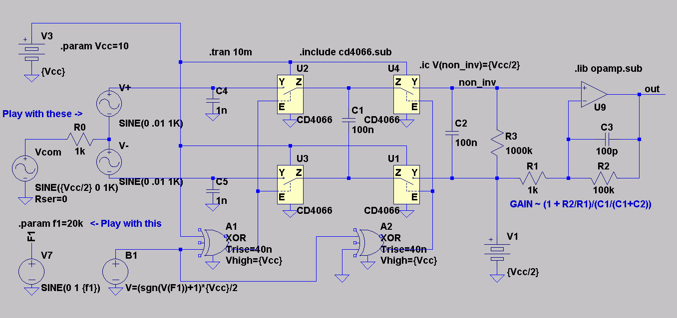

    I am toying with a matchless detector by rev Scarborough. OK, it is a toy, but it has a potential. All metal readings are related to mutual inductance between search coil and a target, and in case of "beat balance" it is merely acting as a free running PWM. Perhaps the PWM principle will yield a better PI after all.
    BTW, there is an arrangement that uses a capacitor and analog switches that yields an opamp with over 120dB CMMR. Having PI sample as a windowed pulse, this seem as a perfect candidate, and it is not complicated at all. Any interest?

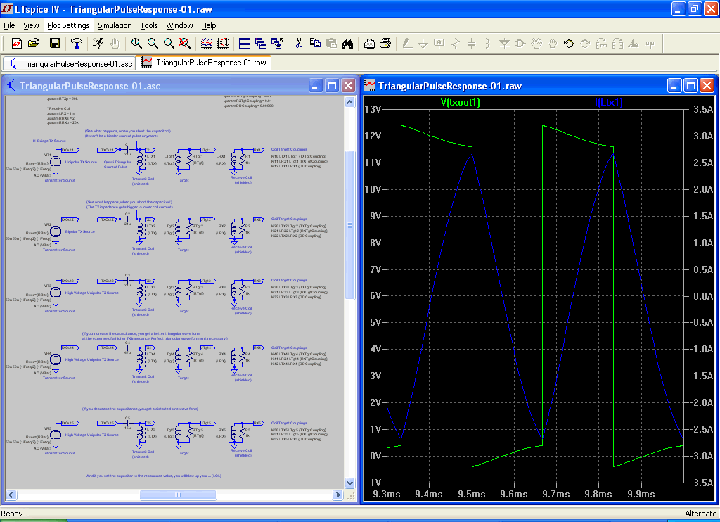

        Triangular Bipolar Current Pulse
        Hi all,
        I have prepared an LTspice simulation file for your convenience, which is showing the triangular (+quasi triangular) bipolar current pulse.
        The source is a forced step voltage coming from a simple H-bridge driver (rectangular step source voltage).
        Note, that the blocking capacitor reduces the TX impedance further. It is essential if you use an unipolar voltage source to block the DC voltage.
        The blocking capacitor isn't required if you use a symmetrical bipolar source. But you will have a higher TX impedance. So using the blocking capacitor doesn't hurt you.
        To overcome the high TX impedance, just increase your source voltage. Note, that the voltage rating of the capacitor is important, when you come into the resonance frequency region (high voltage!!!).
        You can also use standard bipolar electrolytic capacitors but you have to select the capacitor value appropriate to the frequency and coils inductivity not to create a high negative and positive voltage. Set the capacitor value just to produce a voltage over the capacitor between 0 - source voltage level. Take care to the polarity.
        Have fun.
        Cheers,
        Aziz
        PS: Patent Trolls! Keep Out!

          That's more like it. If you push it just a tiny bit, it is all the same as if you produce high voltage across a high L in PI style, except that the classic PI transient is suffering from high Z.
          The high CMMR thing is based upon the LTC1043 switching capacitor controller. I prepared a somewhat more common solution using 4066 for your convenience. Enjoy.
          LTC1043 has very interesting specs, and its clock can be completely controlled from outside source, which makes it a very interesting sampler for PI or otherwise.
          Point is that you don't have to use a chopper as a mere chopper, and instead you can use it as a PI sampler/demodulator. Doing so you get instrumentation amplifier benefits as a bonus.

              Good analysis Davor ... however slight correction .... the differential coil ( or monocoil with centretap ) does bipolar beautifully because it is symmetrical already. Just add switching mosfet/diode on both sides of coil and pulse on alternative times. Rx and demod is off same coil ( RX of both sides ) Thats why the UNIPI chip I am working on has two PWM Tx outputs for bipolar tx pulsing.

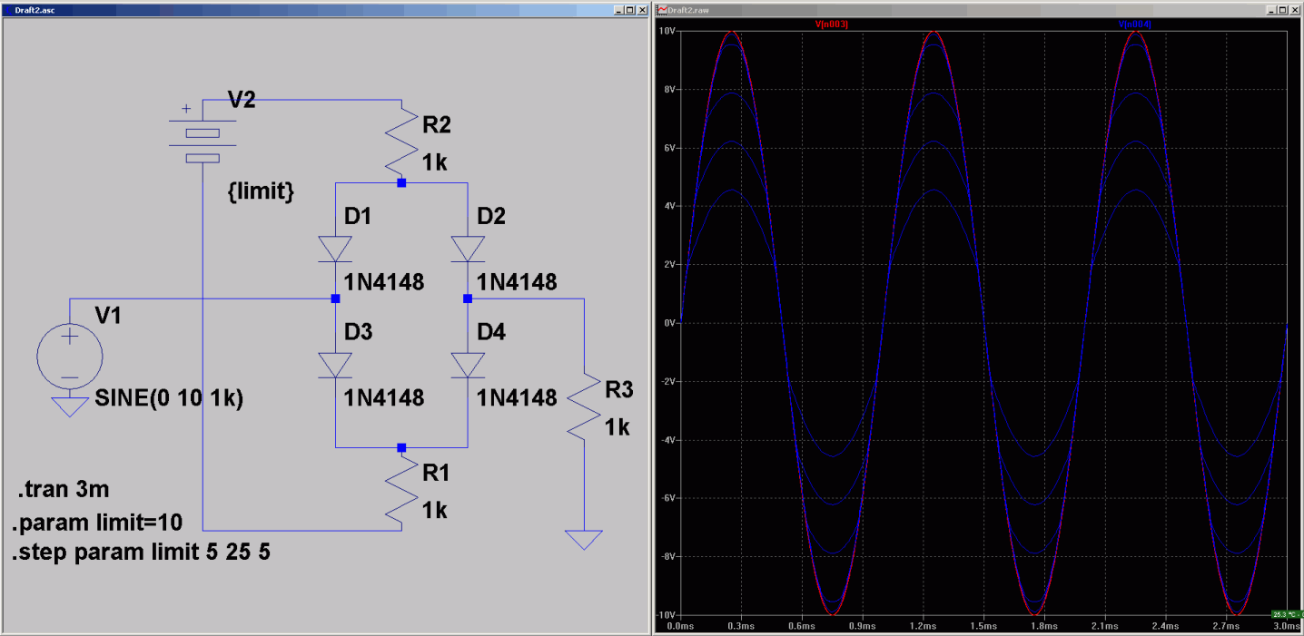

                        But somehow your MOSFET blocking scheme reminded me of diode limiters. They are very low impedance within a conducting window, maybe an order of magnitude higher than MOSFETS, but still several orders of magnitude lower than the rest of the frontend.

                          As I understand it diode limiters are already the more usual way to do it with perhaps a series resistance of 500-1000 ohms. MOSFET can be well under an ohm which makes it more like 2-3 orders of magnitude. Also I'm not sure where the rest of the input impedance is that your referring to, typically the signal goes straight into the preamp next. Although switching first seems to be coming into fashion. In theory the MOSFET blocking should be beneficial and Minelab use them to good effect, but in reality no one here that I know has really proved them to be any better. My guess is a MD needs to be VERY good before resistor noise start to become at all significant.
                          Midas
                          • #58
                            As usual I jump just a bit ahead of myself. I thought of series configuration diodes, not parallel, the way they were used in olden headphone limiters. The obvious solution would be a plain vanilla series resistor, and a pair of diodes, but in this case diodes are normally biased, with low series impedance and all, and they become switches only in case of too large signals. In this configuration they do not cut off abruptly, hence they do not suffer from recovery problems either.
                            I arranged a limiting voltage as floating, but it works even better when split and ground referenced in between. Works any way you want it.
