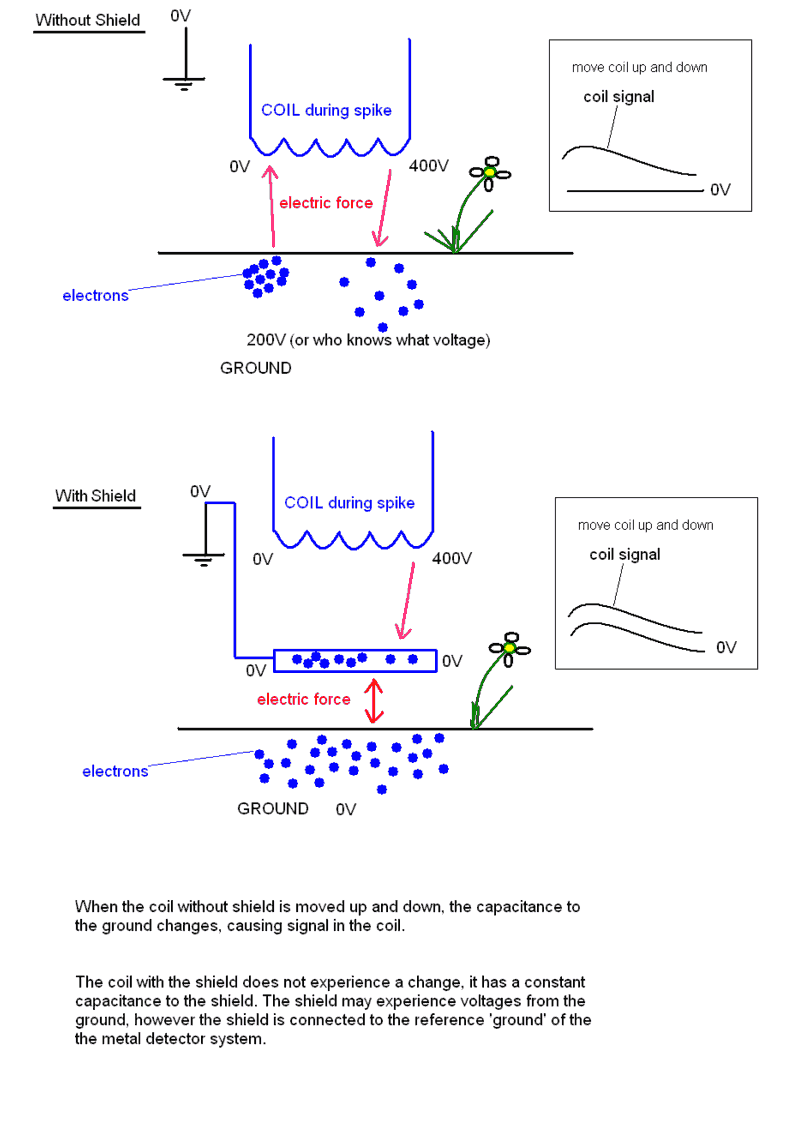

    shielding in a picture
    I'm interested in others experience with bi-pulse.
    Yes, here is my explanation of shielding (attached). I hope it is correct.
    • #62
      Very good explanation of shielding ....
      Now consider a differential coil. During flyback both +400 and -400 volts are generated. The net charge to earth is zero due to field balance ...so differential coils are less susceptable to capacitive effects to ground.
      The bipolar pulse scheme is good for EF cancellation however it modulates the rx signal so the processing is different unless you use a cross over switch scheme or something similiar at the demod / samplers.

        Thanks for the nice drawing, Tec.
        I like it so much, that I took the liberty to transform it to png and post it below.
        I used http://www.irfanview.com/index.htm to transform. This is free to download and it is very good, so I think it merits some free advertising too.
        Moodz,
        I use a center tapped RX coil with the IB-PI. During experimenting, I usually leave the coils unfinished, until I have decided on the final version.
        When I shield the coils, I apply enough shield (graphite coating) so that I can not see any influence in response, when I approach my hand to the coil.
        I found the center tapped, RX differential coils to be very insensitive to my hand without a shield.
        However, the twisted cable or even a tween coax cable is very sensitive to the touch. This seems to be still a problem that need to be solved.

            The effects of the hand on an un-shielded mono coil, appear only after a gain of about 1000, or would that be about 10bits?

                  ....the standard monocoil generates a large flyback pulse of 100s of volts ... this in turn creates an E field around the coil. This E field will couple capacitively (ie charge ) to anything remotely conductive ... like your hand or the ground or the metal detector casing and cables etc etc etc ... all standard physics.
                  The differential "mono" coil generates TWO flybacks simultaneously ( but only ONE magnetic field ) .... these two flybacks are equal and opposite in polarity so the E field at some distance from the coil ... like your hand or the ground is nearly 0 due to field cancellation ...again standard physics ( ie hundreds of times less than the standard mono coil )
                  This is not a new idea ...it has been used in things like moving coil cartridges for hifi and in MRI for medical purposes ...the differential coil is sometimes referred to as a self sheilding coil for exactly this reason.
                  moodz
                  PS there are no "hand effects" even at high amplification and 24 bits on a differential coil ...only if you are wearing a watch or a ring ...LOL

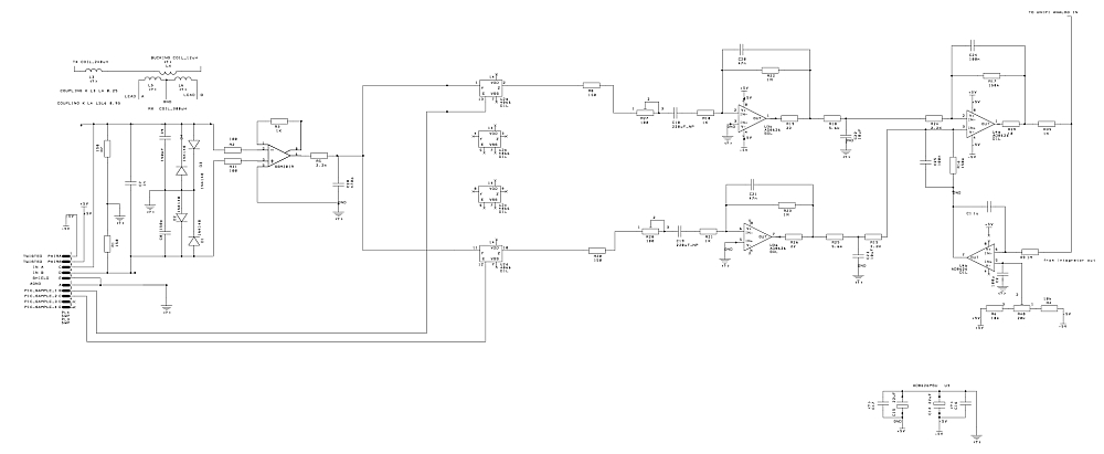

                        RX CIRCUIT
                        Attached is the RX circuit with the mystery short TC targets.
                        Tinkerer

                          I imagine these short tc targets are low level ?? ...The DSP SAT works exactly the same way .... the best way to detect a very small change is to compare / integrate a slightly delayed signal with itself ... there is no better reference as the small signals are "riding the noise". On the MCP3903 24 bit converter this method easily detects changes of 10 nanovolts.
                          Nothing new here ...I go the idea from a meter design that can measure down to 1 femptoamp ... and that is small.
                          moodz
                          moodz.
                          Moodz, thank you for the feedback.
                          So that explains how the signal got to the integrator.
                          Now I need to find where I lost the signal and then everything will be fine again.
                          I admit, I panicked there, for a while.
                          Do not panic! Do not panic!

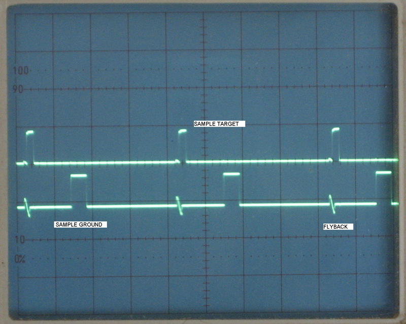

                            CRO OF SAMPLE PULSES
                            Attached is a scope picture of the sample pulses.
                            I also managed to get the Flyback on the same traces.
                            The setting is 50us/div.
                            You see the complete cycle of about 200us.
                            The Flyback and the target sample overlap a little, this gives strong FE discrimination.
                            The Ground sample is later. It can be moved to a later time, until just before the Flyback.
                            Changing the ground sample time allows for attenuating either the R or the X response and /or the response of a specific undesirable target.
