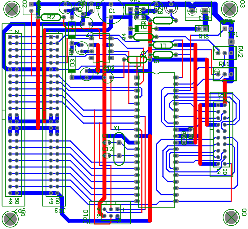

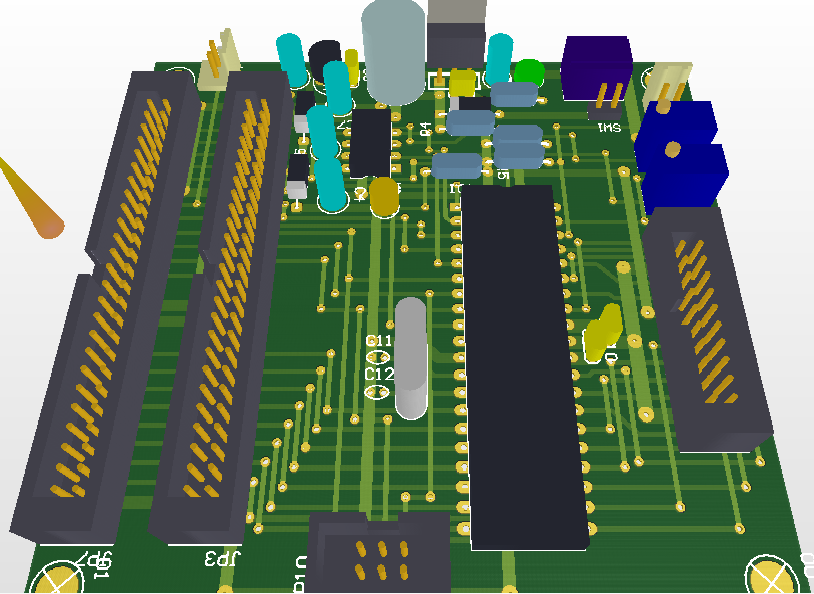

        • A PCB to have and to hold...
          OK, here's my first-pass attempt at a PCB.
          I'll just post two images first off, to get everyone's feedback on size and layout.
          This first attempt is a double-sided board, and it probably needs to be manufactured, unless you have experience with making double-sided boards. I've got a quote, for just one board on it's own is about US$70. That's the minimum, and I'll be making at least one for myself. Subsequent boards are much cheaper - for example, if 6 people want one, the full cost per person is US$25.00 That's for a solder-masked, silk-screened, through-hole plated, double-sided FR4 1/2oz copper board - better quality than anyone can hand-make. But it IS doable, if you've got experience. I've tried to minimise double-sided traces where possible.
          I'd guess that we won't want the main board made up until the daughtercards are done, which is my next project.
          If people prefer a single-sided board, I'm working on that, but it will be a bit larger and it will take some time, as I'm hand-routing everything.
          This board is 3.75 by 3.25 inches. The main changes I've made (as we discussed earlier) are : a full 5V positive regulator, which means no additional regulators on each daughtercard; boxed DIL headers for the daughtercards, which can be converted to SIL headers if you prefer, just plug in the header to the appropriate holes. And the reset circuit has been added. I've also added some bypass caps, and the final release will be ground-planed top and bottom.
          All the rest of the circuit is exactly as Bugs designed it, even the pin numbers are the same!
          Here's a really crappy 3D image of the board...Who knew that Altium's $6,500 software can't print the 3D view for nuts?
Name:	First Motherboard (3D, DS, Manual).png
          ... and here's the board layout showing the top (red) and bottom (blue) traces. Part overlays are green. And for some additional reason that escapes me, Altium won't show vias in Assembly view. But the vias are in the final output, so please ignore the bug.
          The final silkscreen will have component values for caps and resistors, and connector names for the connections, so it's really easy to build without needing the schematic. All part of the service!
          Note that the overlay view is the latest revision, and is different to the 3D view. The 3D view was an earlier revision, but it shows the parts in their correct places, and the mounting holes and so on. Just the traces have changed (for the better, I hope!). Sorry if that's confusing.
Name:	First Motherboard (DS, Manual).png
          Let me know if you're OK with this, and I'll go on to the daughtercards.

          P.S. I just realised that I forgot to mention something important : if you already have daughtercards made up, they will work perfectly in this motherboard with no changes. Just a thought.

                            • Originally posted by Pete the Builder View Post
                              Seeed Fusion offers comprehensive PCB manufacturing and prototype PCB assembly services with guaranteed quality, quick turnaround, and competitive pricing. Features include 1oz-3oz copper weight, minimum drill hole 0.2mm, fine trace width/spacing, and an online instant quote system. Ideal for makers, startups, and professional hardware developers.
                              I've used these guys with good results. Only $30 for TEN 100mmx100mm double sided, through-hole plated, silk screened, delivered. I couldn't even buy the materials to make ONE board for that price locally, and of course even if I did it as you say, it would be nothing like the quality. $3 a pop, gotta love globalization.
