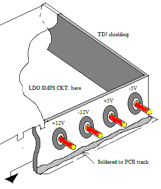

                      I'll prefer 3-inline 90 degree bent berg strips for interconnecting daughter-boards that can be bonded with PVC spacers as one unit - for power 14+V Lipo and LDO SMPS in tin enclosed & output thru bypass caps as frequently seen in Satellite TV circuits, obviously low profile one, as seen in mobile phone. See my impression below.

                      • Originally posted by vbeeeks View Post
                        [ATTACH]23083[/ATTACH]
                        vbeeks, agree with the bypass caps, was thinking of that while brainstorming the best possble RFI, EMI shielding for interconnecting modules. Similar to the analogue RF TV tuners where each input/output pins are connected to feedthrough bypass caps on metal enclosure.
                        Does anyone know where i can source these feedthrough Caps??
                        Low frequency Toroid/ferrite beads may also be used in critical interconnecting modules.
                        If you see how Military Spec gear is designed where RF and Audio is involved, you will see sub modules sealed in seperate metal enclosures, interconnected in some cases with feedthrough caps and high quality connectors and cables.
                        Might be a bit overkill, but at least the circuit designs will have the lowest possible chance of any internal/external interference to start with.

                            So. Looks like we're settling on a LiPo 14V supply (I'll also define components for 12V SLA, because I have a cupboard full of them and LiPos are a bit expensive for this pensioner... Anyway, I'm looking at a single supply input, with high-efficiency LDO regs (also nice and quiet), and a quiet and efficient inverter for -12 and -5V. Since we only need a few milliamps on the negative rail, it's a bit too much overkill with multi-output DC-DC inverters. We either need 2 inverters (one for low current rails, and one for + high current rail). The inverters I've seen either have small outputs on all the outputs (+ and -), which is great for the negative rails, but unusable for the + rail(s), or they have massive outputs on all rails and cost well over AUD$100. So a hand-carved dedicated supply is indicated. That's great, that's my speciality anyway.
                            Oh, yeah, there will be a link (or maybe links) to select between SLA, LiPo, and (maybe) AA cells. It's the discharge curve that defines the power supply input, so I'm going to look at whether or not good quality lithium cells might be usable with not too much fiddling around. Anyway..
                            The PSU will be shielded just in case. I like that idea, makes a lot of sense, since that's where most of the noise will be coming from! I hope that's acceptable to everyone? Is everyone OK with the battery/power supply options?
