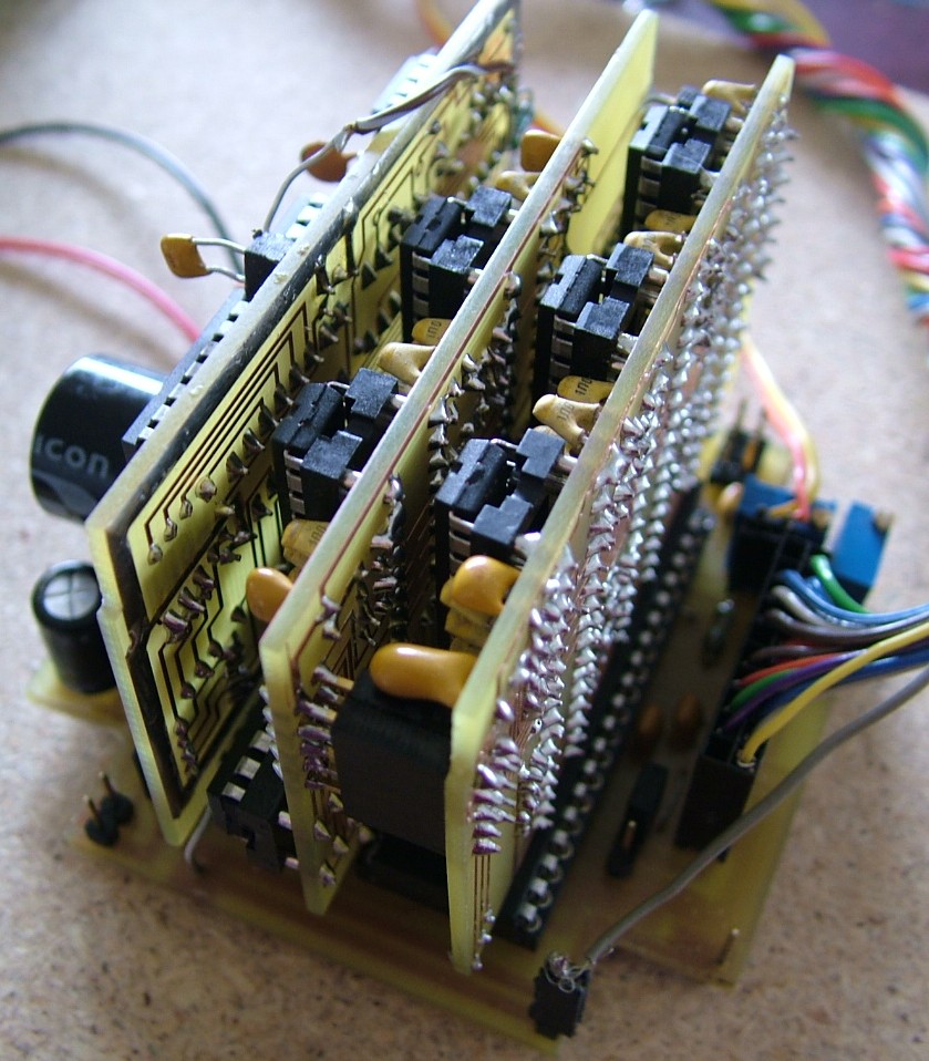

              64 SAMPLE BOARDS
              The 2 boards that make up the 64 sampler are up and running. The sample caps have been changed from 100nF to 1 nF with an increase in sensitivity not only for signal but also for noise. The major culprit, the voltage doubling charge pump is being modified so it will still produce sufficient voltage when turned off during sampling.
              Unfortunately the micro I am using has only enough RAM to store/process 48 of the 64 samples. The preferred micro, ATMEGA644 will be available around the end of April so we will have to wait until then to see the full picture.
              The intention at this stage is to get as many samples as possible of the knee of the decay curve with the remaining samples spaced increasingly further apart to the end of even the longest decay. The later samples I suspect will really only indicate the size of the target.
              The preferred micro also runs faster (20 MHz) which will allow sampling at 100nS intervals.
              bugwhiskers

                  • #69
                    64 SAMPLER SCHEMATICS
                    The attached .PDF's are the schematics for the 2 boards that make up the UPIM 64 sampler. IC1-IC6 74HC4051. The #2 board has no bus connector, it "piggy backs" on the back of the #1 board and sits very snugly above the micro. This arrangement works but isn't very elegant. Using SMD, all the components will fit very easily on one PCB and the other side of the PCB could be used as a ground plane/shield. Notice AD7 is available and could be used to control the additional chips to make a 128 sampler if deemed beneficial.
                    bugwhiskers

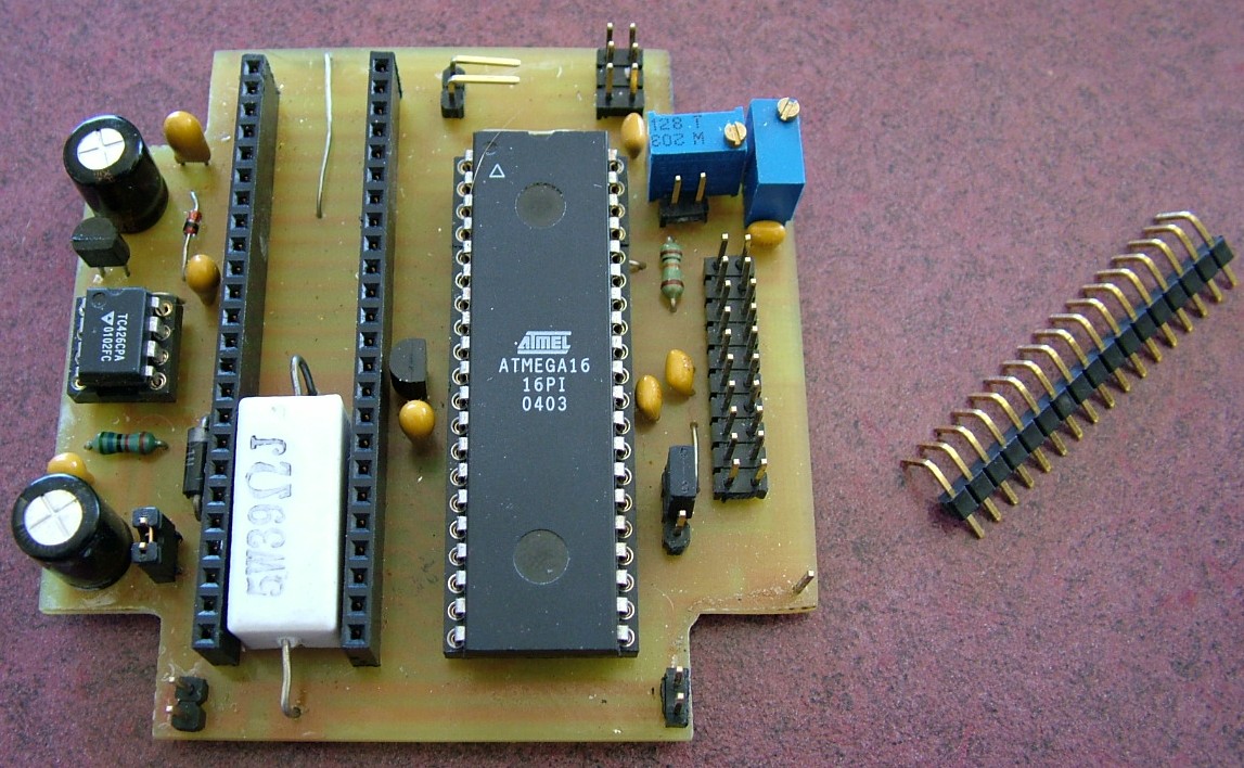

                        • #72
                          UPIM bus plugs and sockets
                          The attached pic shows the unpopulated bus sockets. Shown also is the pinhead connector. These type of connectors are the simplest, cheapest and most readily available.
                          bugwhiskers

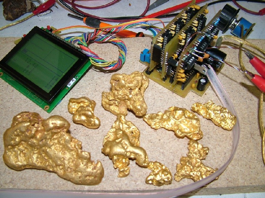

                                Drool time.
                                The pic shows the UPIM with the 64 sampler boards in place. The kind gents (members of the Prospecting Oz test team) allowed me to test discrimination with the nuggets pictured and I am pleased to announce that there is a distinct difference in the shape of the graph on the LCD screen between any of the nuggets and a block of steel.
                                The micro's turned up today too so I have a bit of work ahead of me.
                                bugwhiskers
                                PS The largest of the nuggets pictured is 17 ounces.
