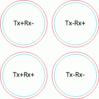

              Hi Davor,
              could you provide a detailed sketch of the coil configuration? I don't understand your coil configuration.

              I thought of this:

                  I thought of this:
                  Hi Davor,
                  Ok, I see it now what you have meant.
                  A fair comparison to the equivalent 10 inch mono coil size wouldn't give any benefits. The coils would be much smaller and they would fail the comparison run blatantly.

                      Hi Davor,
                      Aziz
                      Maybe so, but they'd be fairly easy to manufacture as the pattern is easily (quadr)uplicated. The other point is that this configuration could be easily reconfigured in 3 different configurations, of which 2 are in IB.
                      I'd be delighted to see it's performance in this very configuration as this one would be the best imaginable configuration against the far field EMI. It's only odd feature is that it has a sharp minimum in the very centre, hence pinpointing would be extremely sharp, but in the sense of signal absence.
                      We already discussed a coil in a similar configuration, and it appears that it has a cold spot right in a middle, and my idea was to use it as a submersible rig that would be completely intrinsic, with electronics in a middle.
                      Could you reconsider testing it :wink: :nudge:

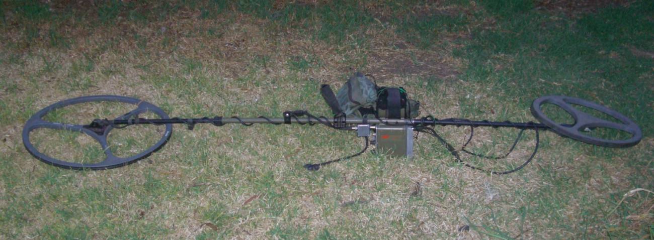

                        • HI Aziz,
                          Try this, standard mono coil on the ground(25") and at the other end of the detector handle about 1M behind the operator another mono coil parallel to the ground about 1.5m from the ground. The coil behind the operator is used to cancel/reduce emi and is just a standard coil, 300uh. The emi coil will be a smaller coil, 18 or 16". and will have the same self resosnace as the main mono coil. The emi is subtracted in the electronics of the front end.
                          This should reduce emi making the use of the larger mono coil much more pleasant. Unfortunately both coils will not always be parallel, so the reduction will vary a bit, but this should be better than just a standard mono...... Whatcha think? I'm going to give this a bash on the weekend.
                          Cheers Mick
                          • Hi Guys,
                            Well perhaps I should get my self some shares in "MadLabs Inc."(c)(tm)(r)" I'm not the best with math, but my missus thinks I'm mad, in fact, I think I could be just a bit mad however it works well, very well!
                            No target subtraction, just emi reduction and it is quite forgiving. I can almost get the 25" mono quiet at my house, it will be a dream while out bush. I might even be able to use a smaller coil for the emi coil to make it all a bit lighter, but even as it is, the detector is still quite usable
                            Cheers Mick
                            Possible "MadLabs Inc."(c)(tm)(r) participant

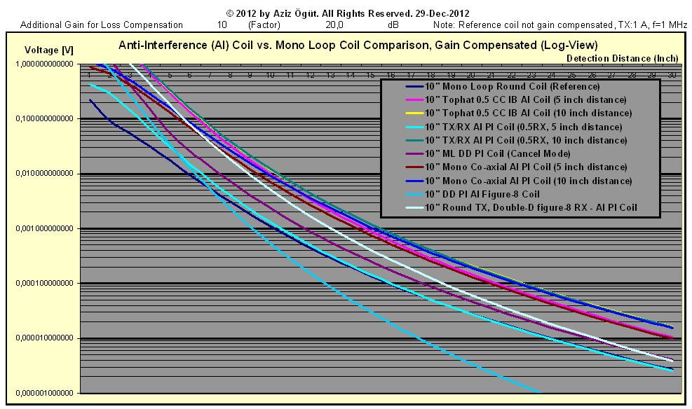

                              • Round TX, Double-D figure-8 RX, AI PI Coil Added
                                Hi all,
                                I am referring to the post #335 (6666's wish). This is a 10 inch round TX PI coil, having the RX+ and RX- as figure-8 double-d coil (not overlapped) sitting inside the TX coil, as big as possible (3-4 mm edge space to give the coil bundle some space to fit inside the TX coil). RX+ (RX- identical but opposite winding direction) windings turn increased to have the same level of EMI noise induction as the 300 µH 10" round coil (reference coil). So this coil is SNR compensated.
                                This is the comparison graph at additional gain of x10 (see 10" Round TX, Double-D figure-8 RX - AI PI Coil):

                                This is the performance relation to the reference coil (no additional gain):
                                Coil Comparison (Calculated Response Ratio to Reference Coil)
                                © 2012 by Aziz Ögüt. All Rights Reserved. 25-Jan-2013
                                Reference Coil: 300 µH Round Mono Loop Coil
                                Target Depth [inch] Target Depth [cm] Relation to Reference
                                1 2,5 2,694
                                2 5,1 2,744
                                3 7,6 1,905
                                4 10,2 1,357
                                5 12,7 1,032
                                6 15,2 0,827
                                7 17,8 0,691
                                8 20,3 0,590
                                9 22,9 0,518
                                10 25,4 0,459
                                11 27,9 0,414
                                12 30,5 0,377
                                13 33,0 0,345
                                14 35,6 0,319
                                15 38,1 0,297
                                16 40,6 0,277
                                17 43,2 0,260
                                18 45,7 0,245
                                19 48,3 0,231
                                20 50,8 0,220
                                21 53,3 0,209
                                22 55,9 0,199
                                23 58,4 0,190
                                24 61,0 0,182
                                25 63,5 0,175
                                26 66,0 0,168
                                27 68,6 0,161
                                28 71,1 0,155
                                29 73,7 0,150
                                30 76,2 0,145
                                Cheers,
