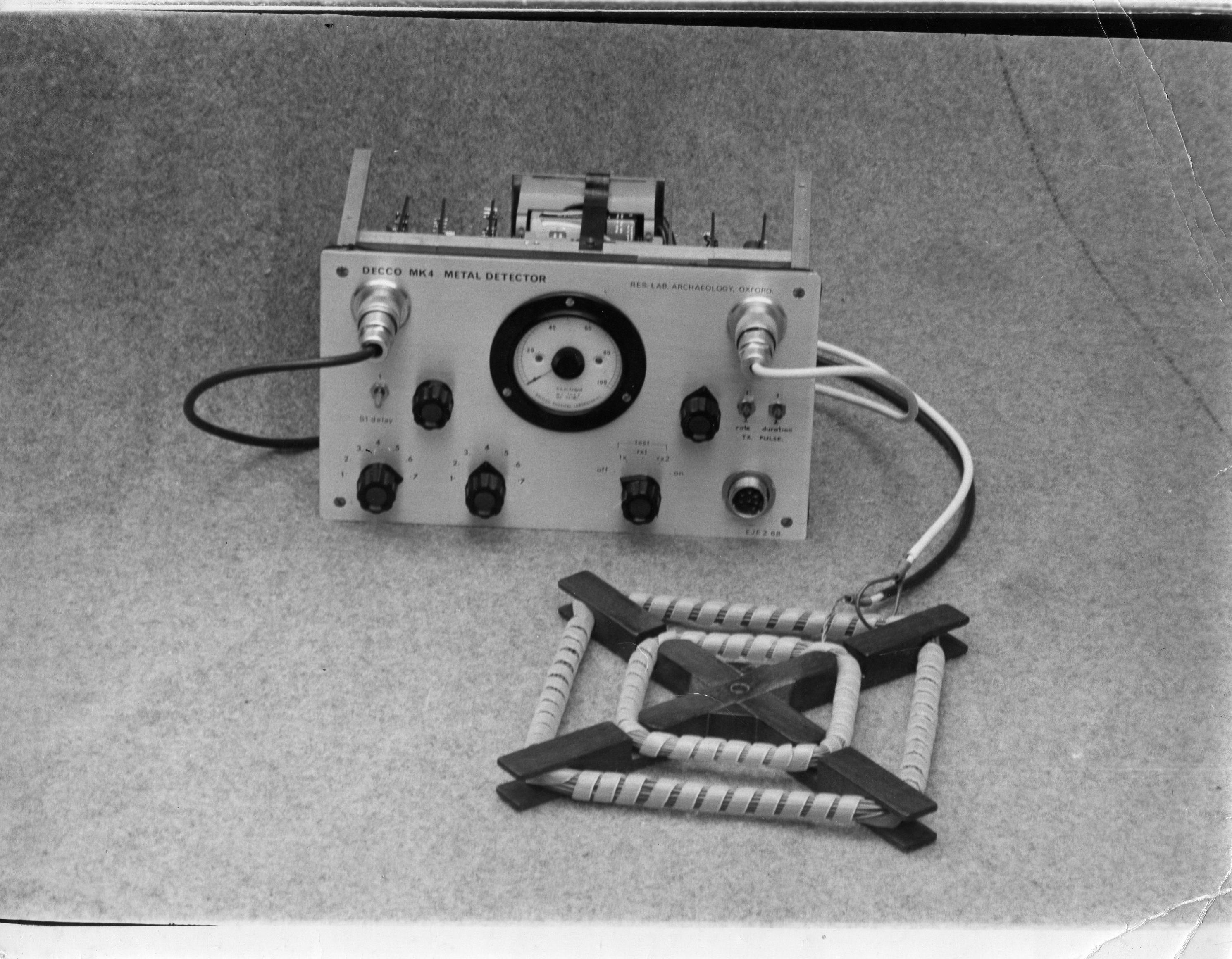

            My 1968 PI which used IC's/ RTL logic and 709, 712 Linear devices. DECCO stands for Decay of Eddy Currents in Conductive Objects. Coil array is a small one for lab testing. Field coil was 1m square for TX and 0.5m RX. My initials and date are in the bottom right hand corner. EJF 2 68.
            Eric.

              Interesting bit of MD history.
                The reason the the 1960's PI's had separate TX and RX coils was that it reduces the ground signal considerably, particularly from the very surface. These PI's were developed originally for surveying archaeological sites, not only for metal objects but for ground anomalies too. A strong ground anomaly could indicate the site of an old pottery kiln where the heat from firing had enhanced the viscosity response. Those detectors were not auto-zeroing and a measurement was taken with the coil array sitting on the ground that had previously been gridded out. A mono coil would have just given the response from the very surface, but a dual coil ignored the first few inches where anomalies can be smeared by ploughing etc.
