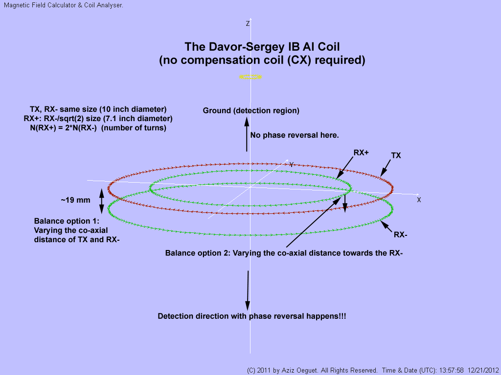

          • The Davor-Sergey AI IB Coil (without CX)
            Hi all,
            this coil configuration inductively balances by setting the RX- coil apart from the co-planar region slightly (~20 mm).
            I think, it won't disturb the coil architecture when it is slightly thicker due to coil arrangement. But it makes the coil design a bit simpler and easier to balance (two options - see below). The picture below is showing the RX+ radius factor of 1/sqrt(2) in an induction balanced state.
            The 0.5 radius factor is getting slightly thicker. The co-axial balance distance is almost an inch wide (actually 25 mm in my model). But it performs a bit better of course.
            I'll make the comparision for 0.71RX and 0.5RX and will add the compensation coil variant too (the CX coil part). If you see the CX naming, then you know, you need additionally the CX coil (which makes the coil more complex of course).
            Isn't that fine, that you don't need a CX coil?
            Cheers,
            Aziz
            • The Davor-Sergey AI IB Coil vs. Mono Coil
              This is the coil configuration above compared against a mono coil. I didn't make the coil configuration with the compensation coil (CX) and we can neglect it as it won't do much better. The following figures give you the performance comparision regards to mono coil and SNR. You can see, that the target response losses are significant at depth. But the EMI noise rejection should be good as the RX+ and RX- coils won't be much apart and you can ramp up the gain with a low noise amplifier to compesate for losses. Notice, this is an IB and AI coil.

                  Ok, let's modify the Davor-Sergey coil a bit to decrease the ground noise (magnetic viscosity effects etc.) and make it a bit thinner (co-axial thickness). That could be made, If we're going to make the RX- smaller (0.8 ) and RX+ accordingly 0.5RX- (0.4). Note: No compensation coil (CX) favoured.
                  Let's see, what comes out... and whether an IB condition can be made too..
                  Aziz
                  • Yes, I'm very curious about the outcome. In such configuration Rx coils would both be far apart from Tx so even the capacitive couplings will not make any influence - no Cx and all.
                      Unfortunately, the idea failed right now. The coil gets thicker (now 30 mm at least).
                      Compensation coil is required to make it thinner. I'll try more ideas ..
                      Aziz
