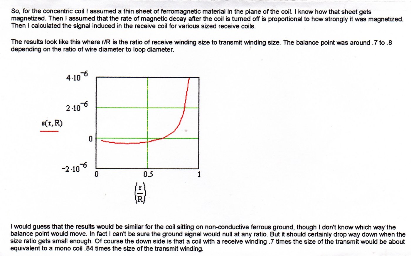

    Eric, do you referring to the concentric co-planar IB coil or
    the large TX, small separate RX PI coil (the ground loop coil principle)?
    Please specify your question(s) more precise.

    All these different coil configurations are getting confusing, but the type I was referring to is separate TX and coaxial coplanar RX without any balancing, or bucking. This type can be optimised better for both TX and RX functions and gives a certain amount of near surface ground decoupling over the mono. The ground loop is the same principle but with a Large TX (1 - 10m square laid on the ground), with a small movable RX (0.25 - 1m square or round). The operator searches within the TX loop, preferably using a grid of some sort. This gives very good ground decoupling but you have to avoid getting right up to the TX, otherwise the ground signal amplitude rises sharply. Ground loops are usually used where extreme depth is required on large objects, or scaled up even further for conductive ore body location. In my view, coaxial coplanar non IB (CCNIB if you like) should be kept as a separate type from ground loop, which is offset from coaxial most of the time.
    Eric.
    • Here is the result sheet.
        Eric.

            Hi Eric,
            Regarding your former question:
            The ground response will be reduced due to apparent (!) smaller and separate RX coil. However, we are thinking of making the smaller RX coil with more turns count (more inductivity) to get an equivalent EMI noise induction compared to the larger RX coil (the 10 inch 300 µH RX = mono PI coil as the reference). As a consequence of this, we have again more ground response near the RX coil region. BTW, we have an excellent pin-pointing and near distance detection sensitivity feature with it.
            Intuitively, I would have thought that the RX coil turns (inductance) would not matter at the zero point i.e 0.7 of the TX diameter. The -flux between the coils = +flux linking within the RX from a uniform thin sheet of magnetic surface.
            Eric.

                            Let's calculate the break-even gain point for a specific depth (30 inch) and coil:
                            10" Tophat 0.5 CC IB AI Coil (10 inch distance): 0.6
                            Break-even gain: 1/0.6 = 1.67 (4.5 dB)
                            We need 1.67 times more gain to be equally good as a mono coil with the high inductivity RX coils. If you can't make high inductivity RX coils, we would require more gain of course (take a low-noise amp!).
                            Let's assume, our reference mono coil would have 20 turns for 10" diameter. The equivalent 5" RX+/RX- would have 4 times turns count of 20, so 4*20 = 80. 80 turns count for RX+ and 80 turns count for RX- coil.
                            Let's assume, our EMI noise rejection ratio would be 20 dB (x10) for the 10 inch co-axial distance.
                            Beneficial gain margin: 10/1.67 = 5.99 (20 dB - 4.5 dB = 15.5 dB)
                            (That should give a few more inches or cm of detection depth - hopefully *LOL*)
                            We aren't taking amplifier noise into account of course. Just use ultra low-noise amplifiers and you can crank up the gain until the EMI noise or other noise sources limits us.
                            Cheers
                            Aziz
                            • TX/RX Anti-Interference PI Coil vs. Mono Loop Coil
                              This is the TX/RX (separate TX, RX) PI coil comparing against the mono coil. Note: This isn't an IB coil. It's a PI coil.
                              We have a 10 inch TX (300 µH), a smaller concentric co-planar RX+ coil and at 5 or 10 inch co-axial distance (above) a RX- coil for anti-interference feature. The radius factors for each smaller RX coils are either 0.71, 0.5 (half) or 0.33.
                              In the earlier post, there is the standard version of these coils (but not AI).
                              Coil Comparison (Calculated Response Ratio to Reference Coil)
                              © 2012 by Aziz Ögüt. All Rights Reserved. 20-Dec-2012
                              Reference Coil: 300 µH Round Mono Loop Coil
                              10" TX/RX AI PI Coil (0.71RX, 5 inch distance) 10" TX/RX AI PI Coil (0.71RX, 10 inch distance) 10" TX/RX AI PI Coil (0.5RX, 5 inch distance) 10" TX/RX AI PI Coil (0.5RX, 10 inch distance) 10" TX/RX AI PI Coil (0.33RX, 5 inch distance) 10" TX/RX AI PI Coil (0.33RX, 10 inch distance)
                              Target Depth [inch] Target Depth [cm] Relation to Reference Relation to Reference Relation to Reference Relation to Reference Relation to Reference Relation to Reference
                              1 2,5 2,285 2,588 6,339 6,724 17,300 17,744
                              2 5,1 2,004 2,247 4,351 4,644 8,251 8,578
                              3 7,6 1,688 1,902 2,969 3,219 4,464 4,737
                              4 10,2 1,431 1,634 2,165 2,396 2,848 3,095
                              5 12,7 1,240 1,440 1,693 1,915 2,056 2,291
                              6 15,2 1,099 1,300 1,398 1,617 1,615 1,846
                              7 17,8 0,993 1,196 1,201 1,421 1,342 1,572
                              8 20,3 0,910 1,117 1,062 1,283 1,159 1,389
                              9 22,9 0,844 1,055 0,958 1,182 1,029 1,260
                              10 25,4 0,789 1,004 0,877 1,104 0,931 1,163
                              11 27,9 0,742 0,960 0,812 1,041 0,854 1,088
                              12 30,5 0,702 0,923 0,759 0,989 0,791 1,027
                              13 33,0 0,667 0,890 0,714 0,946 0,740 0,976
                              14 35,6 0,636 0,861 0,675 0,908 0,696 0,933
                              15 38,1 0,608 0,834 0,641 0,874 0,658 0,895
                              16 40,6 0,583 0,809 0,611 0,844 0,625 0,862
                              17 43,2 0,560 0,787 0,584 0,817 0,596 0,832
                              18 45,7 0,539 0,766 0,559 0,792 0,570 0,806
                              19 48,3 0,519 0,746 0,537 0,769 0,546 0,781
                              20 50,8 0,501 0,728 0,517 0,748 0,525 0,758
                              21 53,3 0,485 0,710 0,499 0,729 0,505 0,737
                              22 55,9 0,469 0,694 0,482 0,710 0,487 0,718
                              23 58,4 0,455 0,678 0,466 0,693 0,471 0,700
                              24 61,0 0,441 0,663 0,451 0,676 0,455 0,682
                              25 63,5 0,428 0,649 0,437 0,661 0,441 0,666
                              26 66,0 0,416 0,635 0,424 0,646 0,428 0,651
                              27 68,6 0,405 0,622 0,412 0,632 0,415 0,636
                              28 71,1 0,394 0,609 0,401 0,619 0,403 0,622
                              29 73,7 0,384 0,597 0,390 0,606 0,392 0,609
                              30 76,2 0,374 0,586 0,380 0,594 0,382 0,597
                              Cheers,
                              Aziz
