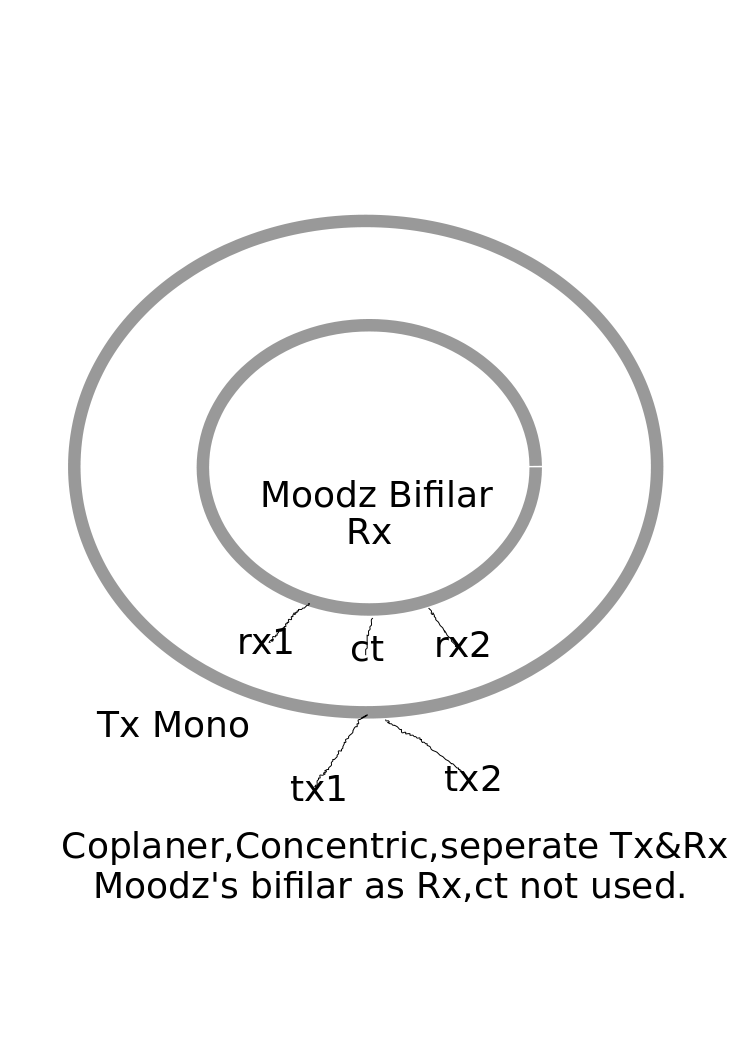

            • I have an idea,forgive me if this has been gone over already.I wound a moodz bifilar Balun coil and I plan to experiment with it. However I like the idea of separate TX and and Rx coils Like Eric posted where the rx is .7 the diam of tx. So the idea is to use the moodz coil as the Rx inside of the Tx. So I was reading on Tinkerers projects and see he is balancing his coil,with a third bucking coil. So I furthered my idea.We take standard mono for tx coil,and use moodz balun coil for the rx. Then we use the unbalanced side of moodz's balun coil tied to the Tx in rev polarity to act as our bucking coil adjusted with series resistance. Does this work? What do you guys think?
              • Ok so I just read the coil chapter of inside the metal detector,and Carl's Coil basics and it seems to me the moodz coil will be ballanced anyhow,unless there is a problem with twisted pair in that configuration. I'm also in need of education as to the mechanical placement of the coils and the benifit of moving the rx coils out of the same plane as the tx coil. The figure 8 seems to be a favorite,and its coplaner.I dont see how a coplaner concentric with 1/2rx+ and 1/2rx- is any different at all from the figure 8 coil.
                • Sometimes it's hard to envision a coil question without a drawing or a link to a prior post.
                    Ok I'll see if I can draw something up.
                      Ok here goes it
                      • IMHO coplanar solution will not get us any further depth-wise with PI or any other technology. It is already clear to me that the only way of reaching any deeper is by means of planar field, or at least less squashed than what we have with mono or coplanar. A 2box does it for IB while also maintaining induction balance, but the key is in a field being applied to the targets with less gradient depth wise than the planar coils provide.
