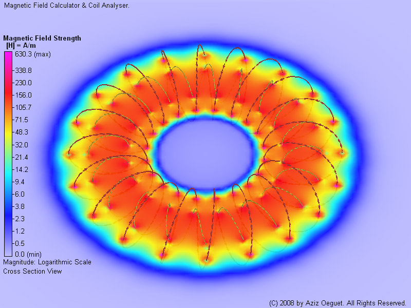

            • #66
              Avatar picture
              I've found my bigger avatar picture finally ... *LOL*
              Note, there is a smaller coil in it:
              I'm lazy to change it. I'll keep it.
              Aziz
