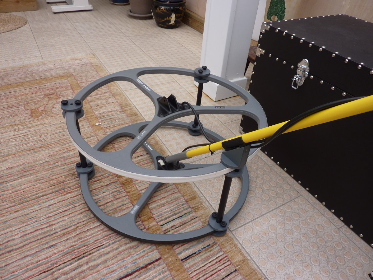

          Just a picture of my latest 25in noise cancelling coil arrangement. Bottom coil TX.RX1, top coil RX2. Quiet as a mouse, but if you are in an area with little emi, the top coil can be removed.
          Eric.

            Nice coils Eric. Thanks for sharing your coil picture.
            Aziz
