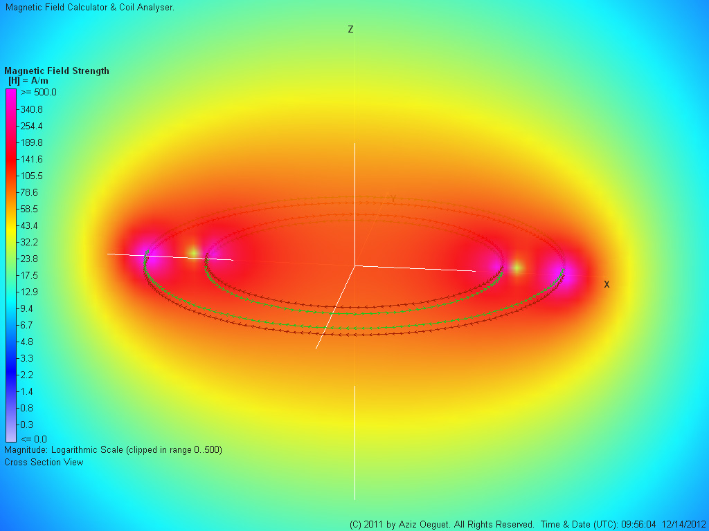

    I think I cracked the Davor-Sergey coil - solution is a Tx boosting coil. It would "homogenise" Tx field. So actually ppodg was right, only I did not think of the boosting variant at that time and I unjustly dismissed the idea.
    @Aziz, could you be bothered to run a test as in the example above with:
    RX+ N=50, RX- N=100
    TX: 300 µH at Rx+ radius, Tx boost 19 µH at Rx- radius, 1A coil current, f=10 kHz
    Perhaps it would be interesting to see Tx field as well
    That would work.
    I'll make some configurations.
    TX: 1 unit diameter
    RX+: 0.8..0.9 unit diameter
    RX-: RX+/sqrt(2) unit diameter
    BX: same as RX- but with minimal distance gap
    Aziz
    • #77
      Yes, a minimum gap between Tx-es and Rx-es would do for capacitance reasons. Guess 0.8 is far too much for 19uH boost.
      • #78
        Congratulations
        Congratulations guys,
        you finally have a fully concentric-coplanar anti-interference coil with compact coil size and a hole in the center region, if you want to look through it. Do you see the benefit of collaboration now?
        Rough induction balance can be achieved by varying the distance gap of RX+ to TX or RX- to CX (compensation coil). Notice, that the CX has the same current/winding direction as TX, so it doesn't counteract the TX coil. RX- being always the half flux surface area or 1/sqrt(2) times the size of RX+. Fiddling with additional single turn CX wire loop nearby the CX/RX- arrangement allows a fine balance tune.
        But you have to crank up the gain of the receiver. A substantial amount of target response will be cancelled by the RX- coil.
        If you take for instance 0.9*TX for the RX+ size (or smaller; RX-/CX accordingly smaller) you don't need much turns count for the CX coil. You can make the RX+, RX-/CX more smaller of course.
        I get an approx. turns count relation for the IB condition of 7/16 (CX/TX) for the full size RX+ coil. Or 29 µH / 233 µH, approx. of course as I calculate with simplified single turn coil models for speeding up the calculations.
        Don't forget: RX- 2x turns count of RX+ and opposite winding direction.
        Here is a cross-section view of the magnetic field strength (1 A, 300 µH TX/CX total):
        You can interchange the positions of RX+ and TX (accordingly: RX- and CX). So you don't need to make it exactly same as shown above.
        Cheers,
        Aziz

            Yes sure. It would be interesting to know, how this coil compares to a equivalent size concentric co-planar coil. So we can see the required additional receiver gain and see the depth performance comparison. I'll make a comparison, when I have more time.
            Cranking up the gain isn't a problem since we can use 1nV/sqrt(Hz) amplifiers. The only problem is the different RX specs as the anti-interference condition suffers a bit (different resistance of RX+/RX-, different parasitic capacitances, etc.) . But it shouldn't be as much critical as the AI feature would suffice I think.
            Cheers,
            Aziz

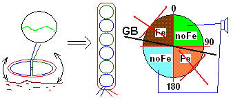

                    • #85
                      There is only one problem: ground compensation will never be perfect with nonidentical rx coils and will strongly depend upon the height above the ground ; DDO coil is much better, though its central phase reversal (or 'dip' if rectified) feature seems very unpleasant - but, after rectification, good for pinpointing.
                      • #86
                        http://www.md4u.ru/viewtopic.php?f=94&t=8150

                        • #87
                          For this very reason I'm about to make a 4 quadrant adapter. In the meantime it is good to know that there are some other possible solutions for 2 quadrant detectors as they are right now.
