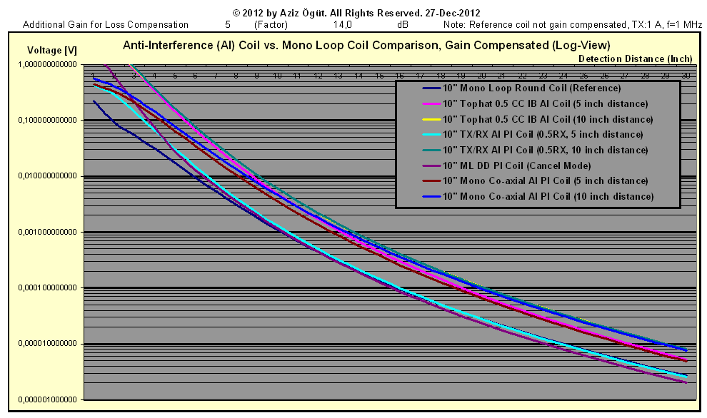

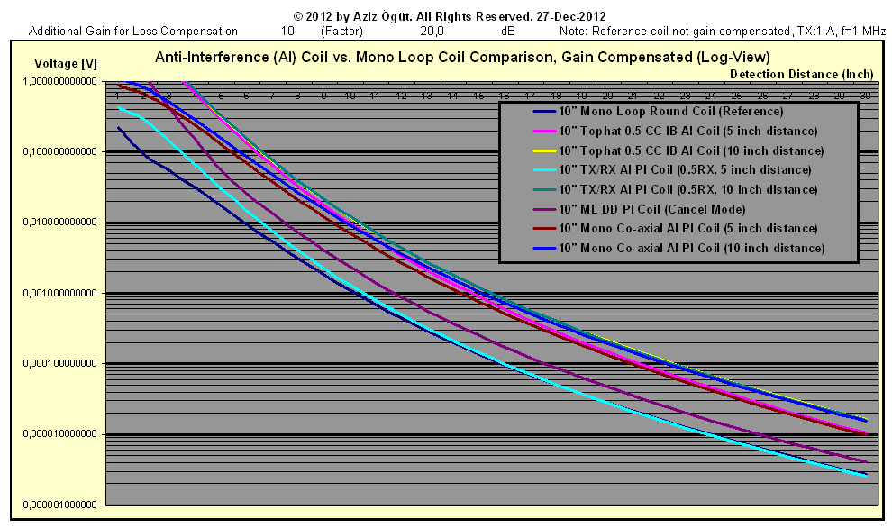

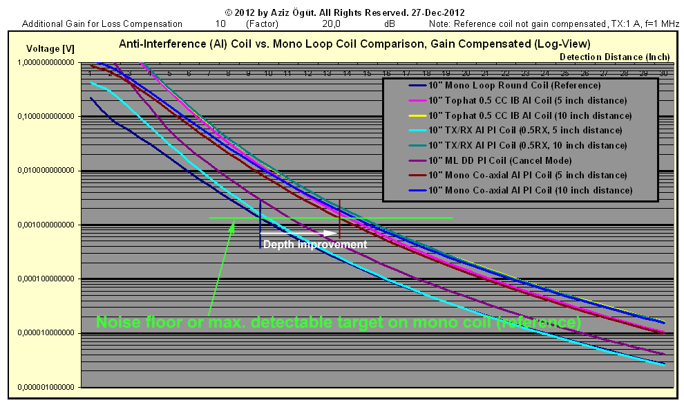

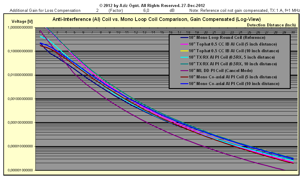

              • Detection Depth Improvement: Gain Compensated AI Coil Comparison vs. Mono Coil (Reference)
                Hi all,
                provided that, we can eliminate some EMI noise contribution due to anti-interference (AI) coil configuration and compensate for the target response losses with additional gain in the amplifier (due to less EMI noise), we can directly see the detection depth improvement for the specific coil configuration compared against our reference mono loop coil.
                You can see, that the detection depth improvement increases at low noise floor levels much more. That's the reason, why you should reduce the noise floor level using an ultra low noise amplifier. There is the real magic buried.
                I'll show you the comparison of selected AI coils and additional gain compensation vs. the mono coil.
                And this is how to read the detection depth improvement between the mono coil (reference) and the other coil:

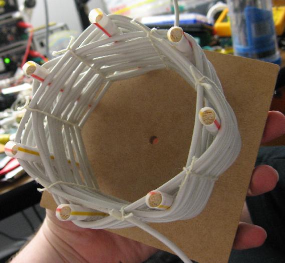

                    • Hi Aziz,
                      I played with coils a while back and came up with an anti interference coil of sorts,but i never really tested it fully and never had a dc ohm and inductance meter,but directly under power lines it was as quiet as a mouse and could detect nuggets
                      The coil bundle( cross section )was wound in clockwork fashion 12-2-4-6-8-10 0'c then alongside each one of those until all the gaps were filled so that the coil bundle was hollow and in a full circle
                      The current would flow around the outside of the coil bundle 3-4 times before exiting and the inductance comes from the induced inductance between each wire(damn thats hard to explain)
                      I don't know if your programme can handle that or if in fact you understand what i was trying to explain
                      I'll leave you's a while to try and take it in!!!...or not!!!
                      Ron
                      • Originally posted by authere View Post
                        Hi Aziz,
                        Ron
                        Hi Ron,
                        you surely mean the low capacitance coil weave technique (see examples below):
                        Yes, I can do such coil simulations as well. But they won't perform better than the mono coil. The inductance law remain the same of course. It's just a means of reducing the coil capacitance.
                        The benefit I see is, that the magnetic field strength is getting diluted over a wider region range due to a wider coil bundle, which is causing less disturbing ground magnetising effects.
                        Cheers,
                        Aziz

                                Hi Ron,
                                Cheers,
                                Aziz
                                Hi Aziz,
                                No, no,no, consider this, try thinking of using ribon wire where the wires are laid side by side, use this to wrap around the outside of a tube.
                                Then you should understand what i explained before
                                Ron
