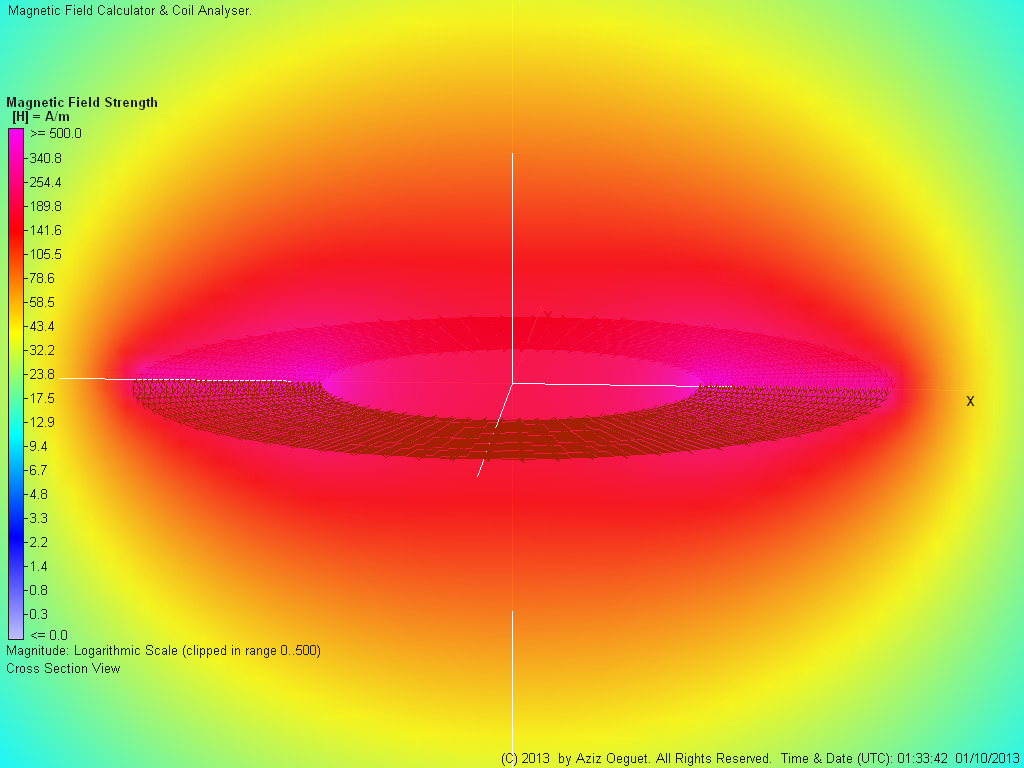

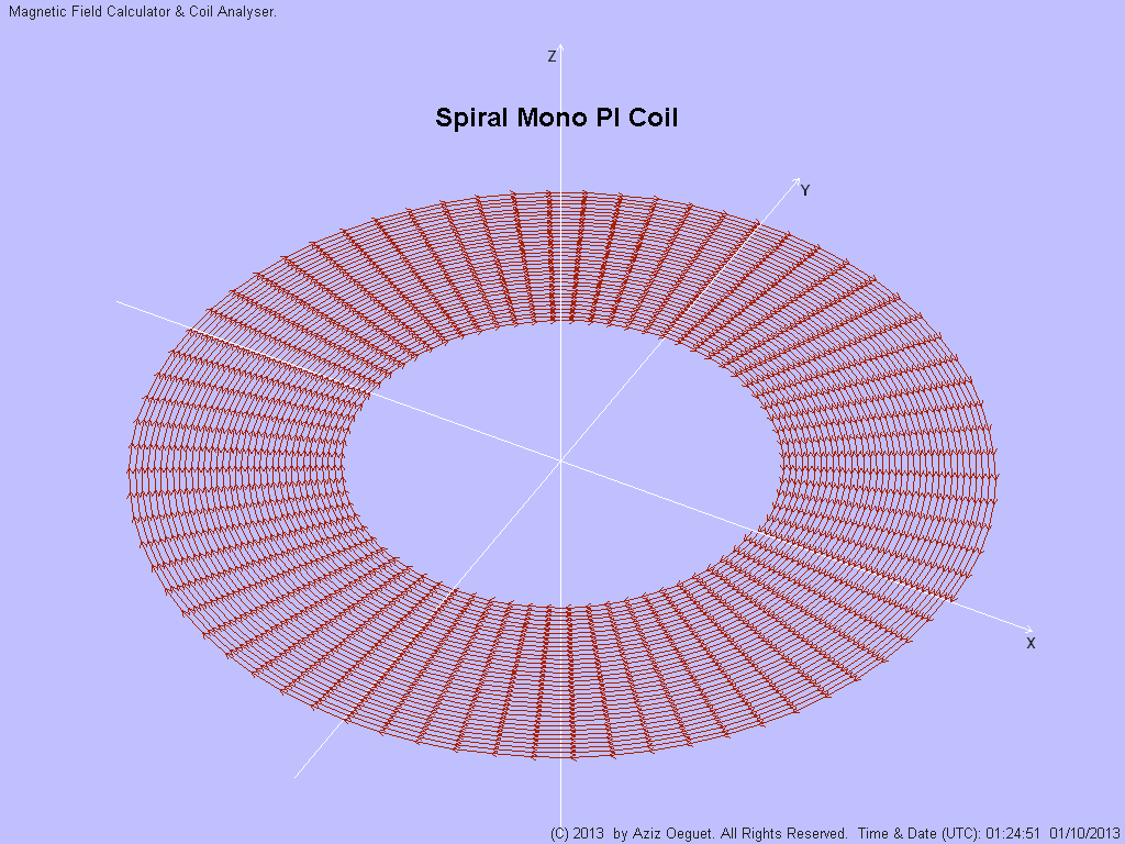

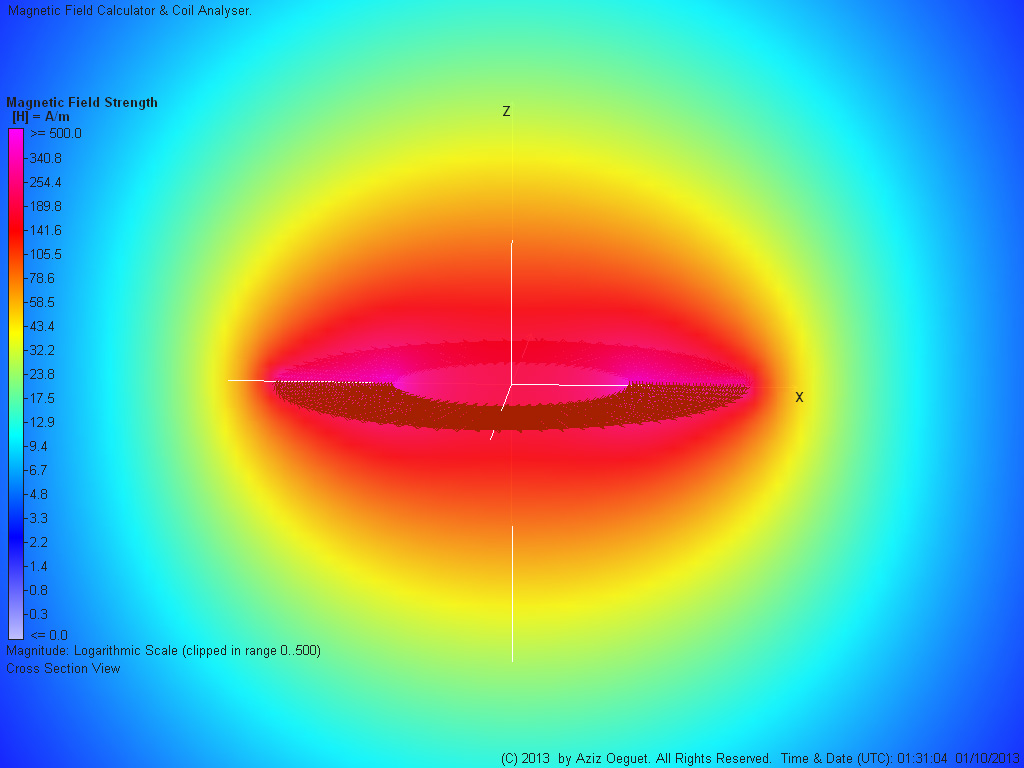

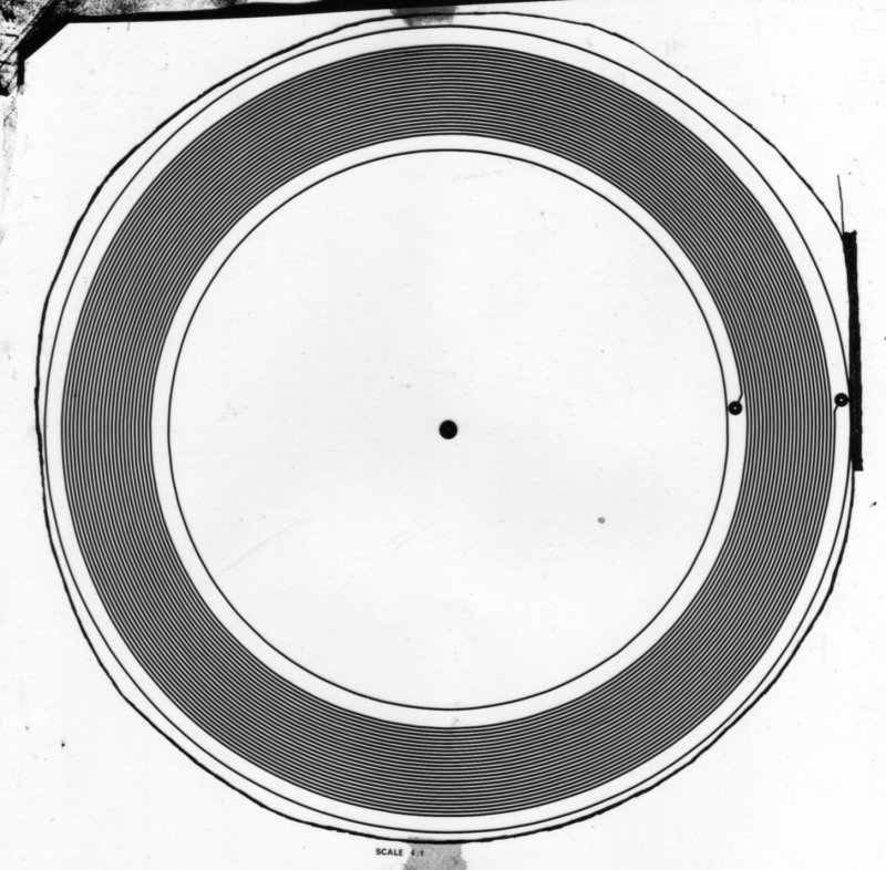

Fortunately, this spiral coil is prior art and nobody can lock it with evil patents anymore. Pity, but I didn't invent it. And it works pretty well and is even outperforming the mono coil. As I said before, never give it up!
How is that now?
Spiral coil:
Beginning from 0.5 unit diameter (=5 inch) and ending at 1.0 unit diameter (=10 inch). 35 loop turns (but I'm using internally in my coil software N=34.7).
Unfortunately, this flat spiral PI coil is picking up approx. 9.7% more EMI noise. So the total coil flux area is 9.7% more compared to the mono coil. On the other hand, it is performing exceptionally well. In the relation comparison below, the 9.7% more noise is divided out (by multiplying the relation by 0.912). So we see the SNR corrected relation and is a good comparison to the mono coil regards to SNR criteria.
Now look at this magic stuff.
I'm really impressed. There is a coil now, which is outperforming the mono coil with ease. One have to tame the shielding capacitance somehow.
Cheers,
Aziz
