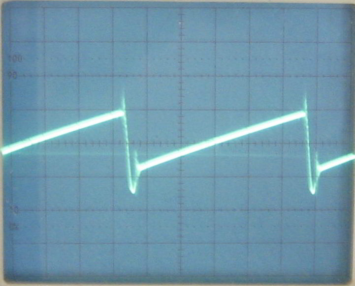

          A new, experimental coil design. The first "Power ON". What does it look like?
          Below is the picture of the coil current, measured across a 0.1 Ohm resistor in series with the coil. The scale is 200mV/div.
          We see a long ramp, about 100us and then a sharp drop of about 500mV. This amounts to about 5A current during about 5us or 1A/us di/dt.
          There is a little delay at the end of the drop, before the switch On. This mismatch in timing can be fixed by increasing the Flyback absorbing capacitor or by changing the timing. As it is, it will work.

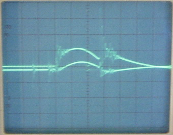

          Next, let's look at the signal coming from the RX coil. The setting is 500mV/div. We got a fairly large air signal, but there is no Flyback of several hundred volts.
          There are also some HF oscillations. This is due the fact that the damping resistor is still missing.
          The coil balance is not very good either. We will need to fix that.

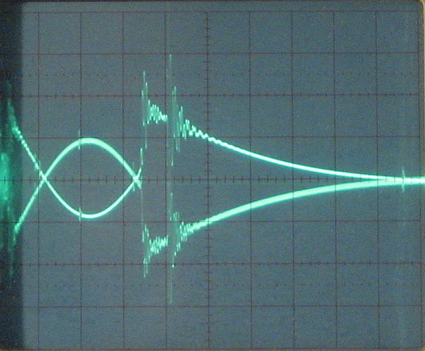

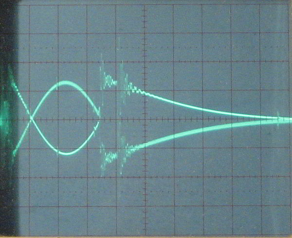

                  Now we want to see right away if we get a target response. We place a silver dollar at the center of the coil and see that the signal trace changed.
                  Remember, this is the signal on the cable coming from the RX coil, before the input filter.
                  First picture:signal with no target
                  Second picture: signal with silver coin at center of coil

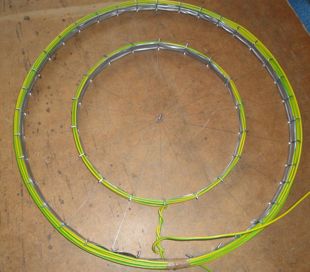

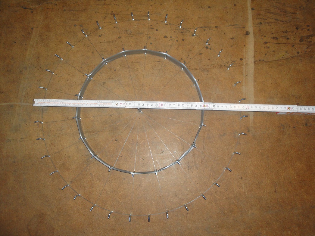

                    Now i´m starting to wind a coil for the tinkerers_SB. This is my "coilwireringtable".Click image for larger version
Name:	coil wireringtable.jpg
                    The coil-spect´s are from post 247 from here http://www.geotech1.com/forums/showt...project/page10
                    It is a 50 cm coil.

                      Excellent,
                      remember, as this is your first coil, there are many variables. The calculations are right, but the execution can induce many variables, like insulation thickness, tightness of bundle, final average diameter, actual type of wire etc.
                      Therefore do not glue the coil before testing.
                      The first test will show how good the balance is. Then correct the balance and only when the coil is perfectly balanced, solidify with glue.
                      Good luck

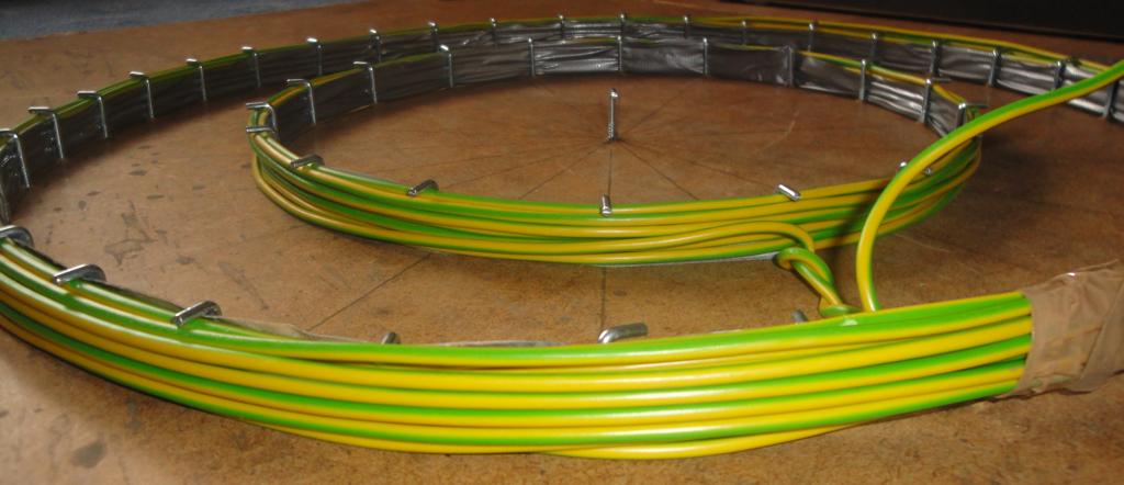

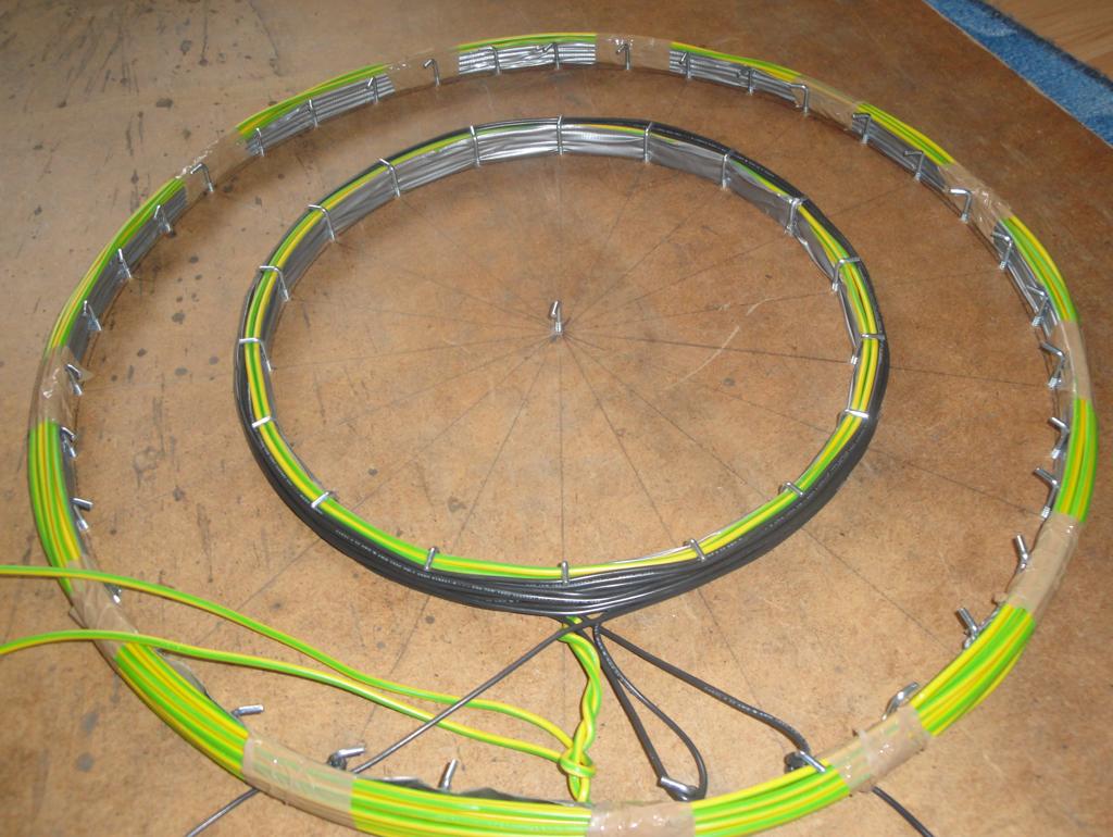

                        The coil is assembled.
                        These pictures are made with irfanview, thanks tinkerer for the link.
Name:	TX&BU coil1.jpg
                        Some questions i have:
                        My RX-coil is with 295 uH and 1,4 Ohm total(Start to End). Messured from center tap to start is 81uH and 0,8 Ohm and from center tap to end is 70uH and 0,8 Ohm. It should be 150 uH every side, or not?
                        TX is 398 uH and 0,5 Ohm total(with BU) and only TX (to BU-Controll) 419 uH and 0,4 Ohm. BU (to BU-Controll) is 39uH and 0,2 Ohm.
                        So i´m out of spect´s and have to wind a new one? Or can we use this?

                          No. You forgot mutual inductance. With different orientations it will either increase or decrease total inductance of the coils. In case orientation is the same it will be L1 + L2 + 2M
                          In case it is in opposite, it will decrease, L1 + L2 - 2M
                          So in case you have two coils of the same inductance, and their coupling is 1, the total inductance will be either twice their sum, or zero.
                          Your bigger problem is that your Rx coils are not equal. Most probably you did not wind them bifilarly. The best practice is to weave two wires together, wind them (together), and connect the ends to form a centre tap. That way you'll have perfectly coupled coil with perfect ratio viz. the centre tap.
                          In your case:
                          L1=70uH
                          L2=81uH
                          k=0.9562 (I got it by calculation and it is very good)
                          ____________________________________________
                          M= k * sqrt(L1*L2) = 72uH
                          L = L1 + L2 +2M = 295uH
                          L1 and L2 should be equal! Do them in bifilar fashion.
                            Nice coils! Neat winding.
                            If you did not make a mistake in the amount of turns, the difference in inductance is because the average diameter of one half of RX coil is different that the other half.
                            Bi-filar winding, like Davor says, helps avoiding this problem.
                            Before you rewind the RX coil, connect and observe the balance, as is. It will give you an indication as to any changes needed.
                            When you test, move the loose wires and observe the changes in the balance that this causes.
                            Tinkerer
                              Thank´s for the tip´s and explanations tinkerer and davor. I have about 0,5-1m cable on each side left, to correct some fault´s or use it as coil connection cable. If i wind an extra turn for the weaker RX-side then it could fit. Perhaps I have miscounted the windings.
                                I have add one winding on the weaker RX-side. Now i have 81uH from rx-start to center tap and 84uH from center tap to rx-end. RX-total is 322uH now.
