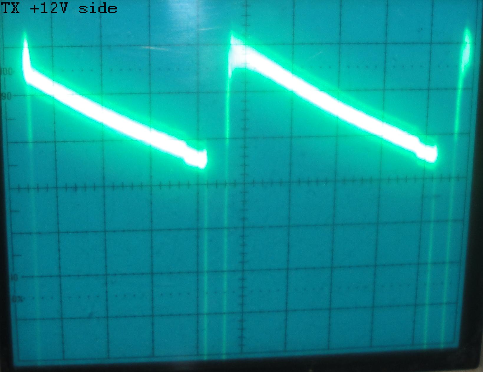

    After crashing one pic i get the TX board with coil working.

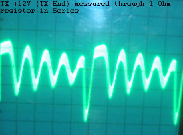

    I have used the scope with 5V/Div and 20uS/Div. I didn´t connect ground, therefor the lines are not so clear.
    I didn´t use a 0,1 Ohm resistor in series, because i don´t have one.
    Here are some pictures:
Name:	tx +12v side.jpg
    messured on TX-End (after BU) without BU-Control connected

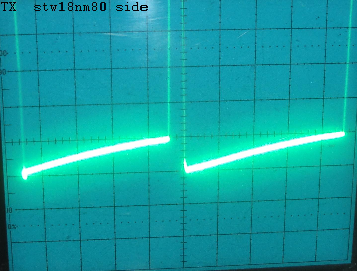

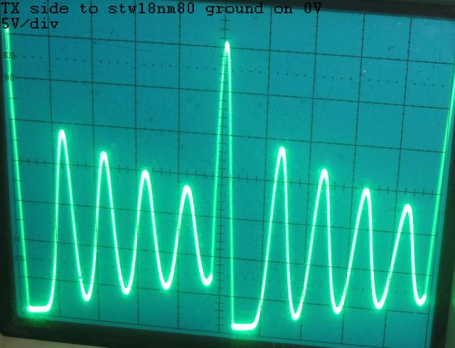

Name:	tx stw18nm80 side.jpg
    messured on TX-Start without BU-Control connected
    It looks like the pictures from you tinkerer, but i have 5V/Div and not 200mV/Div. Is this OK?
    Where you have connect ground from scope?

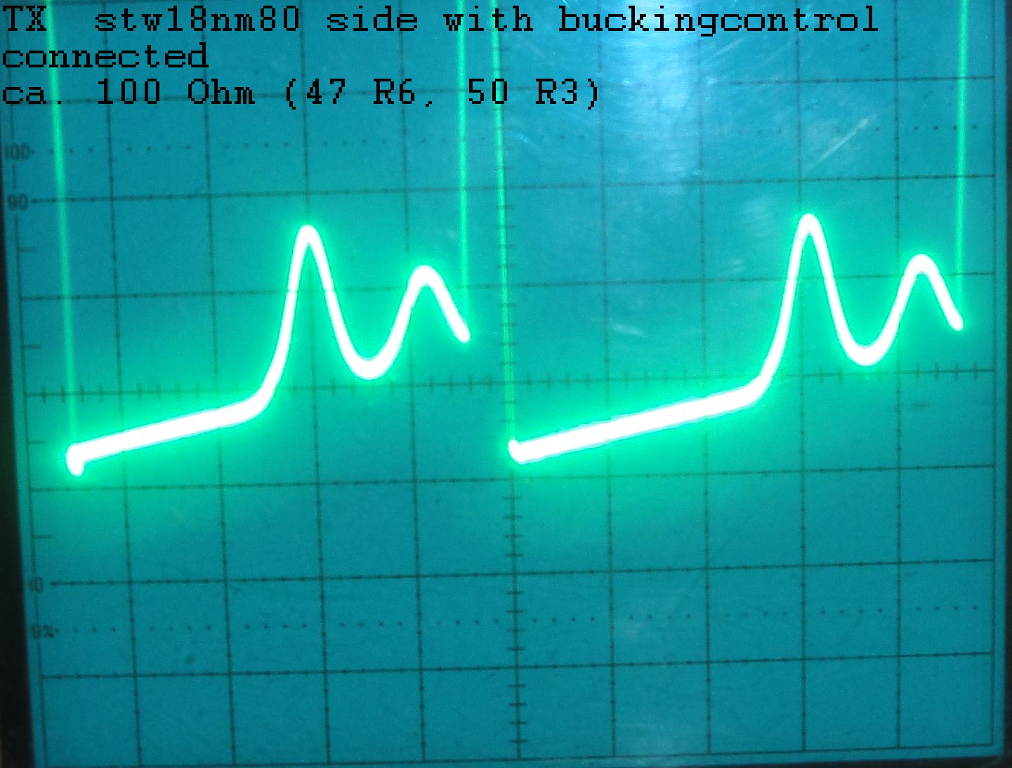

Name:	tx stw18nm80 side with bu.jpg
    messured on TX-Start but with BU-Controll connected.

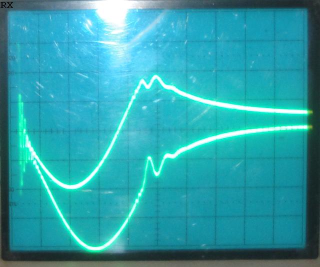

      Today TX looks always similar to picture 3. No changing if BU-controll is connected or not.

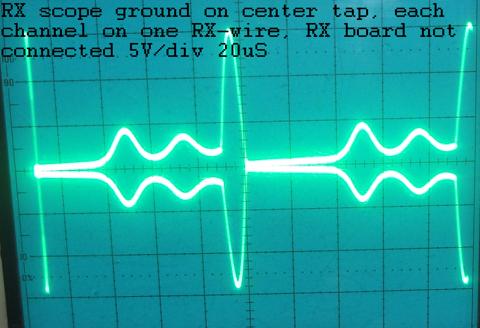

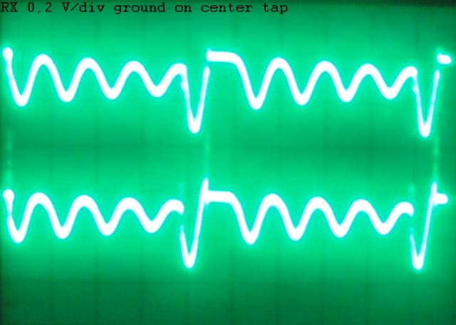

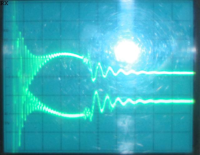

      One picture from RX, only connected scope on coilcable without RX-Board
Name:	RX without RX-board.jpg
        The BU control is only for fine adjustment.
        Your balance of the coils is not good. Do not worry, it just needs adjustment.
        Are your coils still on the nail board?
        Remove the nails and tie the RX-BU at a few places. You will see some change in the wave form.
        Then lift the RX-BU slightly on one side, while keeping the position centered.
        If the voltage increases, this means that the BU is not enough.
        If the voltage decreases, there is too much BU.
        Why is it not correct?
        The calculation does not take into account the difference in the inductance and surface area caused by thick or thin insulation of the wire. Also the mean diameter of the coils changes due to the insulation thickness and the tightness of the bundle tying.
        You will notice that if you lift the RX-BU off the nails and then tie them tightly, they will not fit on the nails anymore.
        These changes affect the balance. It is not a problem, it just needs to be adjusted.
        There is one further mistake that often happens. The TX coil and BU coils need to be wound in opposite direction, or we could say, the current needs to run in opposite direction. If this is wrong, the Voltage on the RX will be very high. In this case just flip the RX-BU and you see how the voltage diminishes dramatically.
        You don't have a 0.1 Ohm resistor. You can use 1 Ohm. You connect the scope ground on one side of the resistor and the probe on the other end. Careful, do not cause a short between the 2 ground clips of the scope. Disconnect the other probes from the scope when taking this measurement.
        The purpose of looking at the coil current, is to see if the timing is perfect. Why would the timing not be perfect?
        the TX coil and the Flyback capacitor form a resonant tank. Due to the tolerances of the capacitors (5%? 10%? 20%? and the inductance of the TX coil, the frequency will be different.
        If it is off too much, we can adjust either the timing of the capacitance to make it perfect.

          i´m to stupid to balance the coil. Can you make for me a step by step instruction with information where i have to connect the scope (ground and probe) to make my pictures? they don´t look similar to your´s.
          On the last pictures the BU+RX coil was flipover. My son must have touch it.
          So i have made new one but now the RX-curves are not opposite. TX look´s wrong too.
          The coil is placed on Plastic-boxes 1 m above the floor. The only metall in the near is the coilcable. It lays on the tx windingand hang down.
          Should i rewind the coil and make a new one?

Name:	tx +12v through resistor 1ohm.jpg

            Or could it be the stw18nm80? On Pin 1 i see the TX-Pulse from the pic with 5V. On Pin2 this pulse is only 0,3V. And the stw don´t go hot although it going hot the first few times. Maybe i have destroyed it. But then i have to order a new one.

              Post 34, the picture shows a problem with the TX.
              The problem could be with the Mosfet drive or the Flyback capacitors.
              The Mosfet should never get hot. If it gets hot, this indicates that there is a problem.
              What is the working voltage of your Flyback capacitors? Are they OK?
              A common mistake is to connect the TX - BU - BU control terminals the wrong way. The 47 Ohm resistor or the pot on the BU control will then burn out.
              - check the pulse voltage on the Mosfet driver input.
              - check the pulse voltage on the gate pin of the Mosfet.

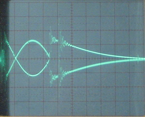

                            Now my TX is working. I have testing the RX and after setting the BU-Controll i get a signal on one point for silver and no signal for iron. This is good. But my scope show´s other curves then your´s tinkerer. How can i balance the RX so that the curves go opposite each other, similar to your pic?
                            My scope is set at 0,5V/div and 2us.
Name:	RX 0,5V div 2us.jpg
                            Tinkerer´s picture
